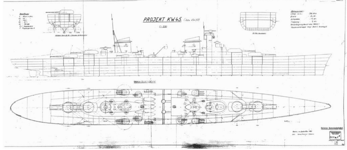

Another interesting one I found:
Projekt KW45 Displacement: 45,000 tons Length: 984’ Width: 111’ Speed: 36-37 knots Armament: 8-15”/47 (4x2), 12-5.9”/55 (4x3), 8-4.1” (4x2) and 8-21” TT Armor: 8"

Prokjet KW50 is basically the same as KW45 but with Displacement: 50,000 tons Width: 121' Speed: 35 knots Armor: 11.8"

Well,You're even looking for the wrong thing, this is Weimar Germany's 1928 cruiser killer , has nothing about KW45

That looks like an evolution of the 1928 "Zenker" battlecruiser, which never got off the drawing board. It is also quite well known.

IIRC, these two were designed by a private shipyard rather than the Warship Construction Office (K-Amt), and were never seriously considered for construction.
They are notable for their 5-shaft propulsion system.

That's still Admiral Schröder. Check https://alnavco.com/content/modeling_historic_notes/pdfs/alnavco_the_fleet_that_never_was.pdf for Projeckt KW45 it's there.
Here is an excerpt from page 56: "More intriguing were projects KW45 and KW50 designed between June and September 1939. These plans were found by Capt (Ret) Ken Johnson and placed in the National Archives. Reports issued by the Director of Naval Intelligence on 8/29/45 contained capture documentation of submarines, cruisers, destroyers, battleships and carriers. Discussed by the “Neubauausschuss” during the 1939 time period, no other previous or subsequent mention of these ships have been found in the German archives. Immense, fast, under-armed and under-armored battlecruisers had advanced designs completed but were never approved. These would have suffered from the same design defects as the OPQs but remain intriguing ships."

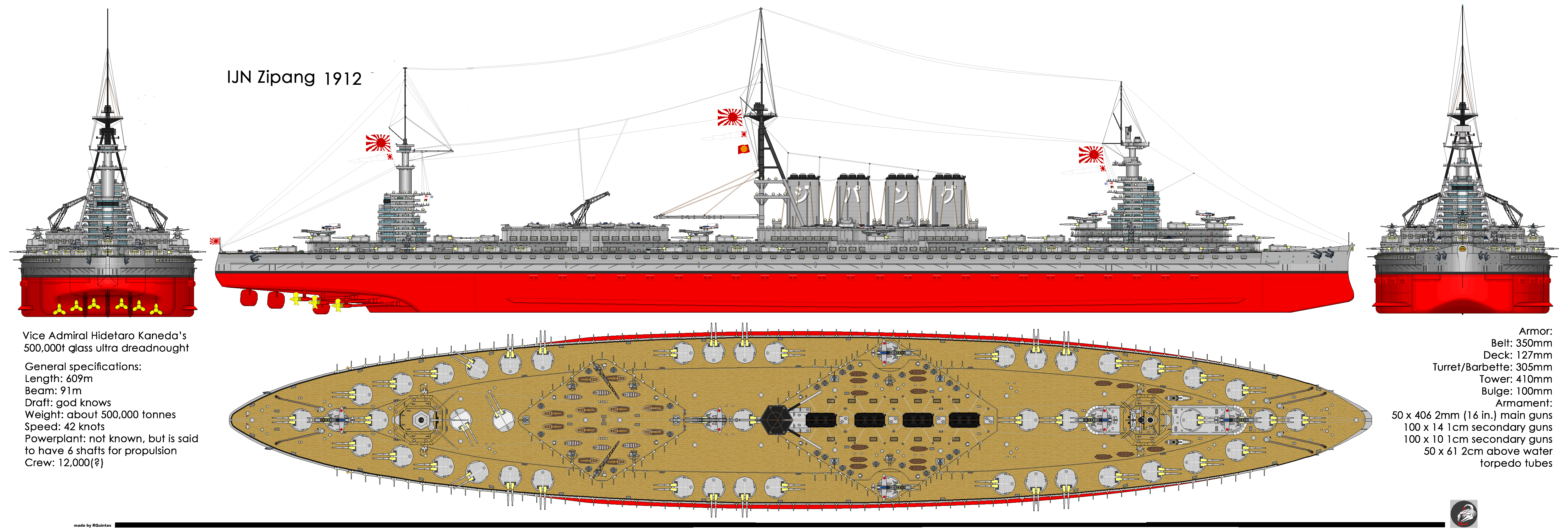

Well, we can always go full lunatic here:
Nothing quite like Japanese OCD to make things interesting!
With a turning radius measures in leagues, a cruising range measures in meters, requiring the entire fleet's personnel.
Large ships had large fuel supply so plenty of range. As for the turn rate why turn fast when you have 100 16" barrels on each side? Against torpedoes only bulkheads and compemantation helps but to sink such a large ships a ton of torpedoes are needed. See Yamato and Musashi.
Well, that Japanese mega ship has some serious design flaws that weren't really known fully in 1912-ish when it was proposed. These include:
Use of casemate guns in the hull, or what I assume are casemate guns in the hull (slots in hull sides). These lower freeboard in the case of flooding and as history proved, were worthless as ranges increased. They also often couldn't be used in a seaway.
Wing turrets. These are close to the outer hull meaning there's little depth to whatever torpedo defense system that might be installed.
Given the location of the engines and boiler rooms, the shafts on this ship are going to be very long making them torque limited, but worse, giving very long shaft alleys that could be a weak spot for progressive flooding.
Not sure if coal or oil firing was planned. If coal, complete nightmare and a huge risk of coal fires due simply to the mass of coal that would have to be carried.
With a proposed crew of 12,000, fitting all of them aboard and keeping them fed etc., is going to be a Herculean task.
The most ludicrous thing is the proposed speed is 42 knots! Yea, I think somebody's finger slipped on the typewriter there and they meant 12 knots.

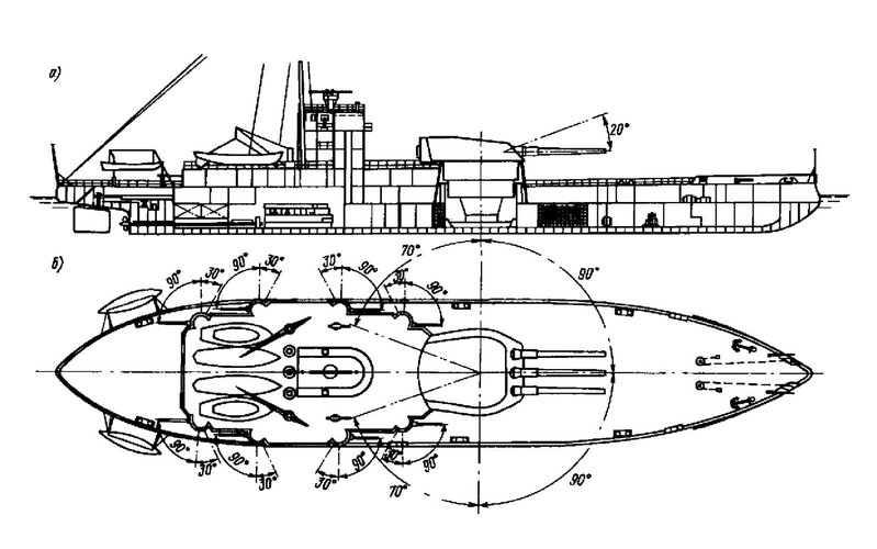

Russian project of pre-dreanouth armoured ship, engineer Achenbach (Russian German?), 1905: NVi7uiUMF2k.jpg
10 000 ton, 15 knots, 2 x 2 and 4 x 1 x 12" guns.

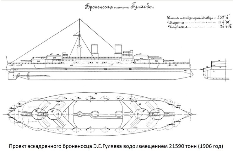

Gulyaev 1906 "all-big-guns", with big underwater protection, 21 590 ton, 4 x 2 x 12" guns:

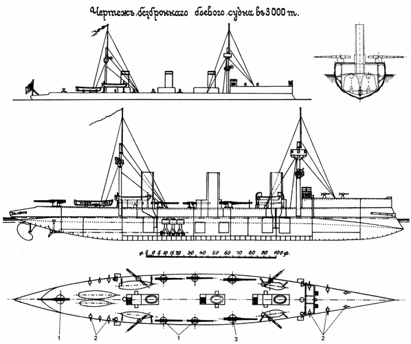

Admiral Makarov "unarmoured ship", 1895 (?):
3000 ton, 2 x 8 ", 4 x 6 " and 12 x 75 mm guns, 20 knots, range 6000 miles

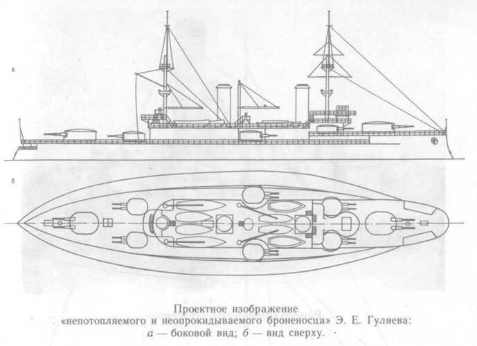

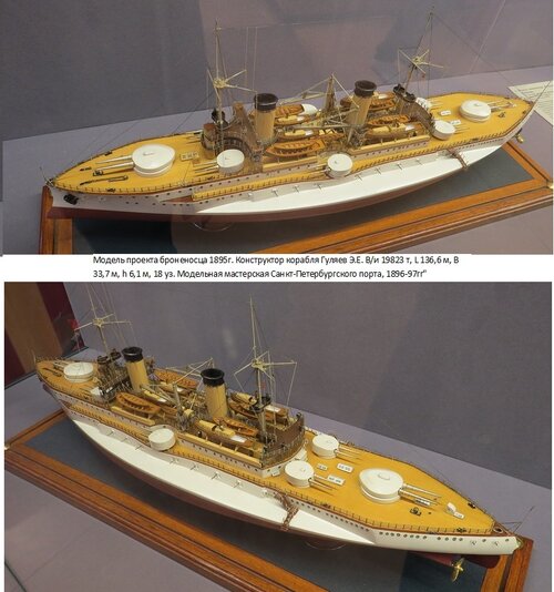

Gulyaev 1895 "unsinkable" armour vessel:
19 823 ton, 136.6 x 33.7 x 6.1 m, 18 knots, 2 x 2 x 12" guns and 6 x 2 x 6" (?) guns.

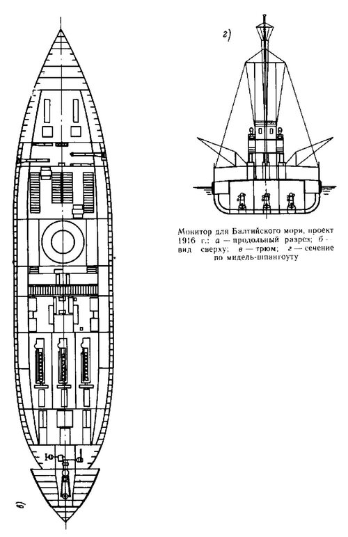

Baltic sea monitor project, 1915-1916:
7550 ton, 12 knots, 1 x 3 x 14" and 8 x 6" guns, 3 x 1000 hp diesel engines, 275 mm belt
