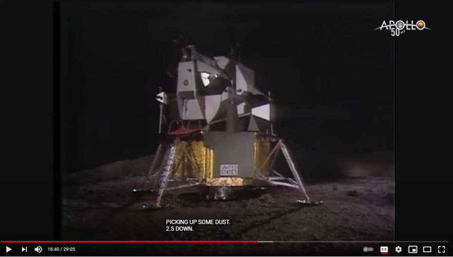

You can hear Buzz Aldrin saying "Picking some dust"

No wonder I had no idea what you were talking about - Aldrin actually said "*kicking* (NOT picking) some dust", see for example the transcript at https://www.vaticanobservatory.org/sacred-space-astronomy/kicking-dust-apollo-11-memories-part-1/! Aldrin's remark seemed however more like an observation than a concern, and obviously they made it safely down to the surface after all through that dust storm :).
I concur that at least your video is oblique - for whatever reason it is heavily censored, see my screengrab below. It cuts the description as well as the diagram off right were it looks to become interesting, so would you mind adding a plain text description of your concept (and the full screen video as well, for that matter)?
I have to admit that It's too hard for me to tell with certitude what Aldrin said. Here is a screen grab of the footage discussed above.

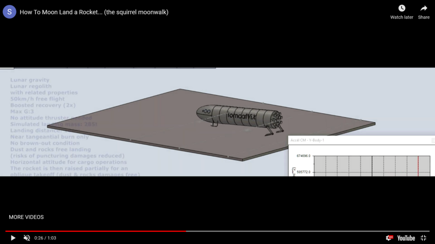

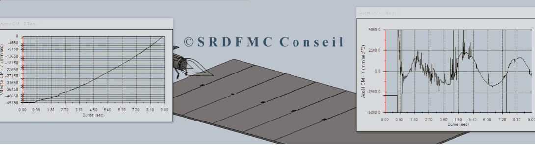

Data are proprietary but the acceleration curve tells the viewer that there is nothing spiking above 5g (unit is cumbersome)
A descriptive text can be accessed by clicking on "Show more":
Lunar gravity and atmosphere
Lunar regolith with related properties
50km/h approach speed - STOL glide slope
Boosted recovery (2x burn with variable boost setup simulated)
Max impact load on structure: 3g
No attitude thruster needed
Simulated landing mass: 285t (metric)
Landing distance: 100m
Near tangential burn only
No brown-out condition
Dust and rocks free landing (risks of puncturing damages reduced)
Horizontal attitude for cargo operations
The rocket is then raised partially for an oblique takeoff (dust & rocks damages free)
Earth STOL is possible with only partial lift (ex. 70% results in a 300m landing on sand)

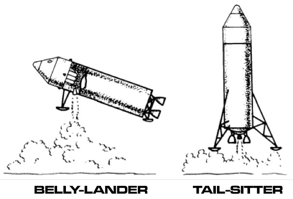

It's not easy but I did point out Kraft Ehricke's concept for the "Slide Out" lunar lander :)
And NASA looked at that for the Apollo program, not that it doesn't "work" it's that it's far from easy or really something you want to do on a regular basis. There have been a number of "horizontal" landers for the Moon and Mars, (been looking into Boeing's "not-a-Starbug" lander concept recently :) ) as it brings the crew and cargo closer to the surface and makes ingress and egress vastly easier. The biggest issue is the designs don't really lend themselves to single payload launches on 'conventional' boosters as well as a vertical, in-line design.

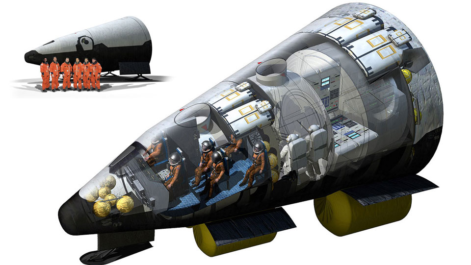

You might even have something like this as a shelter
This concept I have been trying to find for years:
This project ever have a name?

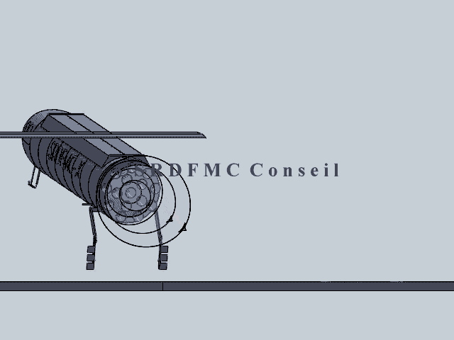

In anyway, however, the idea here is different. We are here in the terminal phase of the landing after the vehicle has been slowed down and is guided for terminal touchdown (remember Apollo video when the LEM begin the final approach gliding down the surface before landing vertically).
The goal of the Squirrel Moonwalk is to allow a massive rocket (285 metric tons) to land in a short distance (100m) without blasting half the moon surface back into orbit (no brownout condition) with its inherent hazard of damages from puncturation, offer a better way to handle cargo operations (the lean down attitude at rest), minimize fuel consumption and offer a similar rock blast free takeoff.
As I noted they looked at this for Apollo since the original plan was for Direct Ascent so that the lander would be a LOT taller than what we got.
See:
And
The idea is still around with things like the United Launch Alliance's Dual Thrust Axis Lander (DTAL), or the NAR Horizontal Lander concept up to the more recent EAGLE, (European Advanced Gear for Lunar Exploration) which is a favorite of mine :)
Not really a 'project' but an idea for a biconic CEV concept that made the rounds. Blue Origins biconic capsule concept was close to this design.

The main advantages of this kind of landing stand in being non-dependent of landing site infrastructures for cargo handling operations and generating a dust and debris safe zone for the landing vehicle while offering short field landing characteristics (land nearly anywhere).
It's mainly something in line with ASC Rocket cargo AFRL program.
Forgot to say, Gif image above is for a landing boost of 2.6MN for a 300t landing vehicle!
Boost time is less than 10s.
Max deceleration load is 2.5G (can be reduced with a longer landing roll).

Graph added (Speed [mm/s] and vertical acceleration [mm/s²]):
landing speed 100mph, slope angle 5°, Landing distance 200m, Surface material: sand, Span 55m, Cl 3.0 (landing configuration)
