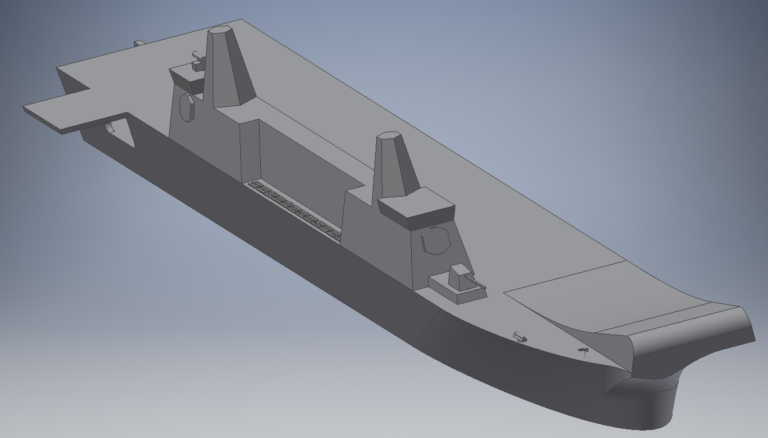

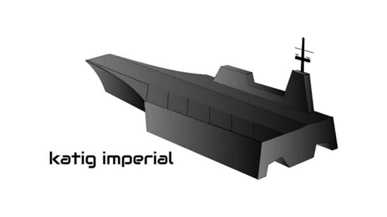

Are stealth aircraft carriers a possibility ?
Maybe? First, you'd need to do something weird for the hull shaping. Slapping an island shaped like the Zumwalt deckhouse is trivial. Then you have all the aircraft on deck in very unstealthy condition, and all the people and tugs running around, all equally non-stealthy.
Even if you could reduce the RCS of a carrier to the size of a B-2, now there's a carrier sized hole in the reflections from the water and that huge wake a quarter million horsepower makes in the water.
