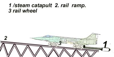

my zero flight concept with a rail pad where the plane will be on iron wheels that will be separated during the flight something like me-163 comet
What is the advantage over ZELL?
A launch with less G benefits the efficiency of the pilot during the mission.
The rocket's infrared signal can help the enemy locate the launch site, and even confuse it with the tactical nuke launch.
Cheaper version than the expensive rocket no smoke and a large amount of heat when launched .While above the ramp can build a well-fortified hangar from the impact of cluster munitions or air cannon grenades
Neither seems particularly compelling.
First, ZELL testing showed that G-forces had no adverse effects on the pilots at all.
Second, I have to reiterate: ZELL was never intended for routine tactical warfare or alternate war-fighting scenarios. In the doomsday scenario for which it was intended, no one would be watching for IR signatures or worrying about tactical nuclear launches. It WOULD be a tactical (or de facto strategic) nuclear launch carried out under attack in a matter designed to frustrate enemy attempts at preventing it. If the enemy did locate the launch site after launch, so what? The bomber and its weapon would not be there and would not be coming back. The expense of a rocket hardly mattered under these conditions.
ZELL launches were successfully carried out from bunkers. But the point of the hardstand was that no bunker, rails, or other complex infrastructure was needed. The infrastructure required--the launch stand--was little more complicated than a concrete parking space: easy to construct, with a vanishingly small foot print and little or nothing to see from the air, and easily camouflaged. The only necessary equipment was an ordinary and ubiquitous air force truck with a crane.
The Luftwaffe did consider using the catapult from the Marine Corps Short Airfield for Tactical Support (SATS) as an alternative to ZELL. The SATS arrestor gear was already considered the best bet for providing alternative landing strips for returning ZELL bombers. But it was simply more complicated and costly than ZELL and required too much real estate and lead time for the doomsday mission. While SATS offered greater flexibility (Marine F-4s used it in Vietnam), flexibility was not what the doomsday plan was about.

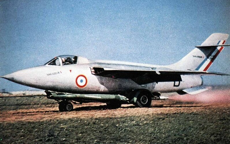

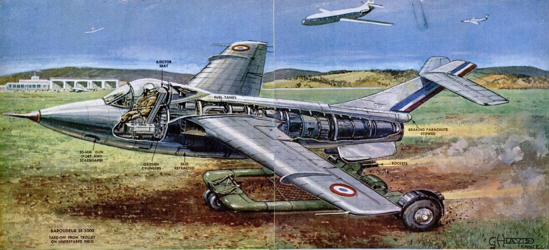

SNCASE Baroudeur this is an interesting concept for cheap form of STOL aircraft. Something like me163 comet aircraft that can take off from any meadow.View attachment 662646View attachment 662647View attachment 662649
Skids were a non-V/STOL approach to rough-field operations. The Baroudeur concept worked as designed, providing take off and landing from plowed fields and such with light, close-support weapons loads. But, as with the Me163, the take-off trolley and limited maneuverability on the ground had at least the potential for limiting sortie rates and increasing vulnerability to counter-air attack.

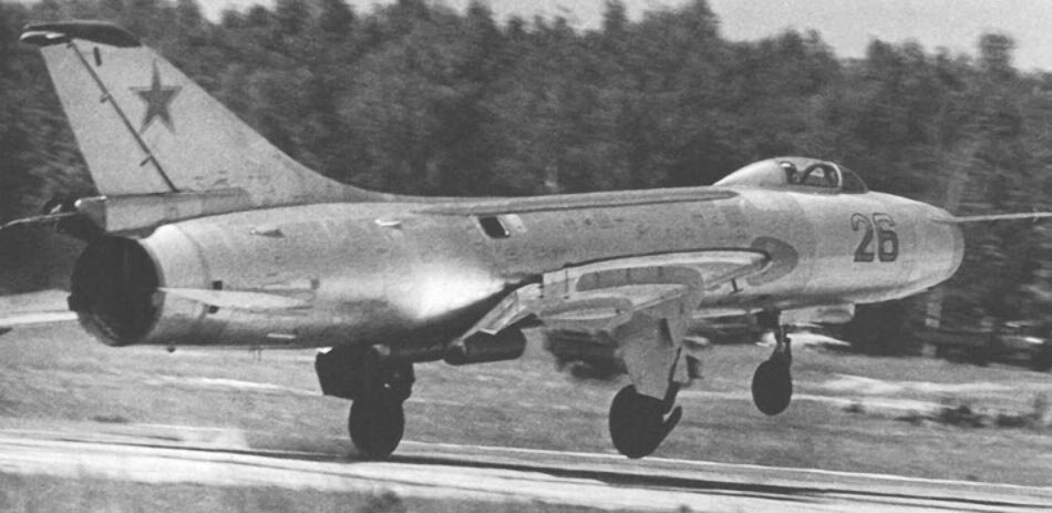

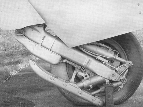

The Soviets experimented with pure skid undercarriages on the Su-7 before settling on a more or less successful, wheel-skid hybrid arrangement for the Su-7BKL. The skids improved flotation on soft surfaces, in mud, and on snow, while the wheels retained the ability to taxi and operate from hard surfaces. Combined with RATO gear, it seems to have made rough field operations with large fast jets possible, if not altogether practical. The idea wasn't pursued on later aircraft types. So I assume that its advantages did not justify the extra cost and complexity. For one thing, you still had all the logistical issues that beset other austere-basing schemes (providing munitions and fuel supplies, maintenance facilities, accommodations, etc.).

However, Bariudeur it can take off from any meadow and close to the front and that is the goal. For example, in 1995, 6J-21 Jasterb planes took off from the Republic of Serbian Kraijna the aim was to bomb factory in Novi Travnik in Bosna.
All 5J-21s were shot down by US F-15s. what if the j-21 had the opportunity to take off from a makeshift airport just 10km from the factory as it could do Bariudeur /
