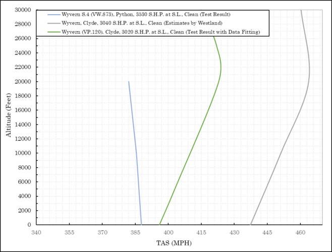

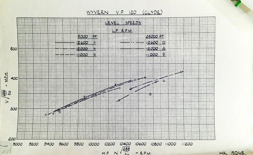

After another visit to the National Archives, I finally found something really interesting about the performance of the lovely Wyvern VP.120:
It achieved 422 mph at 25,000 ft and 402 mph at 5,000 ft during the test.

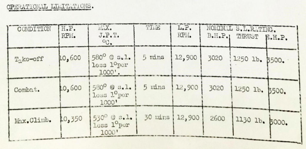

Based on the information regarding the specific engine the aircraft used during the test flight (Clyde No.10), the engine output at sea level should be around 3,020 shp. (To my knowledge, higher power was never applied in flight tests)

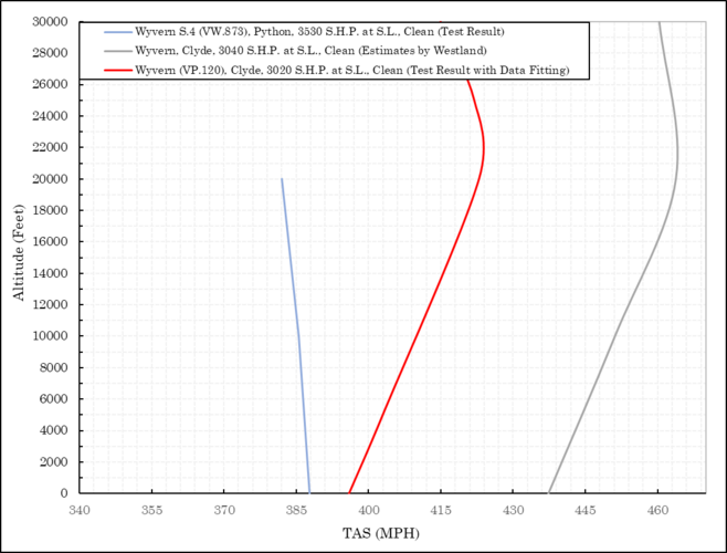

With a bit of data fitting, I obtained the red speed performance curve below:
The VP.120 failed to meet its estimated speed performance set by Westland in 1947, but it outperformed the Python-powered S.4 with less power. Given that the Clyde had way more potential than the Python, with a whopping 4,230 shp clearance test finished as early as 1949, this variant of the Wyvern could have been a really good torpedo-fighter.
