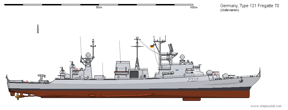

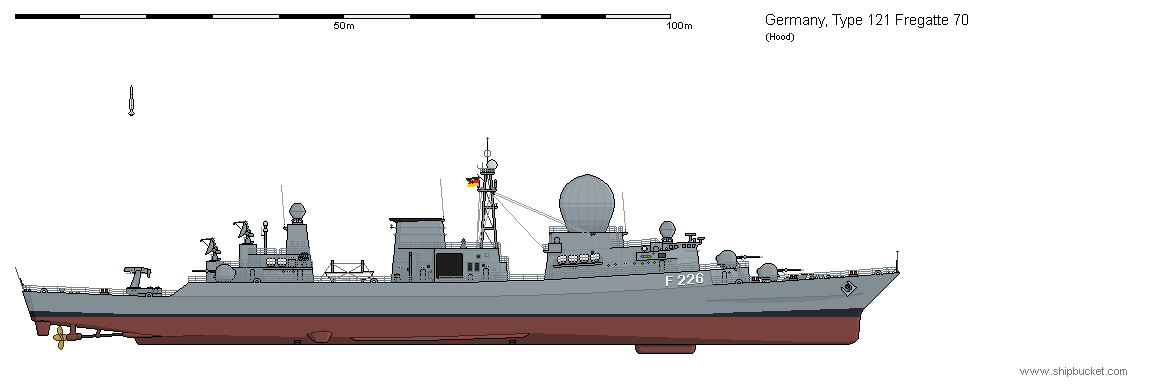

The excellent Italian Almanacco Navale for 1968 notes that Rommel was previously going to be called Von Fritsch. It adds that 5 further ships were to be built in German yards but this has been cancelled.
Instead ten ships of a new Tartar equipped frigate class (a drawing shows the 3,500 t design based on the Koeln class frigate). Additionsl armament to be 2 76mm and 2 40mm guns of Italian manufacture plus 2 torpedo launchers.
The German Navy started with a modified Hamburg class design (possibly to get Seaslug, though this and Terrier were too big for the planned 6,000 ton ship) of 6 units.
The selection of the CF Adams class may have been influenced by one of these ships being used to test the idea of NATO crewed ships. Italy and Japan built their own designs with Tartar and France modified a destroyer. The RN looked at upgrading Darings with Tartar. Spain initially planned to build Leanders equipped with Tartar but had to build Knox class instead (Brooke class no longer being available).
