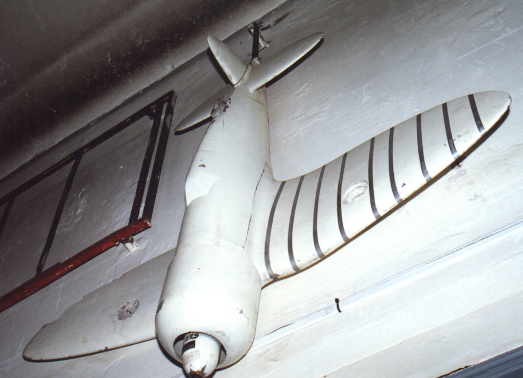

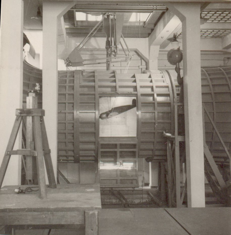

The Ezüst nyíl model in the wind channel (Budapest University of Technology):
The model (and the wind channel also) survived:
