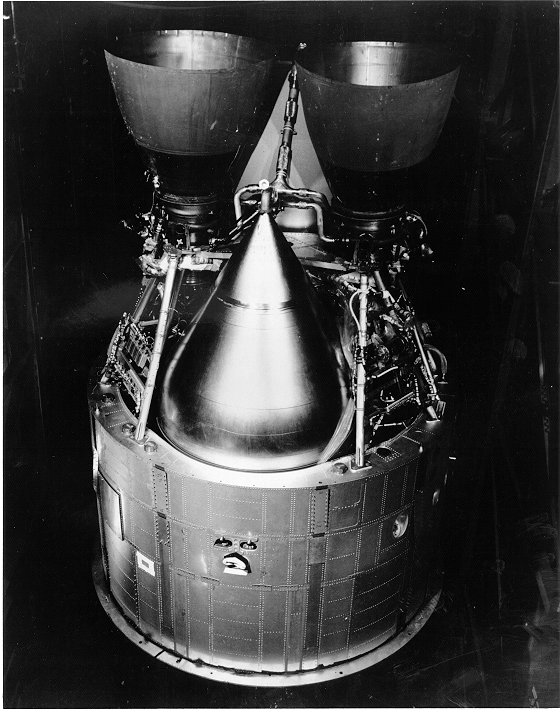

I don’t know if it counts, but what about the Titan IIIA? The Titan IIIA was more or less the Titan II ICBM fitted with the Transtage upper stage on top of the two core stages. Perhaps the Transtage could be modified to carry a post-boost vehicle with either a single or MIRV warheads?
No need to be modified. It is exactly what a PBV is.
