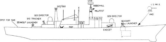

What I argue is that with some cosmetic modifications, Soviet designs are close enough to the British design concepts (i.e. what was planned before the Treasury cut everything down). Arrangement of armament, sets of weapon systems, radar groups, etc. Moreover the models I posted in the first post are not exactly Soviet, if you look carefully enough. It's obviously an initial artist error, and I tried to make as much use of it as possible.
For example, take the Type 23 frigate and Kara cruiser. Then try to blow up Type 23 to Type 43 (long range anti-air systems fore and aft, ASW/ASuW missiles, two turrets instead of one) and how different this will look from Kara?
Apart from the CATOBAR carrier, the only thing obviously British in the artwork is the White Ensign and some of the aircraft.
NATO-UK shows UK radars, missiles, guns, aircraft, hull forms. I would expect Warsaw Pact UK to show similar UK content, even if Soviet style missions would influence what kind of ships would be built. I can discern a RN destroyer from a USN one even if the type is unfamiliar to me.

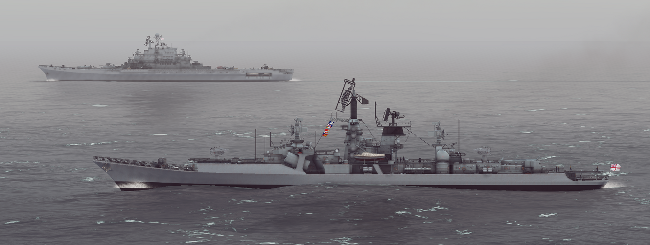

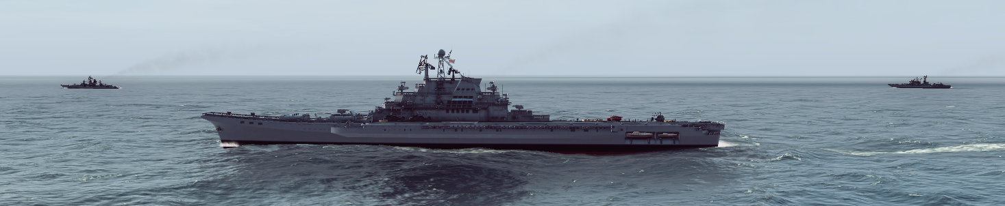

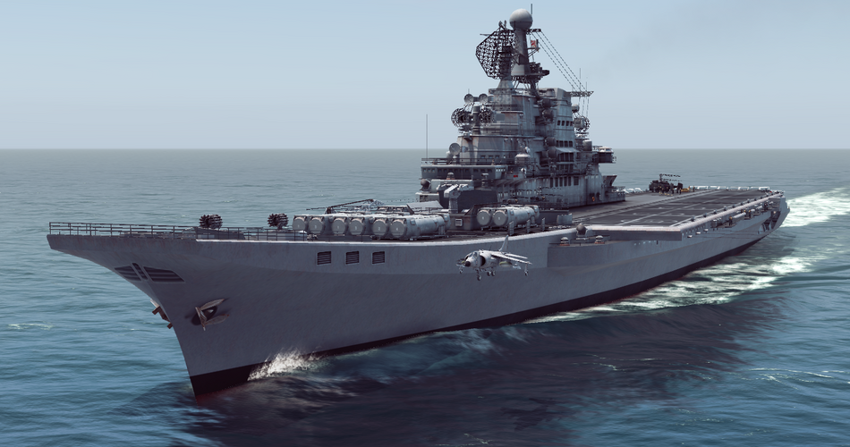

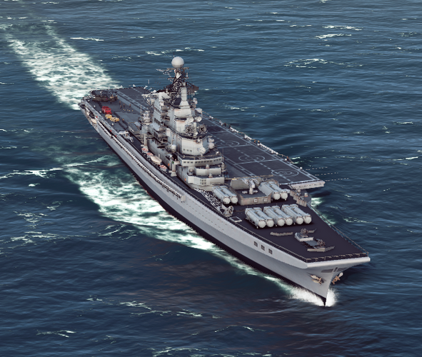

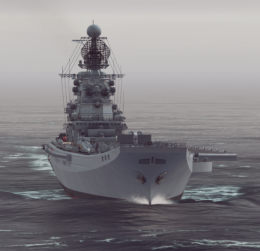

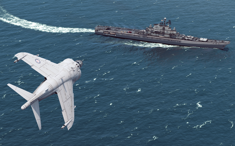

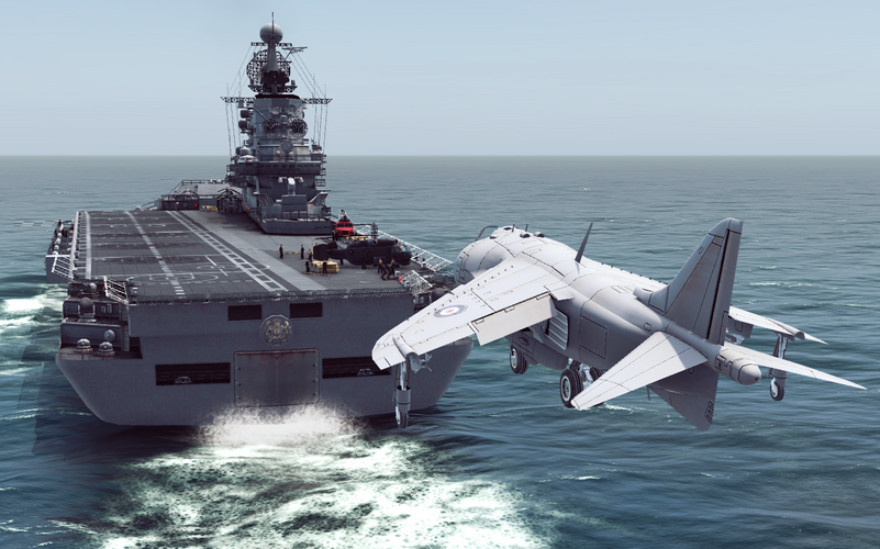

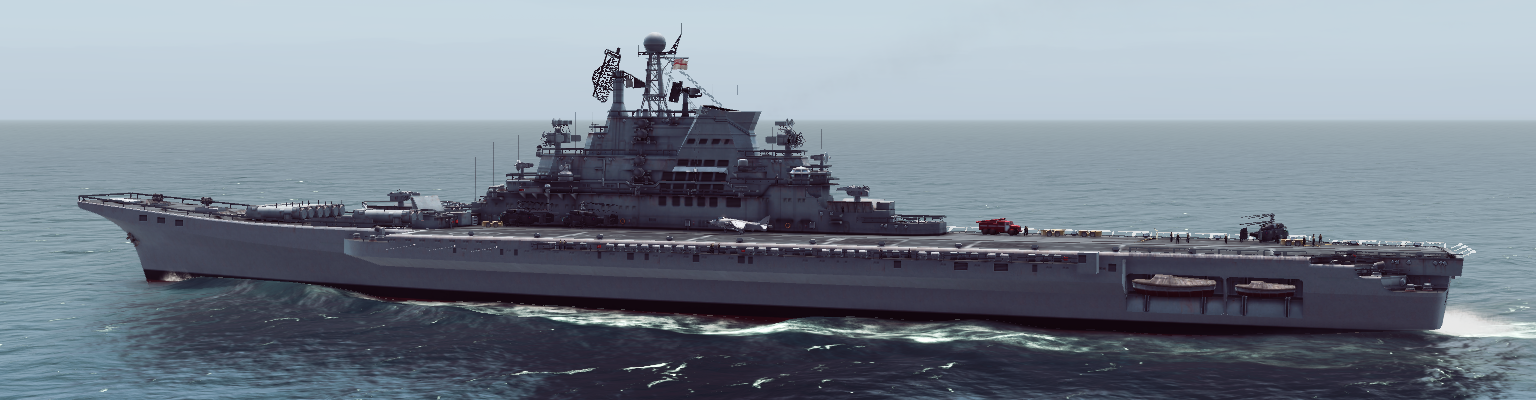

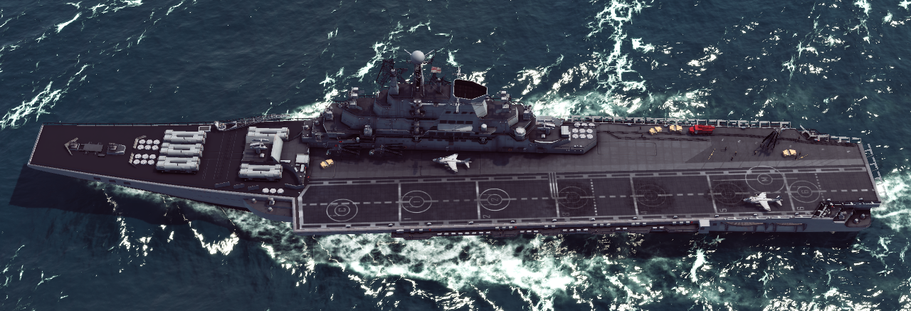

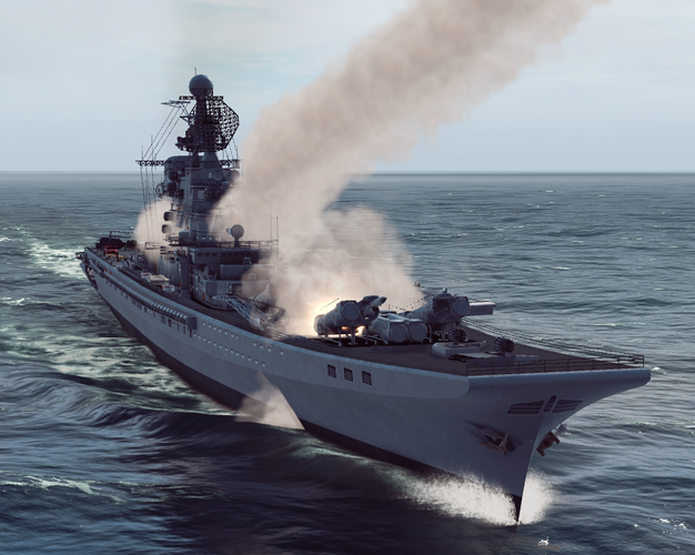

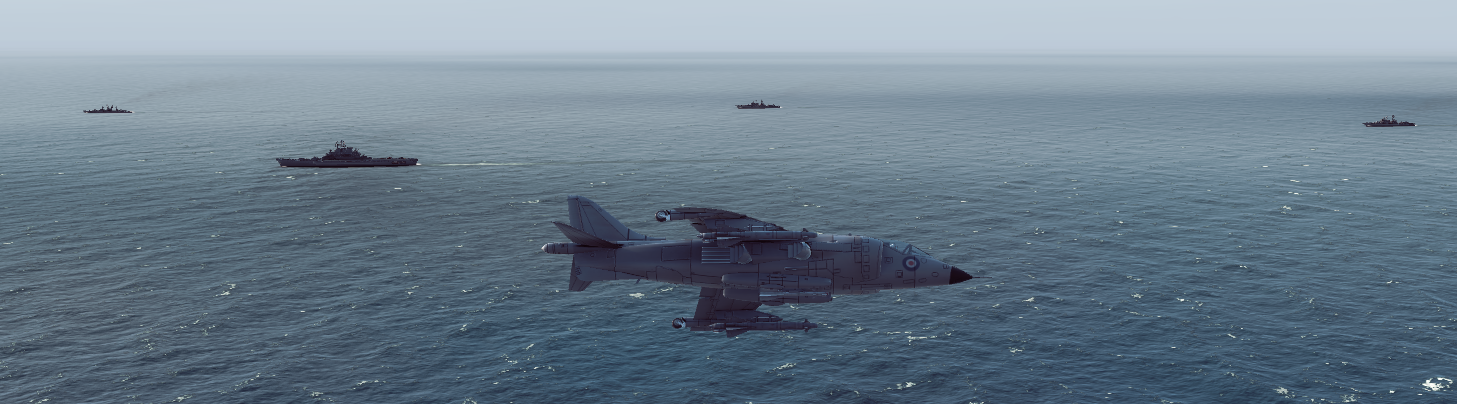

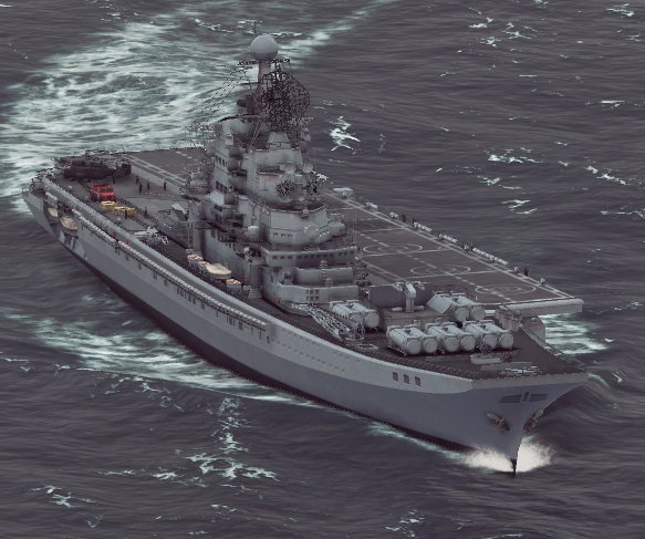

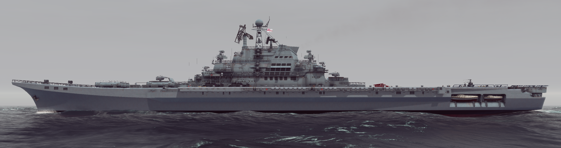

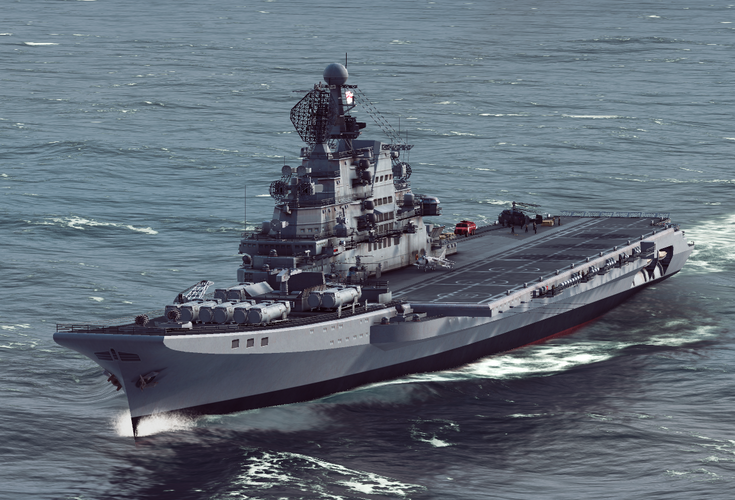

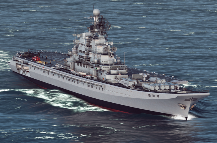

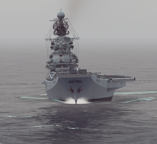

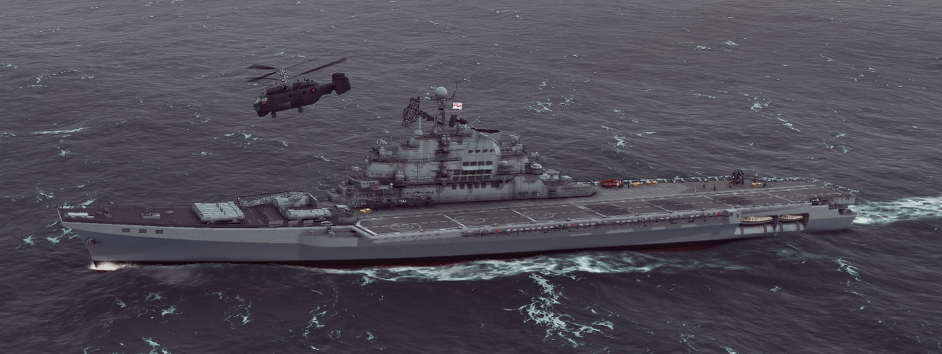

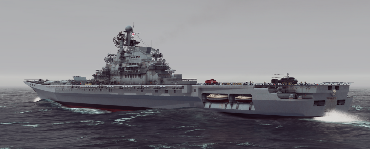

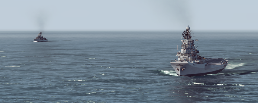

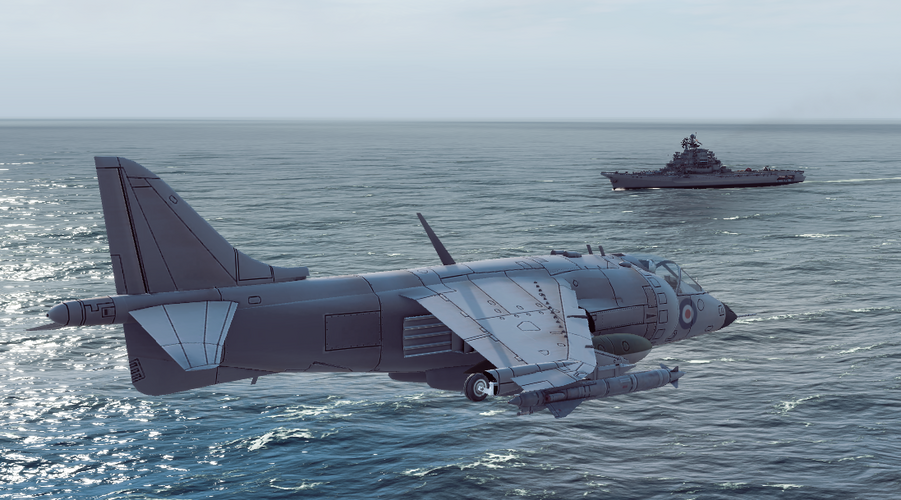

Some impressions of the Escort Cruiser in operational environment.
Launching Harriers
Helicopter fly-by
Even in a Warsaw Pact-UK Navy I would still expect your Harrier-equipped cruiser to have a ski jump at the fore end of the flight deck.
It might be closer to the original 7° one on Invincible & Illustrious, but it would be there, to enable use of the full 5,000 lb payload of the initial models (GR.3, Sea Harrier). By the time an improved version came along (the FA.2 had a max payload of 8,000 lb) such as the "Big-Wing Harrier" (that was rejected in favor of the Harrier II design and would have increased the payload to ~9,000-9,500 lb like the AV-8B) they might have required the ramp to be steepened closer to the 12°-14° of the later Invincibles, PdA, Garibaldi, etc.
The Kievs never had one because the Yak-38 had a very restricted payload, and was there more to be forward control for AShMs fired by its base ship than for independent combat capability (the improved Yak-38M had a total payload of 2,000 lb), so little would be gained by adding a ski jump to the Soviet ships.
What was the length of the flight deck on your version of the Kievs (the original is 186m [610'])?
As this is a bit longer than the 170m (560') flight deck of Invincible & Illustrious as built, the lower 7° jump angle might be considered sufficient with the 4-knot faster speed of the Kievs.
That 610' is about the same as the 183m (600') of Ark Royal's 12° jump flight deck (and the other two after their ski jumps were rebuilt in the late 1980s-early 1990s to 14°), so perhaps a 10° angle might be better for your Kievshires. ;)
Either option should only lose you the forward helo spot, but improve your Harriers' combat power.

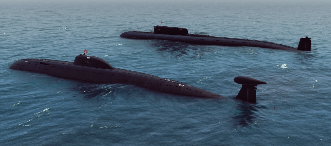

For the submarines I chose the Alpha and Oscars, probably because I just like them, but I suppose that they should be in fact locally or jointly developed.

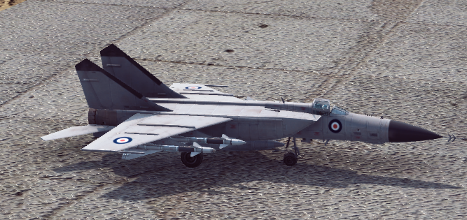

As the fun part of it, I dug a little into period naming conventions and came up with a list of names for aircraft and weapon systems. It's more for immersion purposes only, and not really serious, and of course it is implied that some of those systems are in fact local or joint development, but just look similarly (design convergence), but bear with me for a moment.
Ka-27 -> Westland Kingfisher
Mig-23A -> Hawker-Siddeley Harpy (RN)
Mig-23 -> Hawker-Siddeley Harpy (RAF)

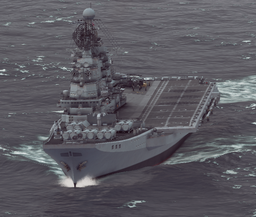

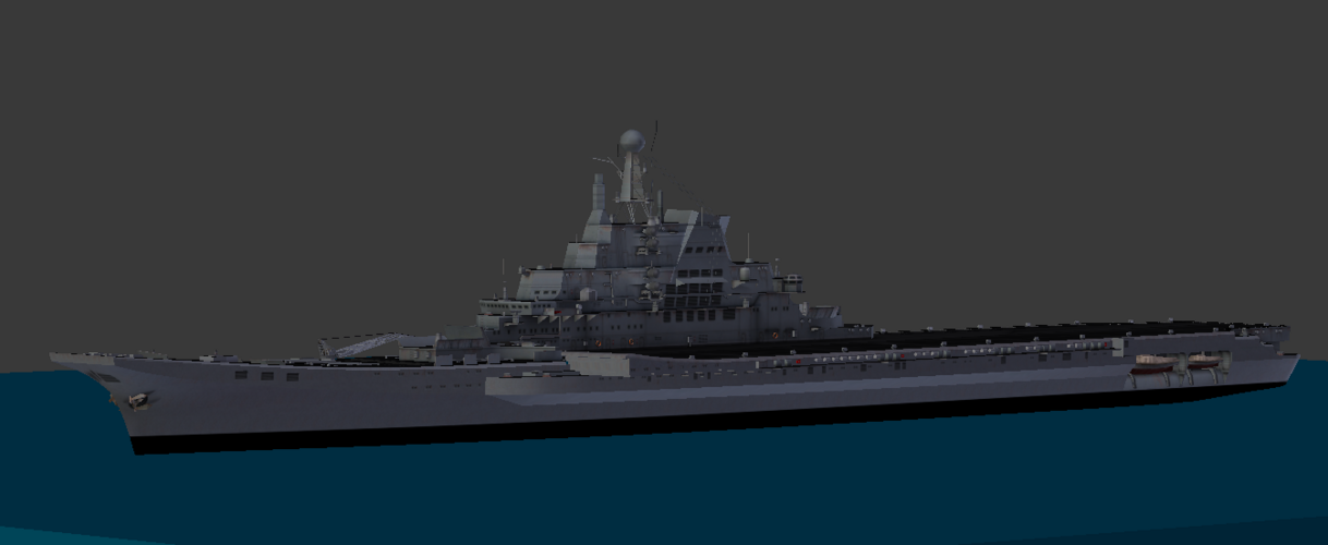

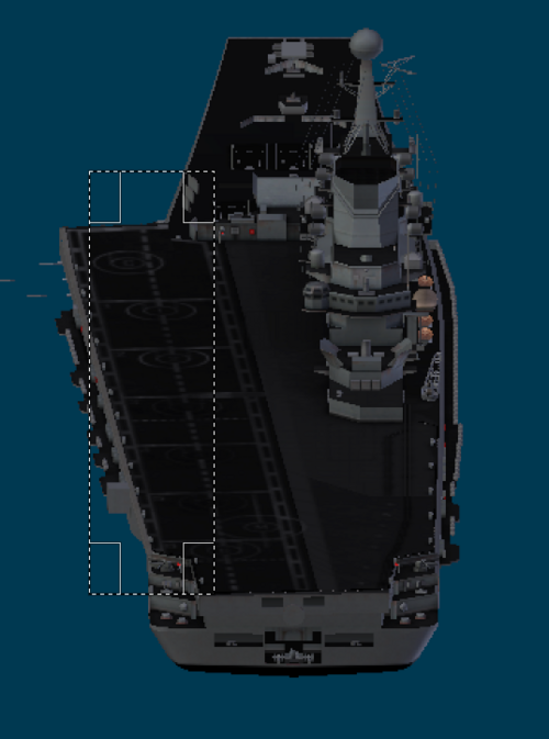

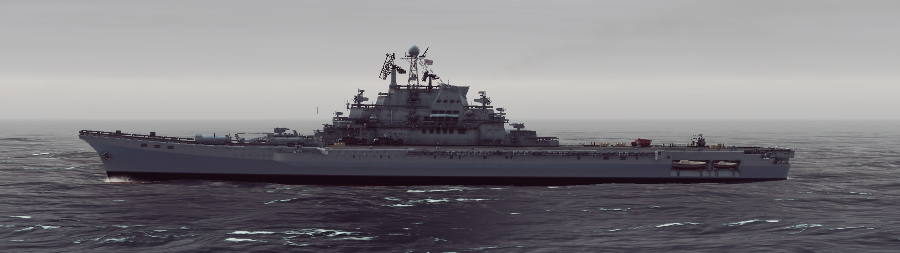

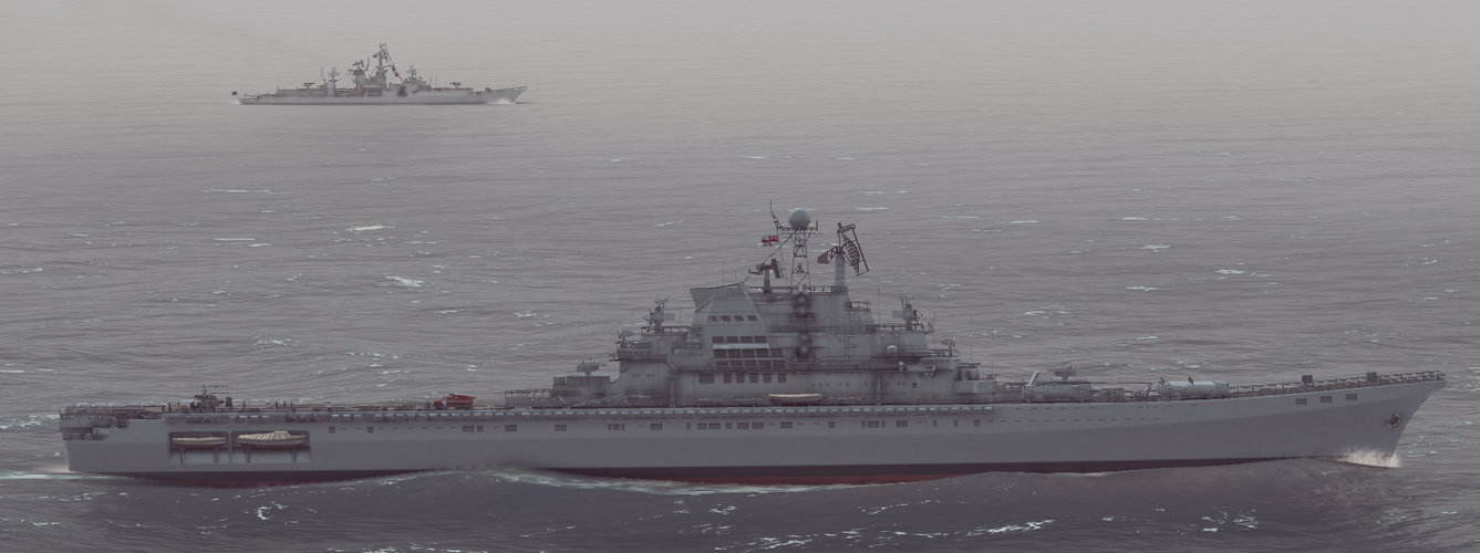

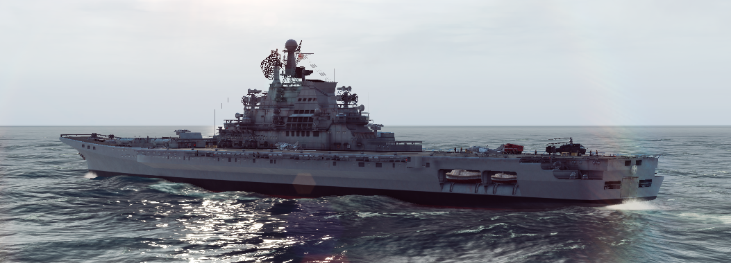

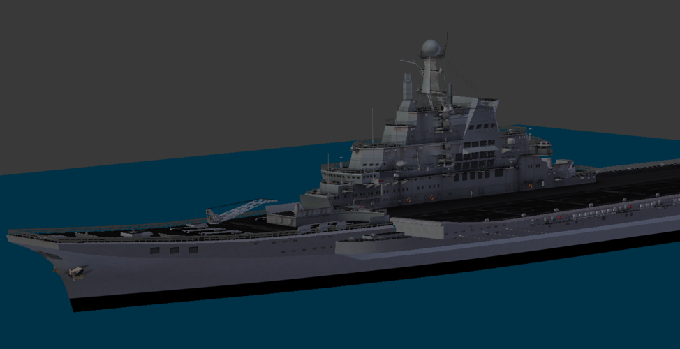

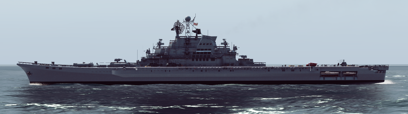

Some more screenshots - I made some very minor and cosmetic fixes the most notable of which is widening the black stripe over the waterline. Somehow, it just makes everything look right.

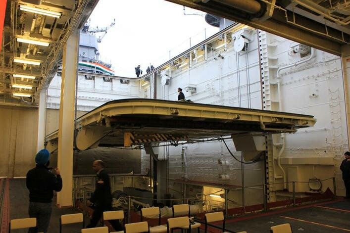

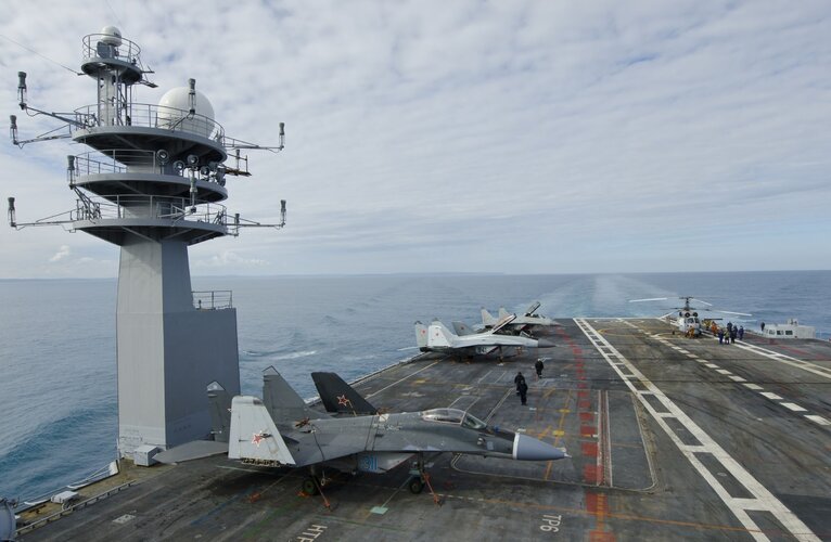

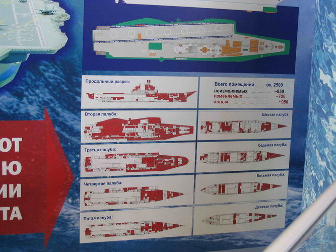

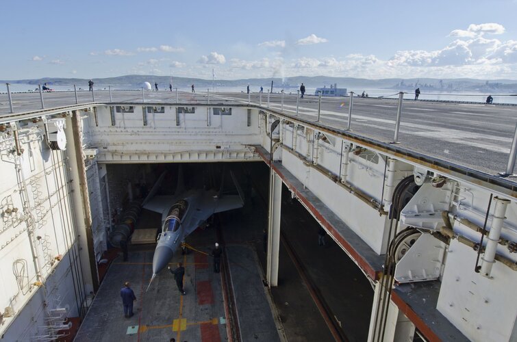

For the aft lift - here are a couple of pics of the real thing in ex-Baku/Gorskov-now INS Vikramaditya (pics from internet - I believe the Key Publishing forums during the modernization and sea trials):
First 3 looking aft:
Looking forward - note the hangar forward of the lift has fire curtains in place separating the hangar into two:
The fore lift is built the same.
Here is a deck plan inside - I know the part with the green background still shows the missile launchers in place, but the flight deck outline there and in the red section are purely that of the modified layout for India:
@BlackBat242 , thank you for those images, I haven't seen those photos.
The orange parts are those that were removed, green shows new additions. A apparently the aft elevator was widened to fit Mig-29 with folded wings, since the original was even more narrow.
Concerning the ski-jump and possible later modifications to the ship.
As I read in The Age of Invincible, the actual development of the ski-jump was a relatively late addition and if we suppose that those ships are a direct combination of Escort Cruiser study series 21 and Soviet 1143 project, it would probably mean they are began earlier (1970-71) and probably, unless the development accelerated, completed without it. But it was a one-man project and we can't be sure.
I tried to fit a very modest ski-jump as you suggested:
...and it does look somewhat awkward combined with an angled deck. So I am certainly open to consider other options.
One I could think of is removing the CIWS from the port side sponsons, and extending the deck forward and sideways, making it parallel to the centerline (Invincible style), and possibly removing the port-aft missile container in order to make the deck not too wide outboard, something like this:

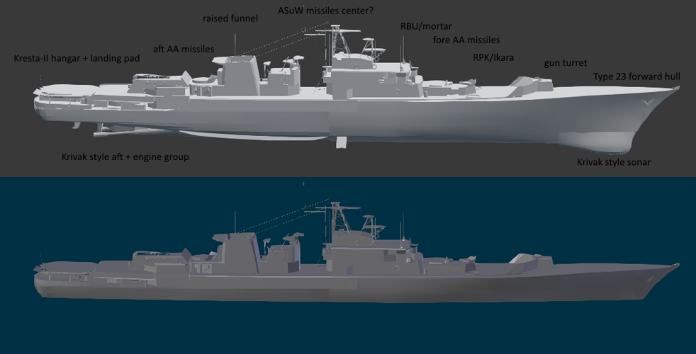

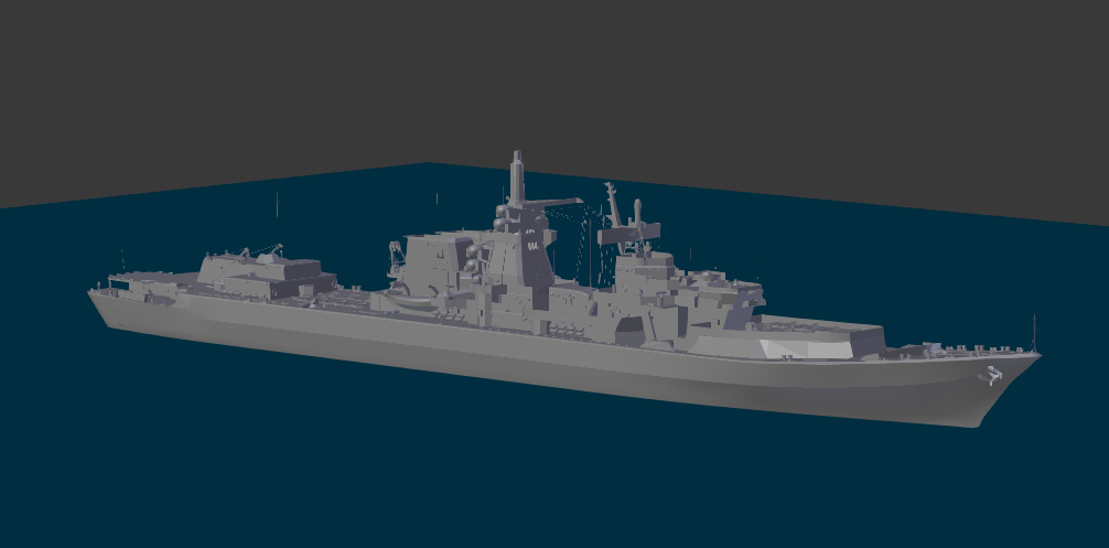

Now that we have the Escort/Command cruiser finalized for the time being, here is a very quick and dirty design study for Krivak-II conversion.
Based on early studies for Type 23 and heavily utilizing existing parts. The hull is somewhat lengthened to enable installation of a 4.5" gun.
I am not sure about anything here, it's just playing with parts for the moment.

Childs, The Age of Invincible
Are there any additional details about this study?
Some more images -
I replaced the short-range air defense system on the Escort Cruiser with SA-N-9 containers (referencing Baku/Gorshkov, 24 revolving containers with 8 missiles each) and replaced the redundant artillery FC radars with corresponding systems.
Then there are a some boring but necessary repaints.
An AEW/SIGINT/EW aircraft based on the Tu-16K as an alternative for Nimrod AEW3 (I nicknamed it Sargon):
Mig-25PD -> Wraith FGR, RAF needs a long range interceptor for this timeline
Just an additional shot of RAF Harpy (Mig-23) taxiing:
And RN black skins for Oscar and Victor-3 submarines (original textures have white waterlines, red bottoms and gray sonars):
And then I (vaguely and tentatively) think about an implementation of the large Type 43 concept basing on the Slava-class hull and dimensions:
A second VLS cluster forward instead of the heavy anti-ship missiles, somewhat different hull, maybe larger hangar aft. Again, playing with existing parts mostly.
Oscar-equivalents would be likely, but Alphas were "interceptor" subs for the Soviet boomer Bastions. And honestly probably would not have been built.
Victors or Sierras are the more likely RN-equivalent attack subs.
