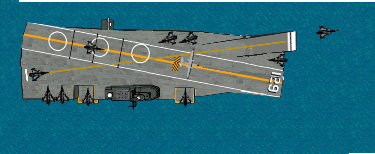

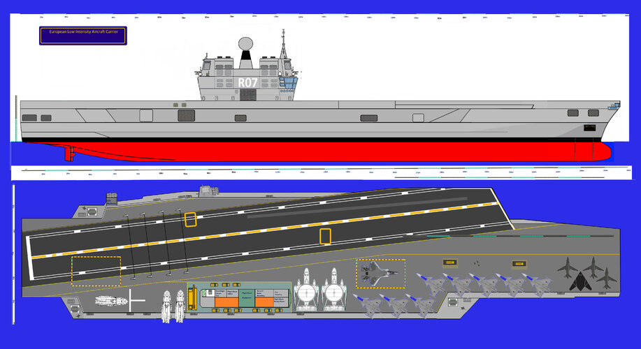

What do you guys think about reviving the SCS III concept as "Gripen carrier"
There were plans for Sao Paulo to be fittet with Gripen.
I could imagine some sort of european carrier equiped with the far less expensive Gripen (less than F35B) and build carriers with two squadrons of Gripen.
Does it pertain to VSS? Gripen is not even a real option atm.
Oh yes I think so. It is a variation of the VSS III of one of the above posts.
A variation of the one with angled deck.
I changed the catapults position.
Gripen could be a possible aircraft because Saab offered the Gripen to Brazil and should have plans ready for further update of the Grifen.
Rafale would also be an alternative.

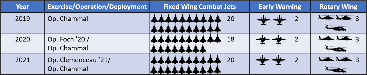

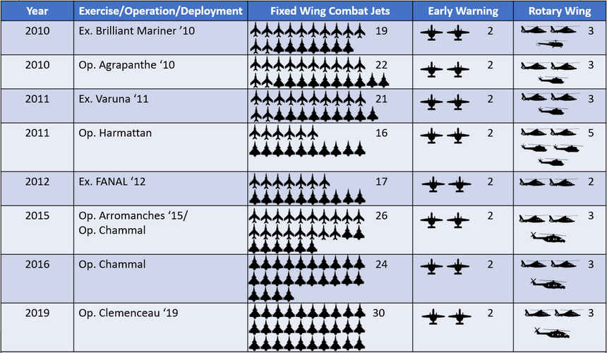

Without an AEW unit and some ASW helicopters at a minimum, the carrier won't be able to defend itself.
Mojave Reaper could be the AEW unit, but you still need space for at least a dozen ASW helos.
The number of ASW-Helos depends on the missions you plan. Charles de Gaulle for example did not have at least a dozen ASW Helos on it's last missions. Talking about a VSS III the size of Foch and Clemenceau we won't be able to accomodate 2 aircraft squadrons and a Heli squadron without squeezing. But the aircraft of the last missions of CdG should fit - I think.
