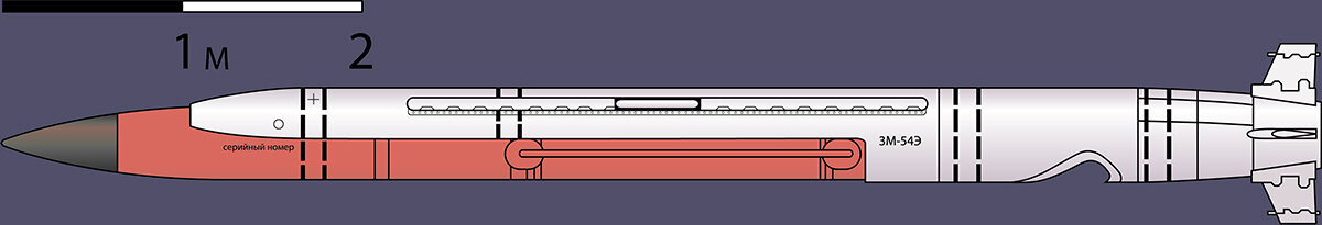

PrSM would be a good match though. Still, Sizzler isn't a Tomahawk with a rocket in it. It's more a rocket with a bolt-on wing/propulsion/fuel tank kit installed. The "dart" is way bigger than an SM-2. The missile itself is about six and an half feet longer than Tomahawk. (27' with booster vs 20.5' for Tomahawk.)
