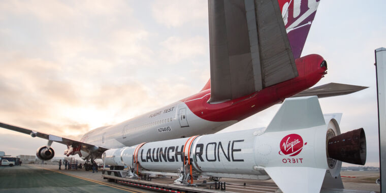

View: https://twitter.com/shorealonefilms/status/1638012386941751296
Virgin Orbit's Boeing 747-400, "Cosmic Girl" at Long Beach Airport. Her fate doesnt look good. per CNBC. The latest on Virgin Orbit, as leadership continued to talk with investors through the weekend to find a funding lifeline 03-20-23
