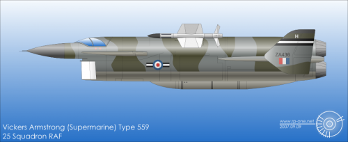

Hi!
http://www.rp-one.net/f_155_t/f155t.html
https://blogs.yahoo.co.jp/spitfire5jp/28963063.html
General specifications
Crew: two (pilot and weapons responsible for navigation)
Overall length: 20.8 m
Wingspan: 12.8 m
Height: 4.65 m
Wing area:57.1 m ²
Empty weight: 18817 kg
Gross kg: 28209
Engine: de Havilland gyron PS.26/1 Turbo Jet engine (thrust 89 kN, reheat at 120 kN) x 2
Spectre junior rockets (22 kN thrust) x 2
Performance
Maximum speed: Mach 2.5
Combat action range: 241 km
Ceiling: 18000 m
Duration: 32 minutes
Armed
Missiles: missile guided Red Hebe or Blue Jay infra-red guided missiles x 2
My favorite F-155T contender. Except for the overwing missiles - a desperate move.

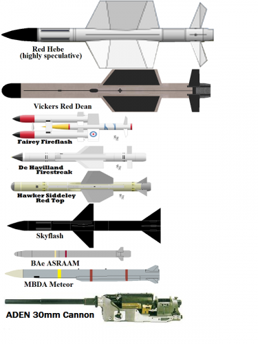

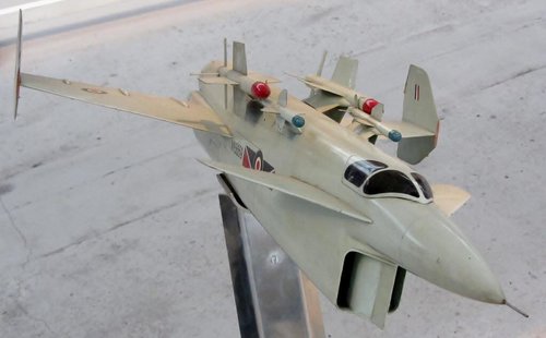

IIRC Red Hebe, unlike Red Dean, was SARH - this would have demanded a radar capable of illuminating the target.
IIRC also, AI23 was a dead end in terms of being fitted with a CW injector for this purpose, but whether this was because the radar was unsuitable or there simply wasn't room in the Lightning, I cannot recall. OTOH AI18 could have been so retrofitted.
Red Hebe was meant to be a smaller, lighter version of Red Dean, using CW SARH as it's guidance mechanism. Therefore, I'd suggest that diagram is wrong on it's dimensions. It's a shame that Red Dean was not developed to production as it would have put the RAF out in front of the USAF and Soviets. Neither of their missiles were Fully-Active homing.
Red Hebe wasn't ever a finished design but it was longer, with much bigger wings (45in versus 70in span). Weight was about the same as Red Dean (Red Hebe given variously as 1,200-1,300lb, Red Dean being 1,330lb)
Early version was 17ft 6in long, with mooted aerodynamic fairings to reduce drag taking that to 22ft 4in.
Next version was 19ft 5in long.
Final version before cancellation was 17ft 6in, 14.5 in diameter.
Red Dean was 16ft long.
Seeing the dual Red Hebe/Red Top fit makes it clear just how huge a missile Red Hebe is - recall that Red Top is of the same approximate order of size as Sparrow, so Red Hebe would dwarf even Phoenix. It would be like putting extended-span fins on an AAM version of Tartar/Terrier.
RH is not a missile you even think of carrying conformally, unless your airplane has a very slab-sided fuselage! :p It's a very big missile for a very big airplane - little wonder they tried to develop a radar version of Blue Jay for the Sea Vixen!

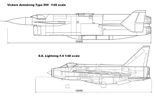

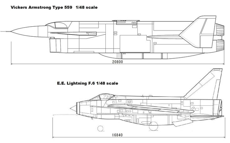

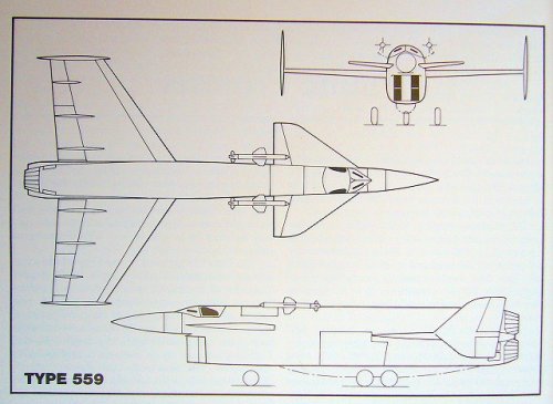

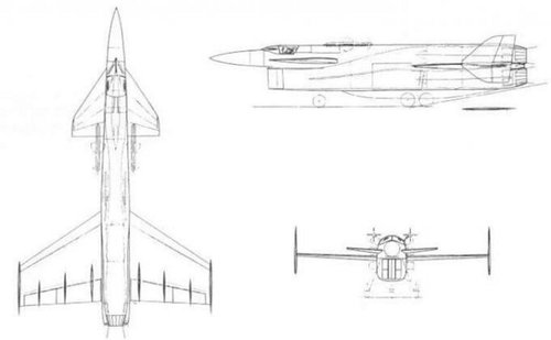

Hi! Three side view drawing.

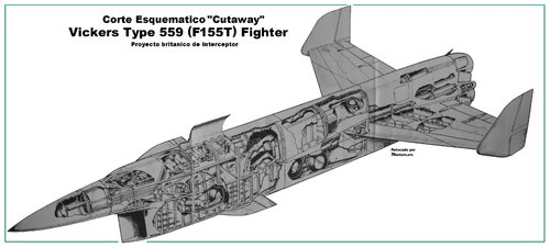

Dredging this one up. Are there any images in the brochure (or anywhere else) showing a crew access ladder?
That's a shame, which means there probably are no official drawings.
Interesting the amount of detailed design behind some of the F155 submissions but not others.
