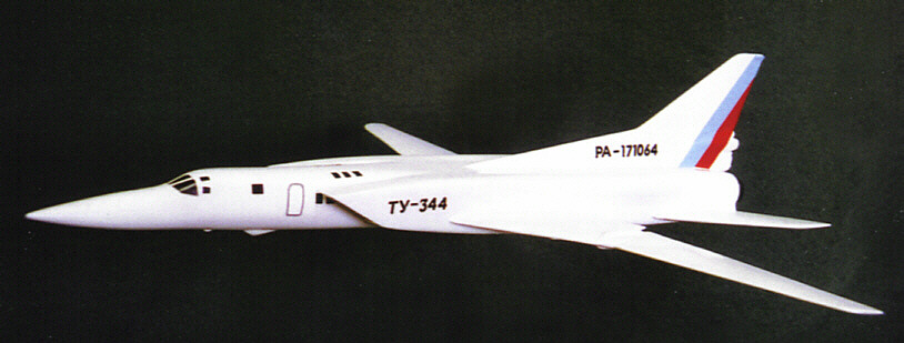

How about this Russian military conversion proposal - the late 1990s proposed conversion of Tu-22M-3 bombers into a business jet for 10-12 passengers:
Regards,
Greg
Regards,
Greg
Hi Greg!
That's pretty nice!
Thanks so much!
Chuck

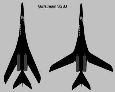

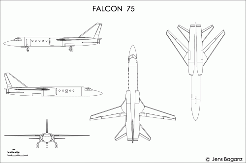

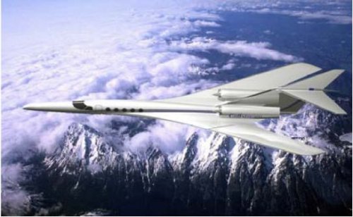

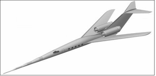

Reasonably. Gulfstream has spent the past several years working on it.
Orionblamblam said:
Matej said:
However I dont know, how seriously was meant this proposal.
Gulfstream has been toying with the idea of a SSBJ since its early 1990s collaboration with Sukhoi.

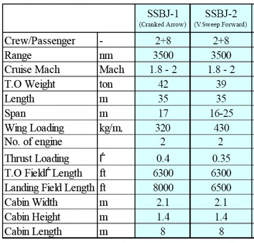

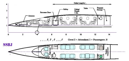

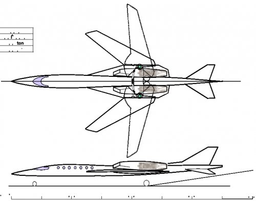

Japan Aerospace Exploration Agency (JAXA) FSW/VG/QSP supersonic jet project from 2005. Being one of SSBJ alternatives studied, somehow this one became an final version of the design. Doubtless, too much Gundam was watched by design team.
AIAA 2005-1018
Conceptual Design of a Low Sonic Boom SSBJ
Shigeru Horinouchi
Japan Aerospace Exploration Agency, Tokyo
43rd AIAA Aerospace Sciences Meeting and Exhibit
10 - 13 January 2005, Reno, Nevada

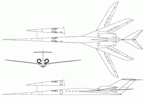

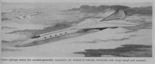

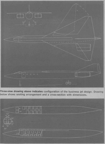

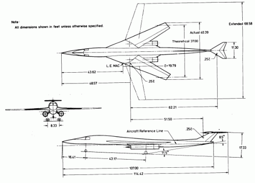

Old thread, but I just found something, I wouldn't have expected from
the Caholic University Washington D.C ..... ;)
Ok, they have a department of space science and applied physics, so, why
not design a VG bizjet ?

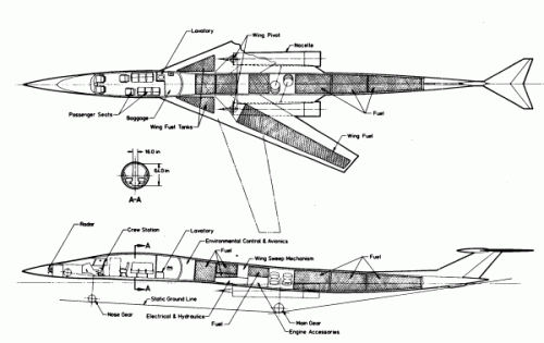

Some data : 4 GE 1/J1B engines with 8.500 lbs dry thrust and 15.000 lbs with
reheat, length 85 ft, span 57.5ft/38 ft (unswept/swept).
(From Avaition Week May 1967)

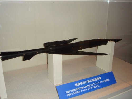

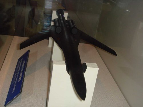

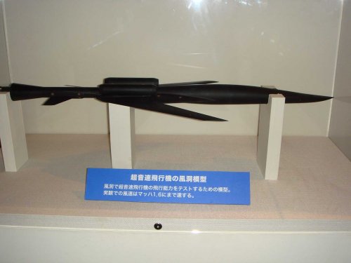

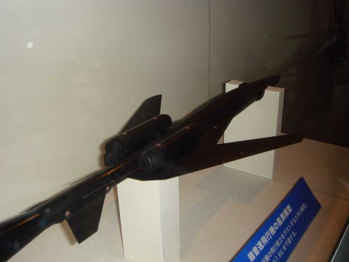

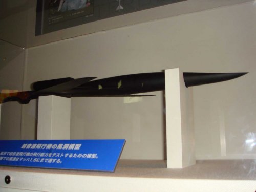

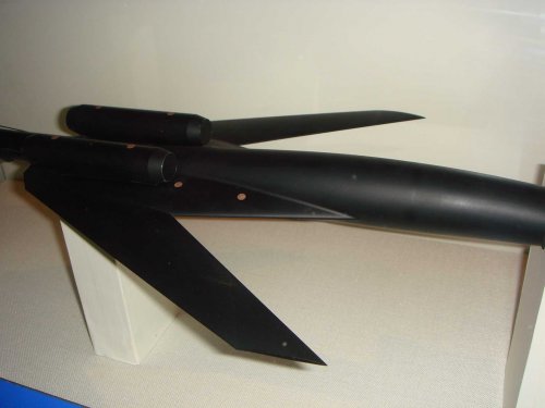

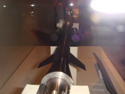

Hi all! JAXA's SSBJ wind tunnel test model which test speed is mach 1.6.

any more information about the kentron design (reply 5) and cotholic university design (reply 11)? in particular, does kentron refer to the south african or u s company?

Engines: I've seen several proposals that call for using an in-service low-bypass turbofan like the JT8D or Tay.
Fuel:
Sonic boom: There are methods being researched to reduce the boom, basically involving airframe shaping and some things like the extended nose on the VG Gulfstream concept.
It's not a dead end; the biggest obstacle is the sonic boom issue. Nobody wants to buy a supersonic airplane that they can't fly supersonic most of the time. Solve that problem, and you have a market.

kenneth said:
... does kentron refer to the south african or u s company?
US. For earlier (and non-VG) NASA/Kentron work see: http://www.secretprojects.co.uk/forum/index.php/topic,4786.msg39556/
