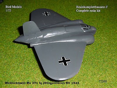

the Messerschmitt Me.271 ?,was it a real one ?.
http://www.ebay.co.uk/itm/Messerschmitt-Me-271-bz-V8-1943-1-72-Bird-Models-Resinbausatz-resin-kit-/252414484613
The description ("coated with a breathable material", "would have let air into the airframe even without a dedicated
intake trunk"), to my opinon places it in the category "fiction".
And the sources seem to be very vague indeed. ::)
OK my dear Jemiba,I agree with you it's fake;
but we must know that,the Me.271 was (Blitz Zerstorer) or a ramjet fighter Project,so maybe
this design was close to its shape,but it is not it.

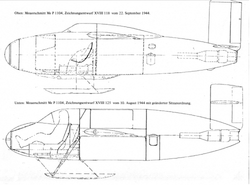

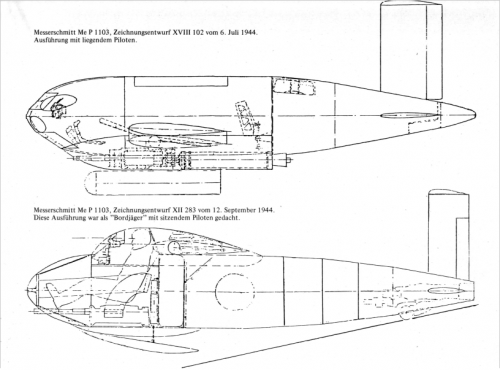

Here is a Messerschmitt P.1103 7 P.1104 in details.
The source;
Waffen-Arsenal 118 - Bachem Ba 349 Natter
hesham said:
Also a strange thing,
Here is the source for "Me 271bz Blitz-Zerstorer":
http://roswell.greyfalcon.us/Me271bz.html :)
But the model from your link doesn't look like this anyway; rather it looks like normal aircraft, fully plausible, with normal turbojets and normal air intakes. Moreover, it looks much like some real Lippisch projects of P.09, P.10 or P.11 series. Probably the model represents one of these real projects, but under fictitious designation?

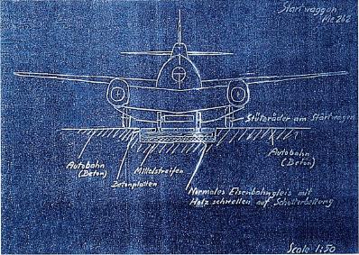

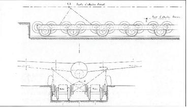

Just need to be confirm,I found this Startwagen me 262 in "Le Fana de l'aviation n°396,november 2002":
Me 264 startwagen:
http://www.germanluftwaffe.com/archiv/Dokumente/ABC/m/Messerschmitt/Messerscmitt%20AG.htm
How many me 321?

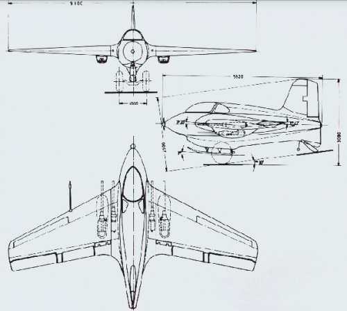

BT 1000 on me 163:
163 with gunpods from here https://www.uni-stuttgart.de/presse/archiv/themenheft/09/neunhoeffer.pdf
The pdf has some other drawings of lippisch designs, but unfortunately they are quite low resolution.

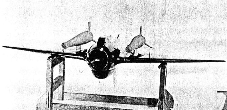

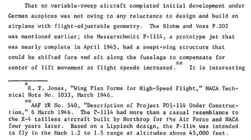

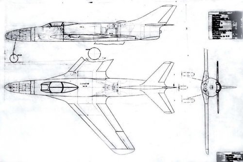

Sounds like this was actually a lippisch project misidentified as messerschmitt, but maybe someone can dig up the referenced report to find out for sure
"the Messerschmitt P-1114, a prototype jet that
was nearly complete in April 1945, had a swept-wing structure that
could be shifted fore and aft along the fuselage to compensate for
center of lift movement as flight speeds increased."
"AAF TR No. 540, "Description of Project P01-114 Under Construc-
tion," 6 March 1946. The P-1114 had more than a casual resemblance to
the X-4 tailless aircraft built by Northrop for the Air Force and NACA
four years later. Based on a Lippisch design, the P-1114 was intended
to fly in the Mach 1.2 to 1.5 range at altitudes above 45,000 feet"
http://www.dtic.mil/docs/citations/AD0659735
Good Info my dear Sienar,
and that's proof there was a series after Me P-1112,ended by P-1116 at finishing
the WWII.
the WWII.

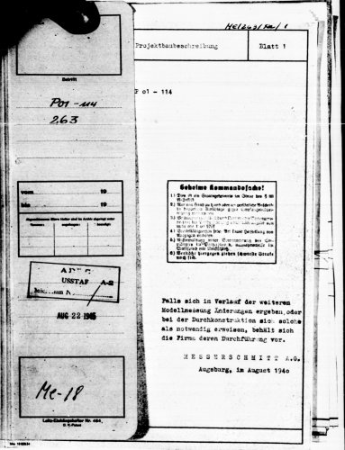

Curious. The full title of the document that Perry notes as the source for his P 1114 reference would appear to be "A F-TS540-RE Description of the project P 01-114 under construction (Projektbaubeschreibung P 01-114). Messerschmitt A.G. ADRC". It's referred to in this list: http://forum.12oclockhigh.net/archive/index.php?t-30683.html. I don't have that tech report but I do have a copy of Projektbaubeschreibung P 01-114 and it very much does not outline the aircraft he claims it does (see attached). It is a Lippisch project, and the design was tailless, and it was certainly studied with a variety of different swept wings... but it wasn't supersonic. I think there's been some sort of mix-up or misunderstanding somewhere along the line. It's not impossible that there was some sort of P 1114 but Perry's 1967 RAND report doesn't seem to go very far towards confirming it, given the above.

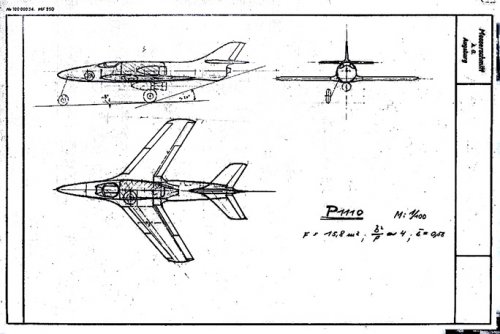

From Flugzeug Classic Jan/17
Both well known. The latter from the Feb 1945 1-TL-Jager report. Surely Flugzeug Classic can do better than this.
