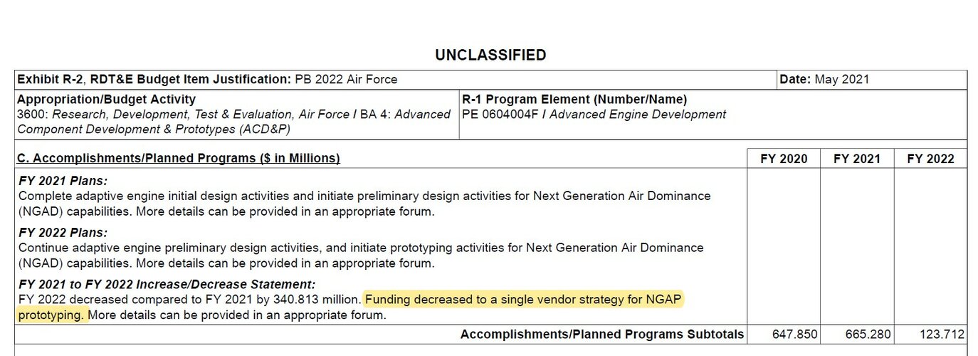

The challenge will always be heat. GaN can convert more power to RF wave.. in smaller package than GaAs but ... with big power comes big heat flux.
Carbon nanotubes are very good heat dissipaters, but then I'm still waiting on those 1THz CPUs that were supposed to be possible with them.
Nice to see Dr. Roper being mentioned still
