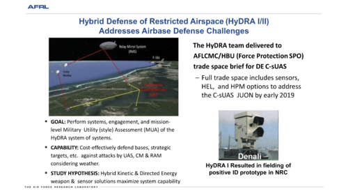

Besides, it's not a replacement for long range air defences but for shorads and CIWS. It's just that lasers are going to be so effective up close that nothing will get through. It's like the machine gun in WW1. Nothing could get through. Artillery shells could, but lasers can take them out as well. Until ofc the invention of the tank and so forth.
Mirrors can become pretty hot too afaik. Flying mirrors or flying lasers for area defence is an interesting concept indeed.

Holy cow. Inverse square law refers to spherical propagation. Lasers are plane waves. Laser spot size on the target is determined by diffraction limits set by the diameter of the emitting aperture.
Yes. Electric cars are the same. Everyone was saying "they have limited range". Battery tech has evolved and now they are almost going to surpass ICE cars. Ofc they will never be good at transporting heavy stuff.

I'm a little doubtful that lasers can take out artillery's shells, if we talk about unguided shells. Of course with enough power anything is possible, but range of your laser/size of battlefield comes into this.
For sure, laser is probably the main current answer to AAM and ATGM. But note current.
Some of the criticisms of close-in defense with laser weapons amount to criticizing CIWS performance
against constant-bearing-decreasing-range targets on the basis that their projectile velocities decrease with range.
