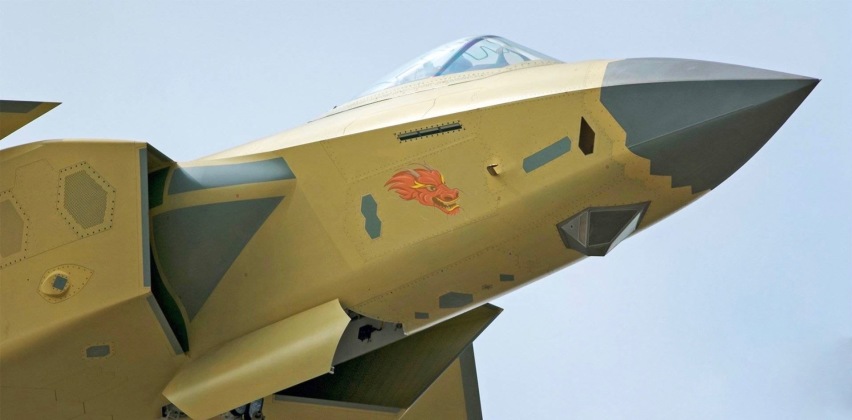

China Developing the J-20 Stealth Airframe Into a Twin Seat Airborne Early Warning and Control Jet
good idea or bad idea?
A somewhat dubious idea, IMHO, even allowing for it being used as a command & control platform for UCAV swarms and the like, though it could possibly be a cover for another program.
They are probably misunderstanding the distributive targeting capability that stealth and a robust discrete data link could offer.
In a sense F-22 and mostly F-35 are already AWACS.
Plain stupid report based on the most unreliable source - namely Minnie Chan / SCMP - ... as such I would ban any report from her and the militarywatchmagazine from this forum.
