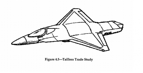

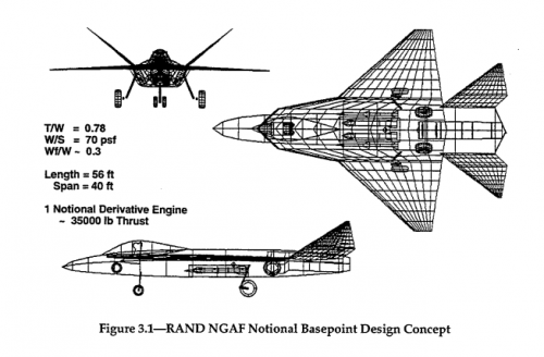

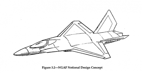

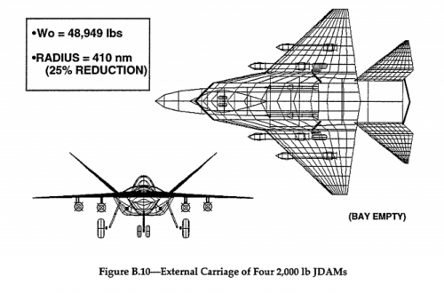

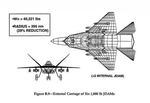

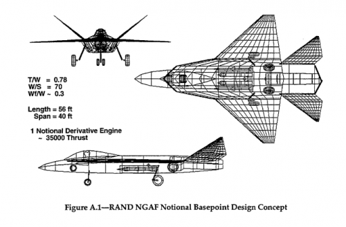

ynm said:
I remember reading a paper of RAND about low observable aircraft designs, but can only google this
www.dtic.mil/cgi-bin/GetTRDoc?AD=ADA314256
The paper I referred to is similar, but contains more designs. And it is not only about fighter but bomber (IIRC). It also compares trade off between low observable and agility. But I can not google it. Does anyone have a clue about it?
From the same source.

Sundog said:
Isn't that last one one of Raymer's designs for a JSF study?
This is Raymer's design for notional Next Generation Attack Fighter (NGAF) study of Rand Corp. (1993-1996)
flateric said:
Ahh, yes, NGAF, I forgot about that program. There were so many leading up to the JSF. ;)
NGAF wasn't a 'program'. This was an internal RAND study.
That's clearly explained in document posted above.

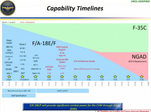

LowObservable said:
To get things back on track, there's been a question that's been nagging at the back of my mind for a while now. Is there any consensus in the community as to when PCA/NGAD etc is meant to be introduced?
They Navy is sticking to its "2030/31" time frame though based on the FY19 budget, the funding does not really line up with that although they could be getting ready to ramp up spending plans starting FY20. The CNO again reiterated 2030 as the in service entry point..
It is also interesting that the Navy is now calling the FA-XX NGAD as well.
By the end of 2019, identify requirements across the family of systems to replace the F/A-18E/F and EA-18G by 2030.
https://news.usni.org/2018/12/17/cno-richardson-calls-aggressive-timelines-new-weapons-operational-concepts-updated-navy-design
