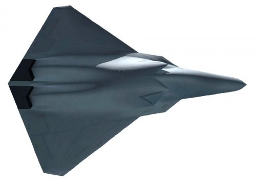

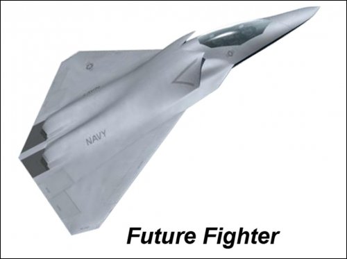

Well, it is supposed to replace the F/A-18E and F Super Hornets so it would to be designed with ground attack capability in mind. The Navy is basically attempting to resurrect the A-12 Avenger with this aircraft by the looks of it. Both A/Cs have no rudders and a level of stealth that is unprecedented as a result of the minimization of control surfaces.
That next generation bomber design looks weird. It's like something out of Battlestar Galactica or something. I've noticed a lot of complaints about the cockpit being too far aft of the front of the aircraft. I guess I can't blame them considering how hard it would be to land something like that.
This is boeing's concept for F-X, that is the successor of F-22, not the navy F/A-XX...hence it is an air dominance concept. This not because it has dorsal intakes that it means it is not good for maneuverability; Actually dorsal intakes have their share of aerodynamic advantages.

'old' FA-XX, but now in higher resolution
Please notice, that this picture shows one of the 'old' F/A-XX as a UCAV. It has no cockpit. Compare it with post #14 & #41. :)
chuck4 said:
With an unmanned aircraft, a dorsal intake needn't have any effect on the aircraft's manenuverability since the aircraft could always pull high negative G, and in the process allow its ventral intake the full advantage of being totally exposed to undisturbed flow.
You have to bear in mind that it's not just the pilot which is limiting the manoeuvrability of the aircraft. A Nz limit graph will firstly have a section relating to lift limit before moving over towards the structural load limit. You'll find that the speed you can pull -9g or more is actually rather high with today's designs. This is because aerofoils tend to be optimised for lift in the upwards sense. For what you're proposing pulling a large negative Nz would require a much different aerofoil shape - and likely lead to really poor low speed (i.e. take-off and landing) performance.
I'm thinking it would be better to go with a ventral inlet and an aerofoil design that produces reasonable Cls when inverted. For cruise flight at high speed have the vehicle fly upside down so you essentially have a dorsal intake. You don't need much lift in high speed cruise so it may be possible without having a massive wing area. For heavy manoeuvering simply roll the aircraft and use it the "correct" way up. If you're having to do such manoeuvres the time for much signature management is probably over.
