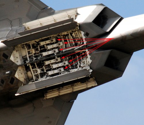

Those designs didn't carry 8 aams, they carried 6. They're working on fitting 6 modified aams in the main bay of the F-22, which would make a total of 8, but I don't know if that's actually happened on the fleet yet.
Sundog said:
Airplane said:
8 aams aren't enough? If its a true family of systems approach and other a/c (manned or not) are lugging aams to the battle then why not?
As far as I am aware it is widely understood and accepted that the F-22s carry 6 AMRAAMs in its main bay (plus a sidewinder in each of its side bays).
http://www.f22fighter.com/weapons.htm
Sundog said:
They've been doing that almost as long as the F-22 has been flying. That's why the AIM-120C got its wings clipped. You can see the ejectors for each of the 6 AIM-120s below:
A question. original f-22 design (not yf-22, right?) had in mind aim120B with its wide fins. Then smaller amraams came. But the design remained unchanged? Or did they redesign the f-22 afterwards to use up the additional real estate (depth of the weapon bay) when amraam C came?
The C was designed alongside the F-22 bay. It was a complicated trade that ran through Dem/Val and ended in a compromise - no folding surfaces but more compact than the standard weapon.
So f-22 bays WERE redesigned and made less deep once it was clear amraam C would come?
Not just AIM-120C though. The 1000-lb JDAM is a bit larger across than the AIM-120C "box," so it might actually be the main driving factor in how deep the bay had to be.
