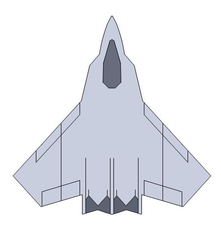

I tried to develop a top view outline for the airplane using a technique similar to the one linked to in the thread about Senior Peg (as well as some eyeballing and guesswork). I'm new to this technique, so I doubt it's too accurate. The nose looks small. Comments and criticism are welcomed.
It look like you drew it correctly, then downsized its longest side but left "keep aspect ratio" option unchecked ;)
I didn't use the same programs as the ones suggested, unfortunately. If I knew the ratio of length-to-wingspan I could make it more accurate. Of course, I'd probably be better off leaving this to someone else! :p

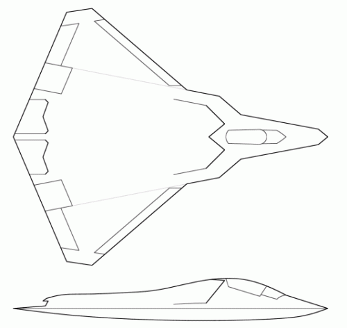

Here's my take on the latest version. I'm mostly satisfied, except something about the top view of the canopy doesn't seem right. No idea as yet regarding scale, however.
Where you take the pic ?
Is it too hard to understand that Scott draw it himself?
