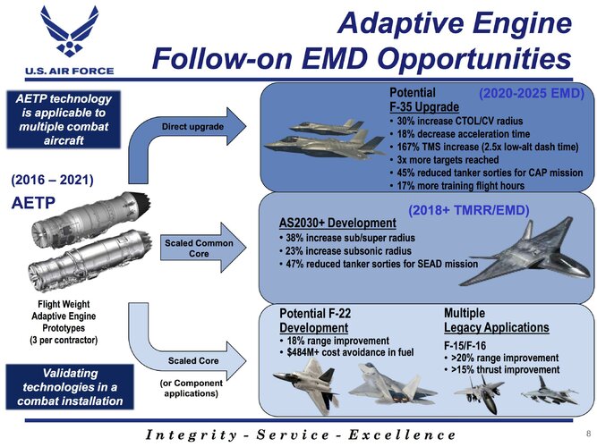

Assuming that those 3-stream engines are 25% more fuel efficient than F119s, that still won't get an F22 sized aircraft to a 3000nmi combat range/1000-1200nmi combat radius.
NGAP engines (XA102 and XA103) can stand to gain quite a bit over the F119. An AFRL slide deck in 2018 alluded to as much. When you combine that with a substantially higher fuel fraction by relaxing certain parameters that are less relevant, you can get significant increases in range.
That says 18% over F119. Nice, and a significant improvement.
But I repeat, even a 25% increase in efficiency over the F119 will not give the range they're talking about in an F-22 sized airframe.
18% over the F119 when used within the F-22. F-35A/C is a 30% increase likely because the airframe can better use the third stream.
You would expect an airframe designed around the AETP would see at least a 25% improvement over existing platforms and I expect likely closer to 40% for some mission profiles.
Edit: the key though is combining with CCA and NGAS to enhance not only the range but the persistence. CCA would provide magazine depth and NGAS the additional persistence for both platforms. 6th gen gets full integrated AI so the pilot can operate for longer due to less taxing mentally or even pass to AI control for portions so the pilot can rest.
