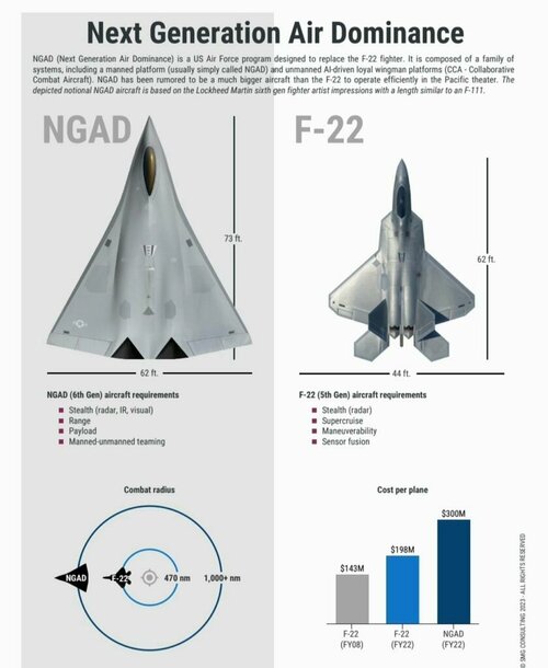

This graphic is probably the best example I have seen. Very big internal fuel capacity. I wouldn't be surprised if the fuel capacity is over 20 ton.
It probably won't be the greatest dogfighter at very low speed. But it is very easy to sustain 9G at high cruising speeds.

With the NGAD design I posted above the wing is blended into a thick wedge. This would be incredibly strong while providing good internal fuel volume. It would not surprise me if NGAD could pull semi-automated 10+G 90 degree high speed turns for these evasive maneuvers.
