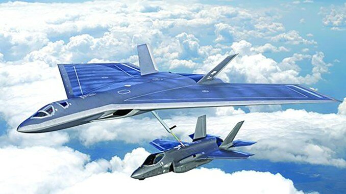

In regards to B-21 air to air concept. Let's assume USAF, by means of stealth and EW, maintains monopoly on first look first shot first kill for the next 40 years, air to air engagement is still not 1 on 1 battle. Every time you shoot you also make yourself vulnerable. The enemy gets x amount of data on you because 1) you open your weapon bays 2) your missile isn't stealthy in infared. At some point, maybe after your 5th kill, the enemy can zero in on you to force engagement. The need for beyond visual range to maneuver out of enemy's no escape zone is still important in order to disengage and re-engage on your own terms. That requires speed and agility.
I'm not buying this subsonic bomber carrying massive amount of air to air missiles concept.
I'm not buying this subsonic bomber carrying massive air to air missile concept.
The advantage of the B-21 could be in the very high altitude capacity to shoot at the horizon very far than the AA fighter and defense, for the satellite capacity able to do that and that blabla , don' t forget of the ASAT weapon , if a ennemy disable the satellites you have zero capacity of action so a piloted plane stay the better option to fight. Imagine in a high end conflict explode a nuclear warhead in high altitude and with the electromagnetic wave all of your UAV fall on the ground...... Data, electronic , sensor etc are not the holy grail of war.

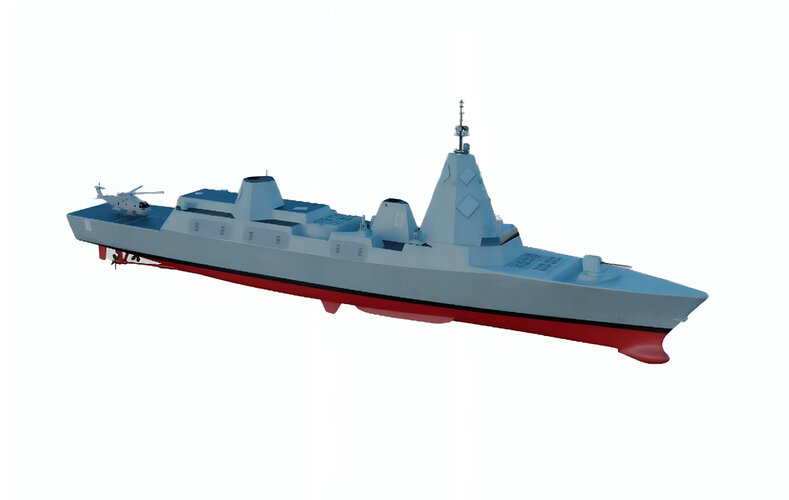

Three programmes come to mind. First, the (delayed) DDG(X), second, the British Type 83 destroyer, and third, Japan's Missile Defense Ship. I predict that the next generation of destroyers will have a role expanding from air defence of a fleet/group to air control and dominance. This will include ballistic missile defence as Japan's ship was originally envisaged, but now also broader air control.
It may be that the USN DDG(X) will emerge from its delays oriented more towards a design that is focussed on aerospace awareness and effectiveness. What little we know about the UK's Type 83 is that it too, like the Type 45, will be focussed on air awareness and defence, with a further capability to deal with ballistic missiles. The design concept that has been so far with the multiple bays for commando boats may be outdated (see attached). Fewer boats, more SAMs and lasers.
With their emphasis on battlespace awareness and control, these ships and might succeed aircraft carriers as capital ships.
