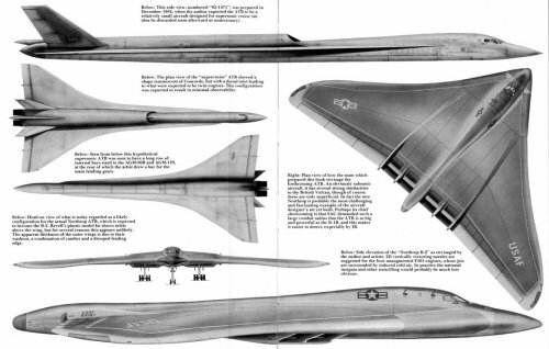

Would be like most ATF artwork in the 80s having a canard, Rafale, Eurofighter, Gripen, Mig 1.44, all get canards, then none of the actual ATF concepts have canards.
Huh? Many early ATF concepts included canard configs

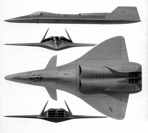

Ok, got it, i overlooked the "actual" word in your post. Anyways, i was thinking it's easy to get hyped over the futuristic depictions we've been fed for the last 13 years decades, but at this point, i don't really care anymore if it's tailless or not, after all, maybe the tradeoff of a bit smaller RCS over stability isn't worth it. For example, Carlo Kopp was predicting similar notional fighters since the 80's, and the final product was something more traditional in appearance. History repeats itself it seems:
apa-jpg.44952

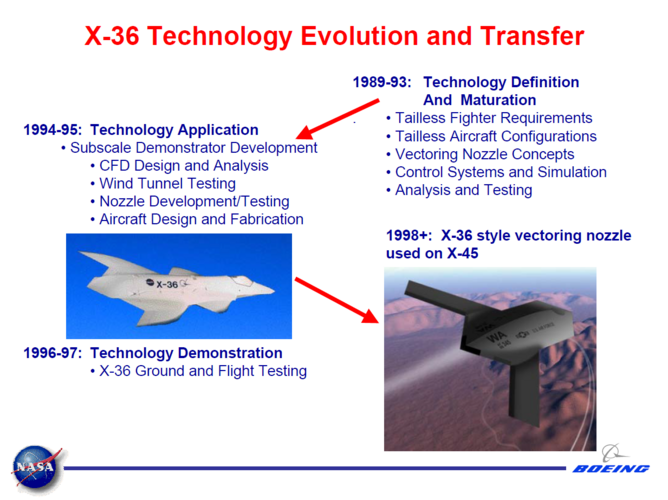

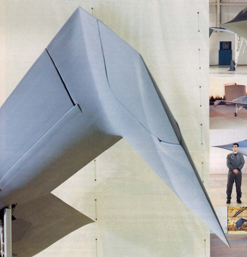

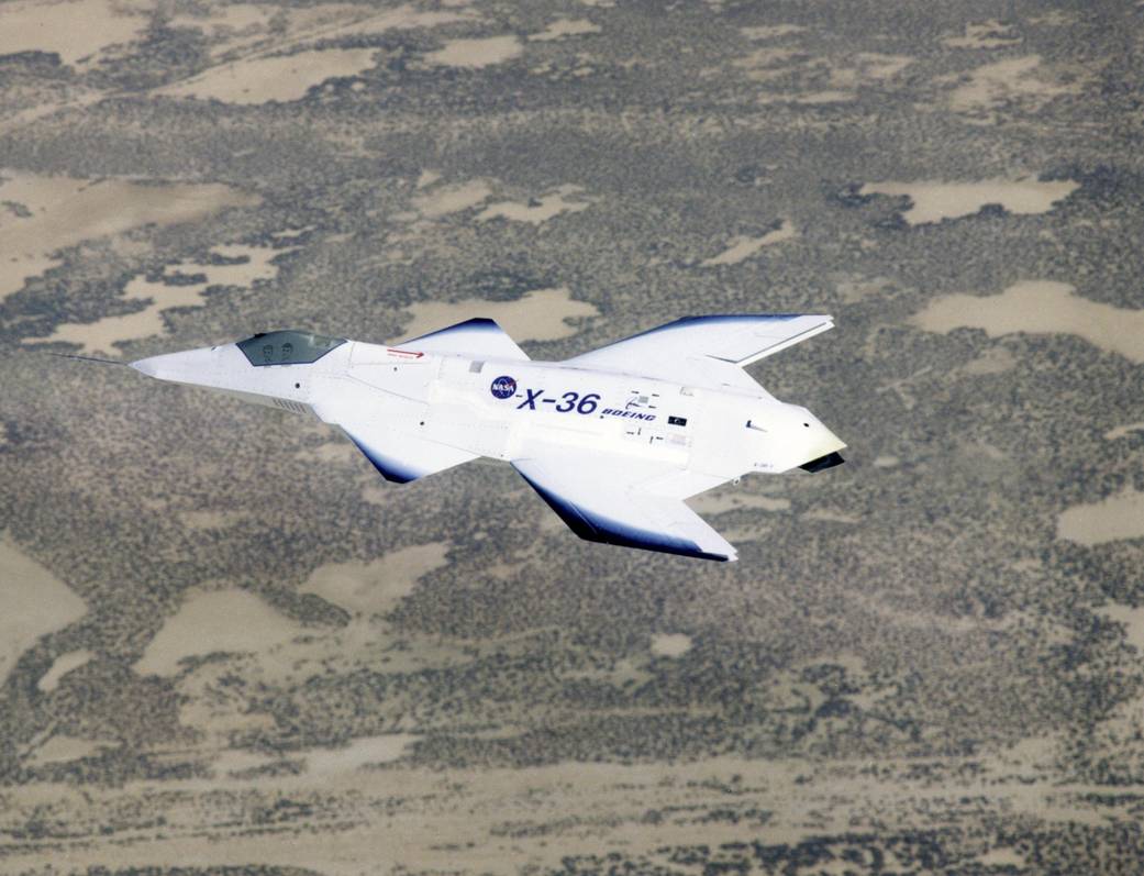

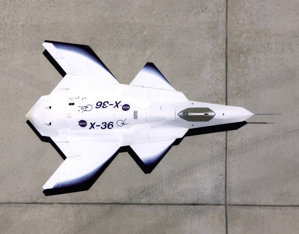

The (successful) X-36 demonstrator which flew 25 years ago, had canards and no tails.
Re-read what I said.
apa-jpg.44952
That top one was from back when they thought "swoopy" mean stealthy.
Yes but it had the split flaperon like the b2 ton make up for lacking a tail. Idk if that's a performance penalty or not to maneuvering but I would lean towards it being a penalty for a fighter to have a flight control surface that could be used for maneuvers acting as a drag surface. Someone else who knows aerodynamics is better to remark.
The program manager Gary Jennings is on record saying it was more maneuverable than a hornet. How much of this is company spit polish is debatable, but the program was regarded as a success in all aspects it set out to achieve.
Also, X-36 was unstable in pitch & yaw and had fluidic advanced (*) TVC (yaw only).
(*): edited/corrected
From Flight International, March 1996:
"The aircraft's fly-by-wire FCS will integrate control inputs, using split ailerons and a still-classified thrust-vectoring system to compensate for the absent tail surfaces. The thrust-vector nozzle will provide the initial control input until its limits begin to be reached, at which point the split ailerons will gradually take over. "
"Three ailerons are mounted on the trailing edge of the wing, which is sharply "cranked" towards mid-span in the familiar low-observable characteristic of recent stealth designs. The two outboard sections function independently and split to provide yaw control (using drag), while the inner section acts like a "typical flaperon", for pitch and roll control"
Foreplanes were added to increase pitch-down control authority and move through +10¡ to -80¡ to compensate for the large pitch-up moment generated by the chined fore-body at high angles of attack. "They needed to be large to help destabilise the aircraft"
"The thrust-vectoring system, which was hidden from view during the roll-out is based on a design proposed by MDC engineers in 1989"
"It is understood that the system deflects engine exhaust in the yaw axis only, probably through a set of vertically mounted vanes. The gases exit through a flattened exhaust nozzle, which is recessed slightly beneath the aircraft's broad "beaver" tail."
"This Tailless Fighter Agility Research Aircraft demonstrated the feasibility of future tailless fighters to achieve levels of agility superior to today's best military fighter aircraft."
"In a follow-on effort, the Air Force Research Lab (AFRL) contracted Boeing to fly AFRL's Reconfigurable Control for Tailless Fighter Aircraft (RESTORE) software as a demonstration of the adaptability of the neural-net algorithm to compensate for in-flight damage or malfunction of effectors, i.e., flaps, ailerons and rudders. Two RESTORE research flights were flown in December 1998, proving the viability of the software approach."
"It
was designed to fly without the traditional tail surfaces common on most aircraft. Instead, a canard forward of the wing is utilized, in addition to split ailerons and an advanced thrust-vectoring nozzle for directional control. The X-36 is unstable in both the pitch and yaw axes; therefore, an advanced, single-channel digital fly-by-wire control system, developed with some commercially available components, stabilizes the aircraft."
Edit: Fluidic TVC was NOT used on X-36, therefore info below changed to a smaller font
More about fluidic TVC (research):
Hmm... I just carefully re-read everything I posted & linked above with regard to the X-36, and also googled a bit around, but nowhere I can find the word 'fluidic' with regard to the X-36´s TVC-control. Everything (now) only seems to mention 'advanced TVC-system' at most.
Does anyone else remember the X-36 for (being described as) having/using some form of 'fluidic TVC'?

Here is a proposed hybrid approach to solve the stability problem on a further iteration of Lockheed's ESAV, funny how they came with a creative way of recycling the MANTA acronym one more time:
Abstract:
Tailless aircraft offer advantages such as increased aerodynamic efficiencies through reductions in weight and parasitic drag. However, the advantages associated with the removal of the vertical tail are stymied by a loss of stability and control authority, which is particularly detrimental during the low-speed flight regime of take-off and landing. To address instability issues and reestablish control authority, this study explores the addition of an articulated “tail” to a tailless aircraft, instead of a vertical tail. As a conceptually designed aircraft, the Multi-Articulated Nodal Tailed Aircraft (MANTA) concept is investigated using the Air Force Research Lab’s Computational Aircraft Prototype Syntheses (CAPS) system.
View attachment 677659View attachment 677658
Amazing what comes back into fashion after 150 million years!
