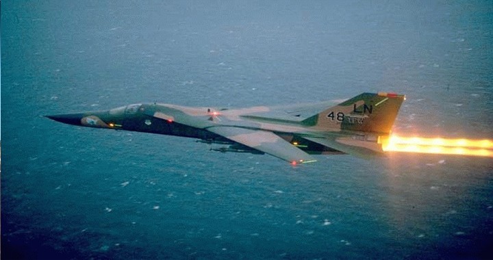

What really is needed is a F/A-XX like the F-111.
Given the number of threats 2030+ CAS "plinking" and CAS supporting SEAD will need to be near simultaneous and accomplished by the generally the same the craft
If there are dedicated pure SEAD supporting Deep, Medium range (BAI) and Close battle (CAS) they would need to carry as many UAS/msles as possible internally and/or stealth conformal ..but these craft would be required to attack vehicles as far from troops as possible as well (Assaultbreaker/Warbreaker like).. so not pure SEAD either. The end of pure SEAD as a mission the new emphasis defeating APS and Counter-PGM at standoff takes ex/internal space and volume for these munitions.
The F-111 was the first turbofan so if these ADVENT Turbofans w/ advanced bypass are all that a F-111-like size/weight FBA-XX needs. Modern wing and material science could allow an F-111 size plane to even possess decent maneuver and at speed. Yeah F-111 tried to do too much for too many but it taught alot.

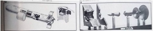

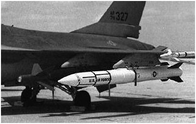

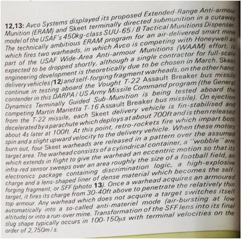

The T-16 carried something better than BAT. If DARPA is bring back Warbreaker, the an FA-XX should be carrying RPA/missiles which carry RPAs/missiles and improve on the ERAM concept with more miniaturization and high energetic for explosives and munition range.
