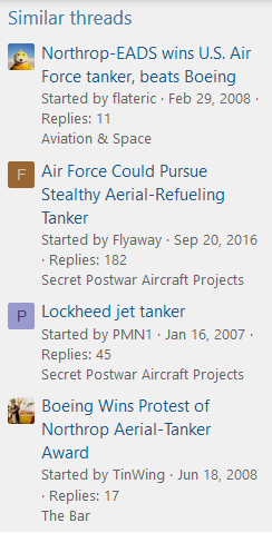

EDIT - that forum software has just proposed some old threads, related. Clever girl.
2007, 2008... see attached screen copy. Another irony, thanks this forum.
THIRTEEN YEARS - June, 18 2008.

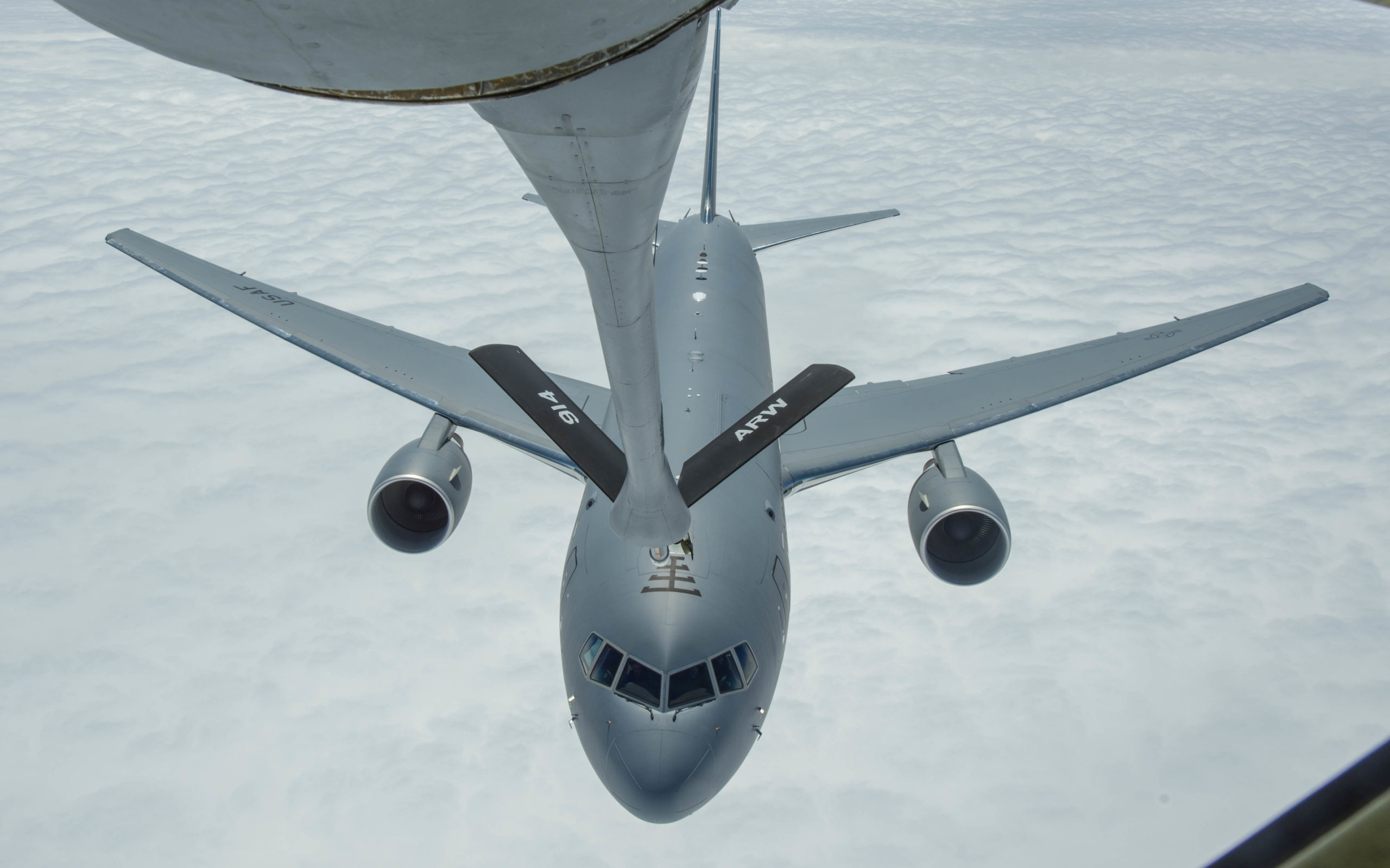

Why is there a new tanker program when KC-46s are just entering service?
I think the KC-46 might not be around for as long as the KC-135 and the USAF want to start designing the future tanker right now so at least there is going to be a follow on tanker to replace the KC-46 when the time comes.
This isn't procurement of a new tanker aircraft. Rather it is a modernization plan for the KC-46 and KC-135 to improve survivability and networking, as well as implement more autonomous capabilities.

The EW is for primarily self defense. The KC-46 already has a RWR and networking capabilities via Link 16, and there is a roll on networking kit for the KC-10 and KC-135.These systems may take the form of pods or could be a more significant modification, probably both.
The reality is that a lot of the kinds of operations the USAF is looking at will place their tankers uncomfortably close to the threat, and the aircraft need to be able to survive there. The KC-46 gets partway there,but it was explicitly designed for a medium threat environment composed mostly of medium range SAMs and fourth generation aircraft. Being able to survive against double digit SAMs and fifth generation aircraft requires a dramatic increase in capability.
This also makes the tanker an excellent platform for acting as a network node for ABMS, which is also included in this solicitation.

KC-46 c.93 tonnes. A330 MRTT today c.111 tonnes.
@Jackonicko : At mission range, both can offload the same amount of fuel. The A330 airframe is slower at cruise, heavier and probably a bit more draggy.
Hence more of its carried fuel is for its own consumption. This is why LM want to increase the mass fraction of fuel to give a positive delta regarding the KC-46. However, Boeing maintains that it can match this increase in a lighter weight package (because, again, having less mass, less drag, and being faster at cruise...).
At the end, if the mission profile stays the same,
it's even more advantageous for the USAF to keep their KC-46 and move toward a block upgrade since fleet cost will be impacted favorably.
LM & Airbus have to disrupt the end objectives one way or another if they want to win. The extended range was one way of doing it but sadly not enough. They need to push the envelope (not the one under the table, obviously) even further, that it'd be with range, embedded systems, basing facilities, cost or whatever I don't know.
