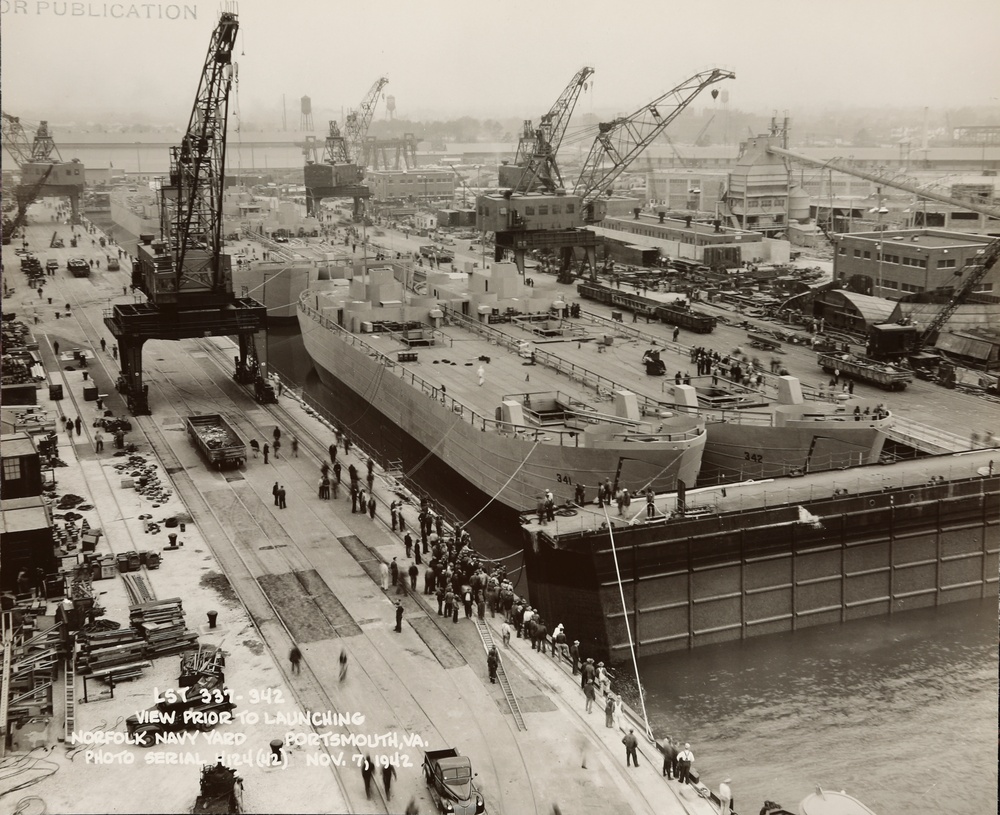

A couple questions arise. What is the manpower situation? Do you have trained skilled people to build these ships? Trained skilled people to crew these ships? What/s the supply chain situation all the way back to the mines in Mesabi? The European was was figured to be over by mid=1945. You will need ground troops for occjupation forces, but the Battle of the Atlantic is over and those ships can be moved to the Pacific.
These two videos, while hardly perfect, give you some idea why in the postwar world the British were having difficulty--aside from money--getting ships upgraded.
