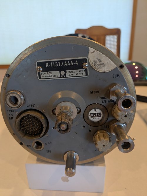

Follow-up on AAA-4. I believe this was either an Avion Model 333 Automatic Search and Point system or a derivative thereof. The description of the 333 ASP aligns with the physical characteristics of the extant examples of AAA-4 that have appeared online, and aligns with the reported performance of the unit. Avion was developing the Model 333 ASP at the same time that the Aero X1A fire control system was being developed by the USN, and Avion was one of the contractors selected to develop an IRST. The dates of the relevant reports here being only a few months apart make me confident that AAA-4 is a 333 or 333 derivative. I will follow up with the Smithsonian to see if they have any records from the Avion division of ACF Electronics.

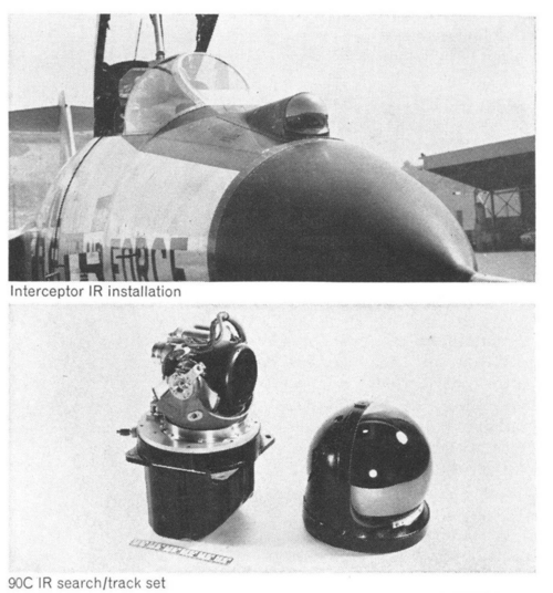

Early in this period the replacement for the ASG18 Search Track Set was being developed by Hughes with SBRC supplying the lead selenide cross array detector and the liquid N2 transfer cooling system. This detector was installed on a stern which fit in an outer dewar. This arrangement (called a double-barreled dewar) allowed the dewar to be outgassed at high temperature independent of the detector. This program finally led to the 90C, 100C, and the Swedish 71N systems. By 1962 the design was qualified and production started. At first Hughes Tucson had difficulty with these detectors and returned many of them. When we finally got to the bottom of the problem, it was found that the drawings called for a precision honed inner bore. The Tucson inspector was using a solid plug gauge to measure the internal diameter while we had checked it out with a ring gauge, which did not guarantee that the hole was precisely straight. The detectors were returned as being open circuit after the inspector had pushed hard enough on the plug to break the glass in an effort to pass the unit. All this trouble and expense for a hole that only had a hose glued in it! Generally, this detector production went very well and the program had a long life.

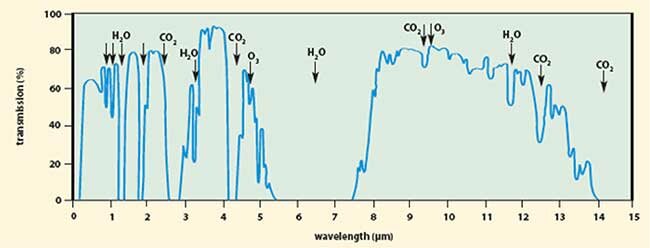

Yes, for best range in rear aspect on hot tailpipe, 1-2 microns, uncooled PbS is hard to beat. Uncooled PbSe doesn't seem better.
I'm not seeing why cooled InSb is better than cooled PbTe or PbSe from these graphs though.
It's consistently slightly more sensitive than PbSe, but those graphs are super inconsistent based on the time that they were made. InSb was supposedly hard to make right for a while, though I don't know how legitimate that claim is because it's "word of mouth" from someone in the industry.
