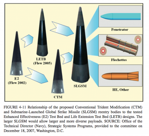

Sometimes being in the crater is not enough. I remember a photo from back in the 80's in an Air Force Magazine article of a superhard silo that had undergone a test. The silo had been hardened to 50ksi and was shown protruding -intact- from the bottom of a crater formed by high explosives. Granted, maybe if you're close enough you can make the crater deep enough to tip the silo over if nothing else but still. . .
But with accuracy like that you wouldn't need more than "tens of kilotons". We should research and build low yield earth penetrating nuclear warheads, we could call them Robust Nuclear Earth Penetrators...........oh wait nevermind :-\
bobbymike said:
What intrigues me is not the first part of the quote (which illustrates the power of speed in the kinetic energy equation) but the second part, "very close to the aim point"
It either intentionally or by accident tells how incredibly accurate our SLBM warheads are if the target can be withing the impact crater "without" any explosives.
"The E2 evaluation was conducted in October 2002 using a D5 missile. The modified Mk4 reentry body had an added flap actuator system for control and a GPS-aided Inertial Navigation System (INS). During a substantial part of reentry, GPS reception was lost owing to a plasma-induced blackout. Nevertheless, the flaps deployed and operated as predicted to provide three-axis flight control (roll, yaw, and pitch). Under flap control, the reentry body (RB; see footnote 5, above) was able to turn to its target, and guidance and control were sufficient to steer the RB to the target within several meters of the onboard navigation solution. In other words, the RB came within several meters of where the navigation system calculated that the target was located"
The E2 and LETB flight tests had inert warheads and had a CEP about that of a JDAM.

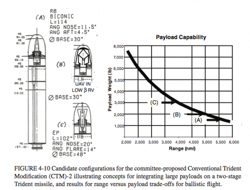

More interesting is what was proposed for CTM-2. Interesting little UAV stuffed in there.
A 6000lb penetrator for 2500nm is nothing to sneeze at.
The largest (total) payload for CPGS I have heard of is 2000lb.
quellish said:
Look at the bottom pic you posted.
quellish - Is there a report that goes with those two images you posted up the thread?

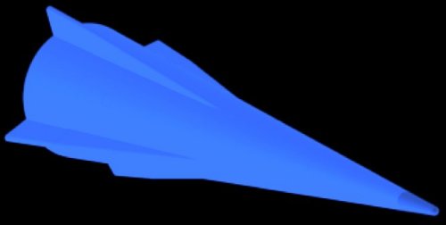

What USAF wanted to do was take HTV-1 and use it as a delivery RV that would deploy standard conventional munitions - CBUs, GBUs, SDBs, LOCAAS, etc. There are some indications that after HTV-1 was cancelled it lived on in another program. Interestingly enough, the CSM flight demonstration was to include a Payload Delivery Vehicle (RV) that had a "proven" design.
As far as boost glide weapons.... AHW is the only thing on the horizon that can fly the trajectories being proposed (using a STARS booster). AHW is somewhat derived from SWERVE.

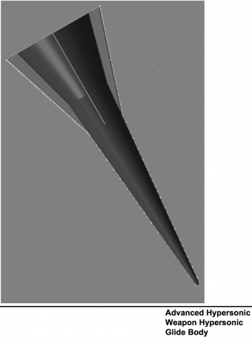

The part people are probably mostly interested in:
bobbymike said:
Will this tell us who has the best engineers, Army, Air Force or DARPA?
Sandia is heavily involved in AHW, and the design leverages their experience with SWERVE and other vehicles.
From: http://www.smdc.army.mil/Contracts/D3I/D3I-IndustryDayBriefing1Mar2011v1.pdf
AHW Mission Statement:
"Support the Test and Warfighter Solutions Center Mission Objectives in the design, development, and flight test of the Hypersonic Glide Body, based on existing technologies
derived from the Sandia Winged Energetic Reentry Vehicle Experiment (SWERVE), the Tactical Missile System – Penetrator (TACMS-P), and the Strategic Target System (STARS), to demonstrate a possible solution to the Conventional Prompt Global Strike (CPGS) requirement"
