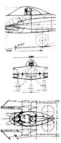

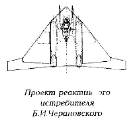

Very bad top view scan from Sobolev's book on the flying wings. (A good 3V can be found in Rose's book "Secret Projects_Flying wings and tailless aircraft", page 132).

I don't think, that "stealth" question was very important in 1944. Fact, that plane is similar in shape to modern B-2 or something doesn't mean, that its desiger wanted to make it invisible to radar. Finding solution for aerodynamical problems - it was main reason for design plane like this one.

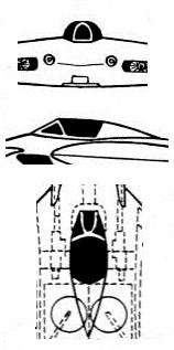

Hi, mrys,
Just a slight modification in the canopy shape and frame,
Drawings, you attached looks like drawings from Soviet X-Planes book from 2000. But in Soviet Secret Project (from 2005) you can see much better and accurate (means: all three view perfect match each other) drawings with all basic dimensions marked and with canopy shaped exactly like in my model.
Indeed,
I am just wondering about a one piece full teardrop canopy in 1944.
Nervermind, wonderfull artwork, mrys!

I'm puzzled for the wind is a "delta" but it has a "normal" wind in the end. Why?
Those are more like flapperons than wings. Maybe there was concern the flapperons would be ineffective behind the big delta and so have to stick out into clear air stream?
About the canopy, I think, the shape shown by Retrofit in #7 would be a little bit less elegant,
but more plausible. The type somewhat reminds me on the General Aircraft GAL.61 .

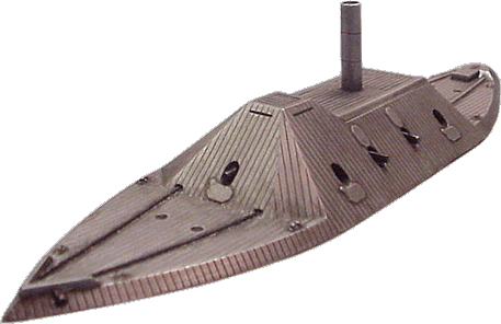

But I think, we shouldn't start discussions about "first stealth fighters" here, I still have bad
memories about the ineffable one with regards to the Ho/Go 229 ....
Just think about depriving USN Sea Shadow of the title "first stealth ship", because there already
was this one : ::)
(from http://www.cityofart.net/bship/tennessee.html )

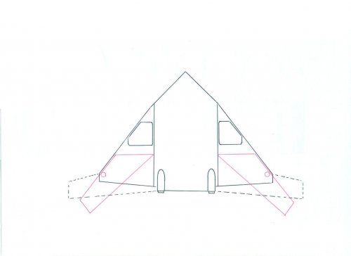

I doubt they are flapperons because if they are this aircraft lacks an elevator which means it will have no pitch control. Perhaps they are elevons but such a design in an aircraft without some sort of flight control computer has to be a bit out there. Anyway its great artwork and a very interesting subject even if I’m not quite sure how it will achieve controlled flight.
Justo Miranda said:
Variable Geometry?
Now that's a sensible interpretation. Is there any trace of a pivoting axle in the original diagrams?
No, no trace and I think that it is only interesting overinterpretation. We are discussing about project, that never was nothing more then concept on paper. In early stage of developing. I don't think, we should develope it without author's permission :) Most of projects would never fly.
