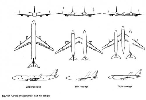

when I was searching in my old staff,I found this drawings to Boeing 747,with single,twin and triple fuselage,
and I don't remember from where file,may be NASA report.
Interesting find, hesham. Given the low resolution of the drawings themselves, it's hard to tell, but it looks like the one on the left is a stretched 747 with a full-length upper deck.

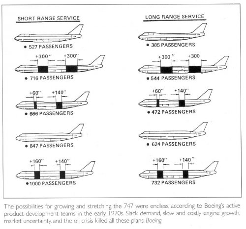

I'm not sure it's the same animal, but it reminds me of the reports of the four stretch designs from April 1973, one of which had a stretch of 160 inches forward and 140 inches aft, and a full-length upper deck. That could carry 624 passengers.
Thank you Carsinamerica,
and for this later design,I never heard about it,look great,do you have a drawing to it ?.
Hello Hesham,
The only interpretation I've ever seen was this sketch, which has been published in several books on the 747. It turns out I had the wrong numbers, though: the stretched double-decker carried 732 passengers on long-range service.
What I would dearly love to know about any of these four proposals is this: did Boeing intend to use the same wing on these stretches? The drawing seems to imply that the wingbox stayed the same, but I cannot imagine how, for example, the 50-foot stretch variant could possibly use the same wing and engines as the 747-200B, not if they wanted it to fly appreciable distances.
These drawing still boggle my mind. That first stretch proposal is even larger than the 1996 747-600X, nearly three feet longer! It's the largest 747 proposal I know of.

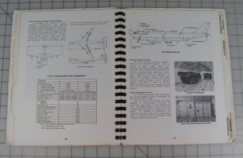

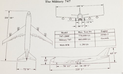

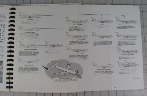

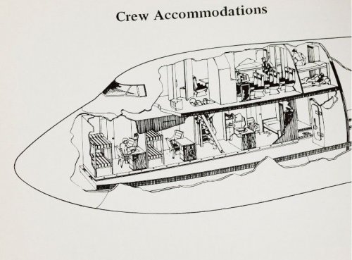

Boeing 747F Near-Term Airlifter proposal to the US Air Force, dated March 9,1981, found on eBay.
A fascinating piece, 79 pages packed with great text, photos and charts. To quote from the Introduction, "Boeing supports planned airlift improvement programs including a re-winged C-5 force with development of a C-X aircraft with outsize cargo and austere field capability. The timing for these new programs is sufficiently distant that a near-term augmentation of the current airlift force is considered necessary." This will make for a great addition to your collection, so bid now! Please feel free to email any questions that you may have.
http://www.ebay.com/itm/Boeing-747F-Near-Term-Airlifter-Proposal-to-the-US-Air-Force-Dated-March-9-1981-/201177175457?pt=LH_DefaultDomain_0&hash=item2ed71815a1

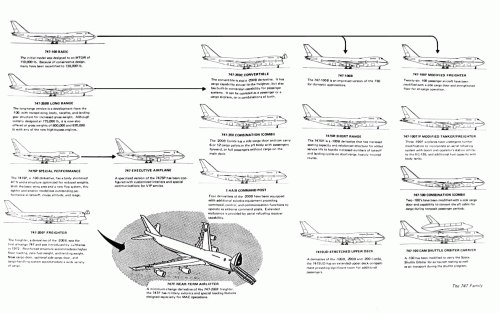

Enhanced from 7th attachment above, the 747 family:

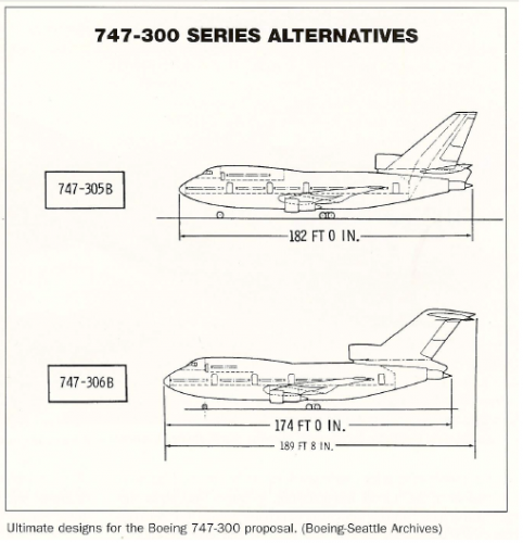

here is the Boeing 747SP with its two variants 305B and 306B.
Hi Carsinamerica,
the source is the book, Great Airliners; McDonnell Douglas DC-10
From the book; Boeing 747. Design and Development Since 1969,

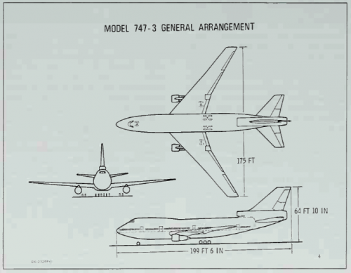

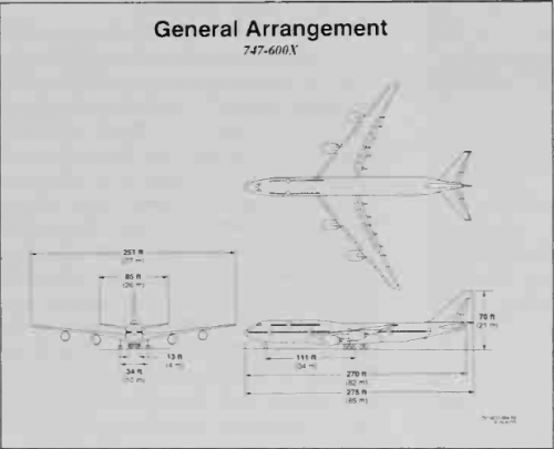

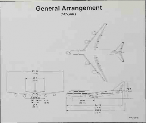

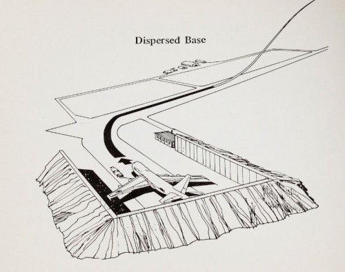

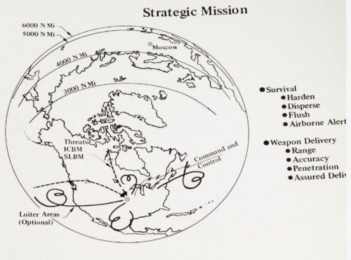

here is the Boeing Model-747-3,Model-747-500X and Model-747-600X projects.
