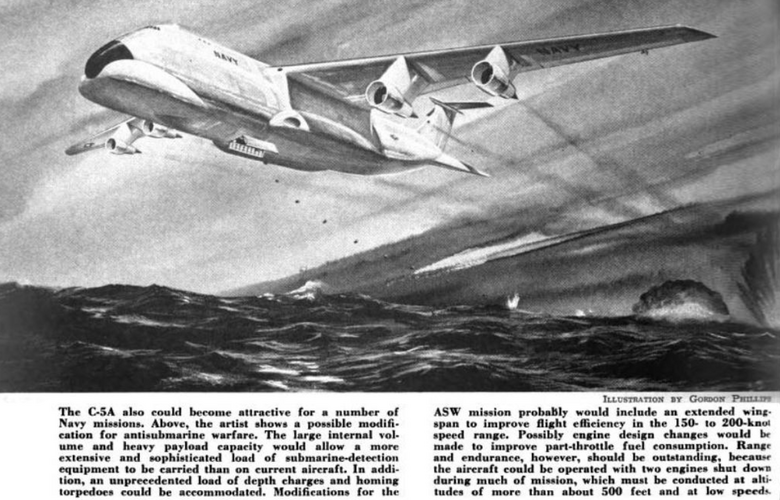

Gordon Phillips' artwork comes up a lot in Air Force and Space Digest articles. Anyone know if he was a USAF artist?
I wonder if he was the same Gordon Phillips mentioned at this link. The dates seem right, but the subject matter is different. I vaguely recall that we've seen some other Western art with the same signature elsewhere on this site.
If so, the aircraft art could be examples of commercial art done for hire, probably by the aircraft manufacturers.
Edit: My mistake; the artist I was thinking of is Allen A. Adams.

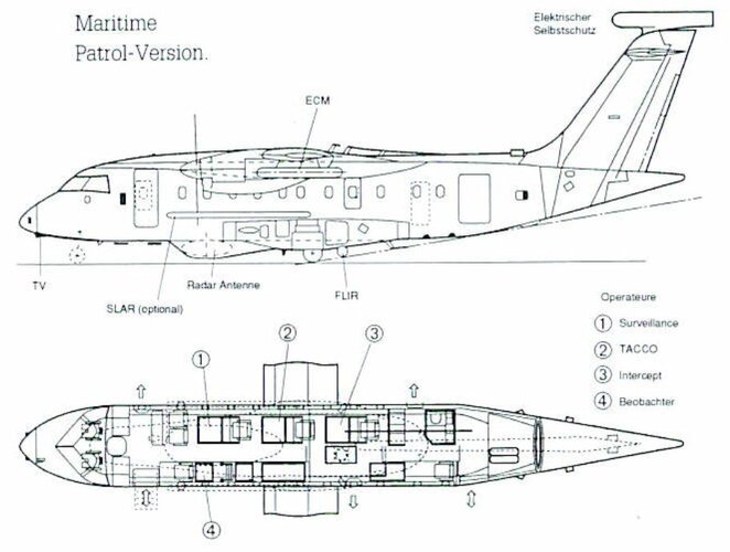

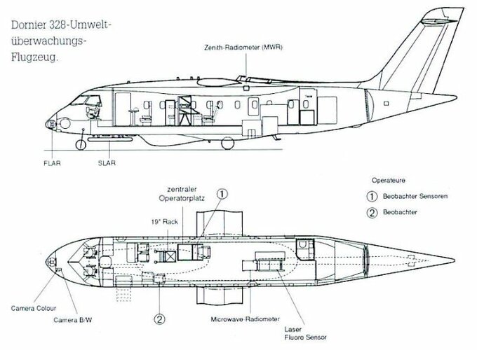

If they're turning it into an MPA, then the Magnetic anomaly detector gear gets installed in place of the 3rd engine, with sonobuoys in place of the rear airstairs.

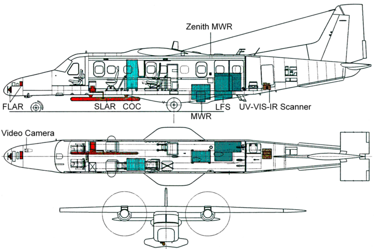

Maritime patrol version mainly for environmental surveillance, I assume? The Microwave radiometer suggests weather applications.
Yes
The equipment is identical to the Do 228 LM, used by the German Navy for pollution control and enforcement of the maritime pollution convention.
The German Wikipedia article on the plane is very detailed and describes the use and origin of most of the devices.
