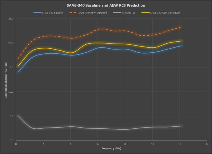

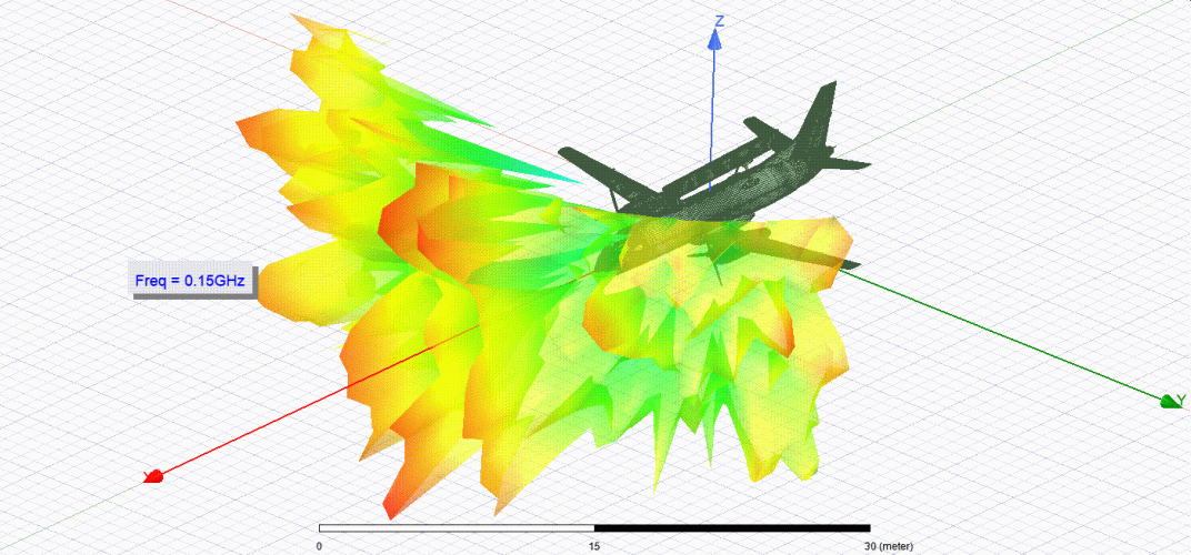

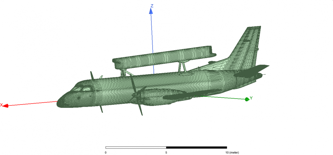

AEW tho is a big target. Back in the day i made estimate of the SAAB-340 AEW RCS.
The AEWInteractions
Which include the Erieye. 12 frequencies were modeled from VHF down to X-band. Result wise, compared to baseline SAAB-340, the RCS for AEW variant is about 6% higher.
Considerably less than what i expected (1.6 times or 160% based on what i did for a hypothetical A-320AEW) Still, 15-20 Sqm from VHF to X-band is kinda risky.
