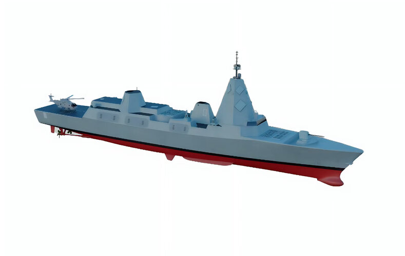

Because it is still in the pre-concept phase, there are no official images yet, but based on an image that emerged in a 2023 naval conference which has since been the unofficial default,
The concept reveals a ship comparable in size to the Chinese Type 055 Destroyer (which is around 12,000 tonnes) and armed with a five-inch main gun, Phalanx Close-In Weapon Systems, two 30 or 40mm guns and additional unidentified close-in weapons systems, plus a significant missile payload. The missile payload seems to be divided into two sets of Mk 41 vertical launch system cells, each holding an estimated 64 VLS, resulting in potentially 128 missile cells per ship.
I'd probably add a couple of lasers to that now.
Depending on the upcoming defence review and inevitable cost cutting, the designers might look at its functioning as part of a task force and focus on the air defence role and leave other tasks to the frigates, carriers and MRSS, so it may not be as versatile as the initial concept.
To save scrolling back, here's the artist's impression:
Hmmmm. All quite hush-hush in terms of its details and only a possibility being considered, I hasten to add. The Type 83, being the next large surface combatant proposed for the RN, is a candidate as it's still in the 'lets see what industry can do' rather than actual development stage.
