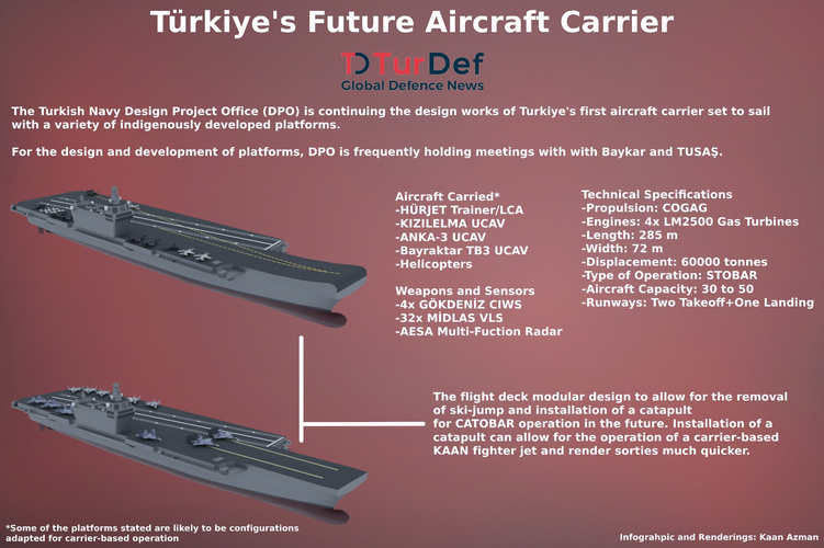

Hrm. Between the two designs shown, my recommendation for the Turks would be the one with the angled deck. So that if/when you put a catapult or three onto the thing, you have less rework to do.
I think the modular design and the space for the possible catapult adition are for in case they decide to go for a Naval Kaan. Otherwise both designs seemingly have two different conops altogether. They'd probably go for the revision during the MLU around 2050+, which makes a lot of sense.
By the time the construction begins, it'll be 2030s already and 2050+ by the time of the MLU, so you gotta expect the unexpected and prepare for it.
But in the meawhile I'm satisfied with Naval Hürjet, Kizielma and Anka-3. You'd have a deep strike capability with Anka-3 and a LW with Kizilelma already, so you don't need a stealth fighter on top of this if you're not trying to take on China.
Also, acc. to a Naval Architect in an another forum; the design without the angled deck is probably the old design, not a competing design.

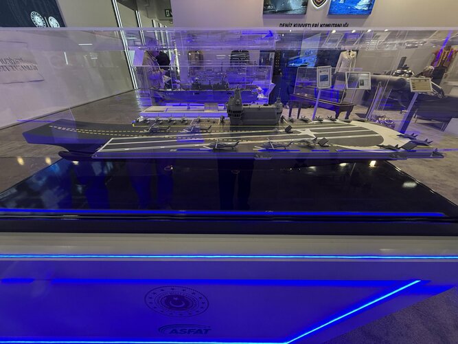

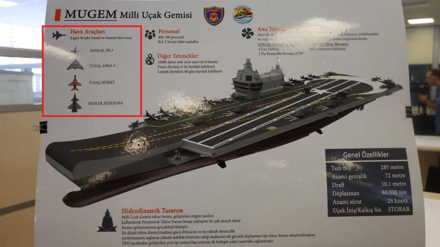

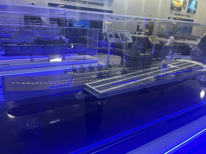

MUGEM aircraft carrier
View: https://x.com/T_Nblty/status/1827690726358127069
Source - https://www.trthaber.com/haber/bilim-teknoloji/mavi-vatana-milli-ucak-gemisi-geliyor-874479.html
MUGEM (National Aircraft Carrier)
Aircraft​
Minimum 50 manned and unmanned aircraft
  • Baykar, TB-3
  • TUSAŞ, ANKA-3
  • TUSAŞ, HÜRJET
  • Baykar, KIZILELMA
Personnel​
  • 400-500 personnel
  • Role-2 Level Medical Facilities
Other Capabilities​
  • 10,000 nautical miles range at 14 knots (6104 km)
  • Maneuvering ability in sea state 6 and higher
  • Logistic support capability with two helicopters
Main Propulsion System (ATS)​
The main propulsion system has high reliability, performance enhancement, and cost-effective COGAG configuration.
  • COGAG Configuration
  • Bow Thruster: Easier docking
  • 4 Gas Turbines: High maneuverability
  • 2 Variable Pitch Propellers (CPP): Efficient maneuverability
General Specs
  • Full length: 285 meters
  • Maximum width: 72 meters
  • Draft: 10.1 meters
  • Displacement: 60,000 tons
  • Maximum speed: 25 knots
  • Aircraft Landing/Take-off System: STOBAR

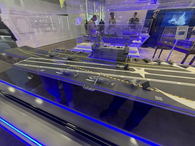

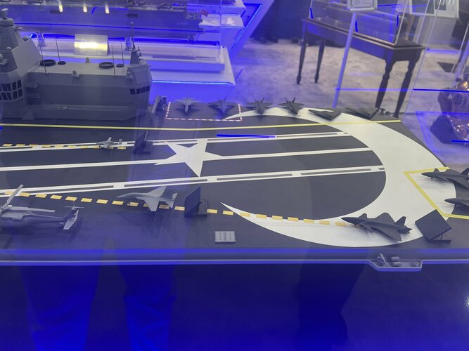

Looks like it will have 4x MIDLAS VLS total 32x cells and 4x GOKDENIZ CIWS for self defence
Kinda strange to think that a carrier the size of a Midway needs a ski jump for modern aircraft...
I suspect that the Turks will discover that they need a higher efficient-cruise speed for their carrier, so it can do flight ops at cruise speed instead of at a sprint. More like 21-24 knots, not 14.
Well, without catapults, you need some take off assistance. British and Russian carriers of similar displacement have a ski jump. The lighter Italian and Spanish ones as well.
They are advertising the possibility of switching "easily" to a flat deck + catapults in the future.

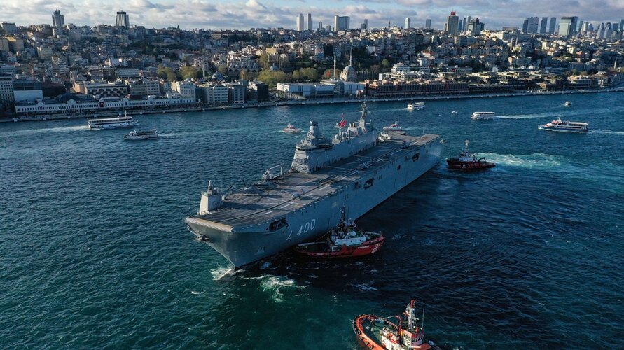

Which leads to the question of the Dardanelles and the strait of Bosporus!
Does the Turkish Navy's own carrier allowed to transit there?
Does the 1936 Montreux Convention which is still in place has an article regarding any Turkish aircraft carriers?
Both this ship and the LHD(s) of the Turkish Navy are going to be based in Aksaz, which means that they are procured for operations that are out of Turkey's strike range. So imagine Eastern Central Atlantic and (primarily) the Indian Ocean.
If these ships were procured for operations within Turkey's means of force projection and reach, i.e. East Med and the Black Sea, they would've been based in Istanbul instead.
Reading the text, it's not 100% clear but the purpose of the Convention was to largely return sovereignty over the Strait to Turkey, so I suspect Turkish vessels can pass unencumbered by the convention.
Where it based what it's planned operational zone is two different things. They can easily relocated or redirected for a black sea mission.
Yavuz was always heavier than 15000 tons, nobody has ever said Ex-Goeben could not sail into the Blacksea after 1936.
Much impressed by the planned operational area of Atlantic. Of course they will silently snicker it is all about impressing the Moroccans for some reason but l guess the secret open reason is shadowing the likes of Iranian Makran after the pivot to the Pacific...
There's a clause allowing single ships larger than 15,000 tons to transit one at a time anyway, with two destroyers as escort. (Article 11)
Battleships and Battlecruisers were allowed passage, Carriers were forbidden (Hence the Moskvas, Kievs and Kuznetsovs was designated aviation cruisers.
Actually looked it up and found one source in full legal terms 1936 style. 11 basically stops any moves to legally interdict Soviet Blacksea shipyards in production of capital ships. While 17 allows USN of 1945 to visit Istanbul with 2000 ships, 100 of them carriers. Or a fantasy Russian fleet of dozens of aviation cruisers visiting Istanbul as long as they return in the way they came.
Basically nothing stops us Turks. Trust me on this.

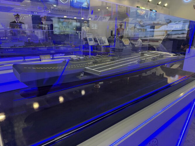

I'm a bit late to share this but the construction has started:
Latest update:
Director of Naval Forces Design Project Office Assoc. Prof. Dr. Colonel Uçar:
"In this way, we have also determined the propulsion power and propulsion system that the ship will need. We have carried out multidimensional maritime analyses to ensure that our ship can operate even in the worst weather conditions in the world's seas. We are working on the ship's three-dimensional layout plans. In order for our air vehicles to be deployed to MUGEM to safely perform take-off tests from the flight ramp, we first designed the land-based flight ramp. The construction of the test ramp is currently underway.
We are following the development of our national pride KAAN with great appreciation and wish to have it on our National Aircraft Carrier. KAAN was designed to take off and land from conventional runways. Special modifications are required for it to be able to operate from an aircraft carrier. We are continuing to exchange information with TUSAŞ so that KAAN, whose prototype production is currently ongoing, can take off and land from our ship in the event that its naval version is produced.
As a result of the design studies, the ship will have a displacement of approximately 60 thousand tons (the amount of water displaced), a width of 72 m and a full length of 285 m. The flight deck will have two take-off runways with 3 raceways and 1 landing runway. The short-range take-off and rope-catch system STOBAR for aircraft will also be installed. It will be able to travel 10 thousand nautical miles without refueling. In other words, it will be able to go from Istanbul to New York and back. It will be able to reach a maximum speed of 25 knots (45 km) with its main propulsion system consisting of 4 gas turbines. It will be able to perform sea missions with a capacity of at least 50 manned and unmanned aerial vehicles.

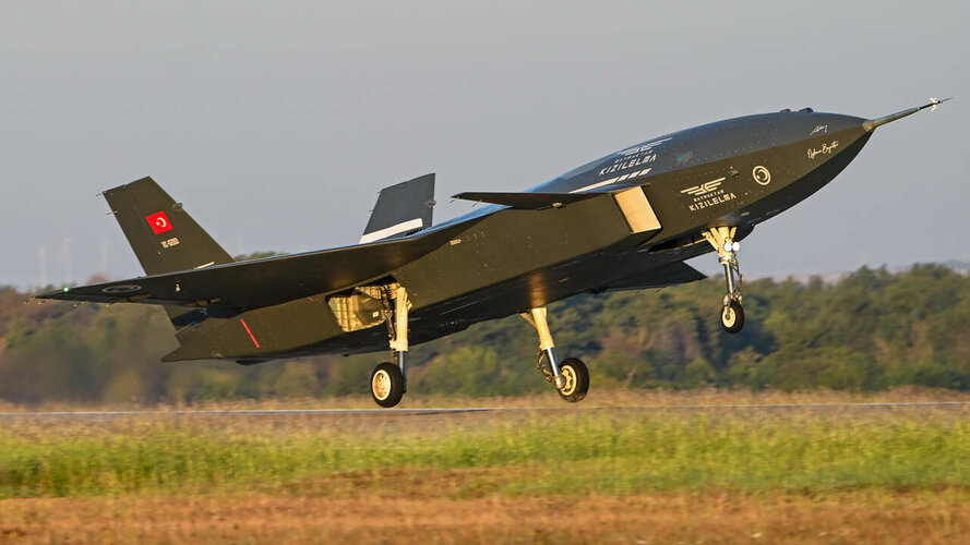

This the planned airwing:
1000004157-jpg.744946
One of these aircraft has just entered LRIP, and the other two are also nearing that stage. However, the Navy's pragmatism regarding the airwing of a ship that is still about 10 years away from sea trials has been a subject of criticism for some.

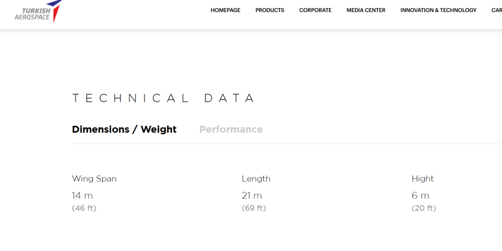

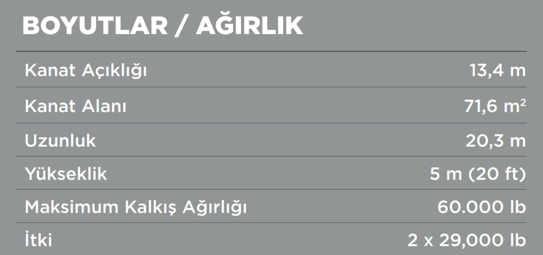

No, the revised dimensions were for P0, this misunderstanding was caused by people misinterpreting outdated data on TAI's website, which belonged to the early design whose mockup was revealed in 2018.
For the first time since June 17, 2019, the technical specifications were updated by TAI itself.
Wingspan from 14 meters to 13.4 meters
Lenght
from 21 meters to 20.3 meters
Height
from 6 meters to 5 meters
Wing area
from 70m2 to 71.6m2
Old
New
