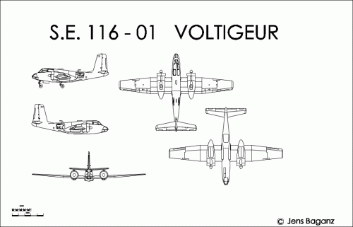

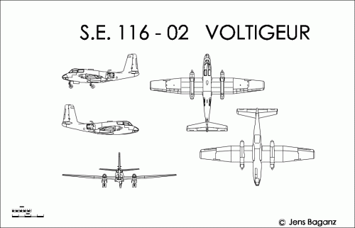

I think, we've still yet forgotten the SE.116 Voltigeur. The first prototype
flew with Wright C7BA1 piston engines, whereas the second aircraft was
fitted with Bastan turboprops. Interestingly, the more or less identical
SE.117 was finished with Bastan engines, but it was proposed, to revert to
the Wright engines later !

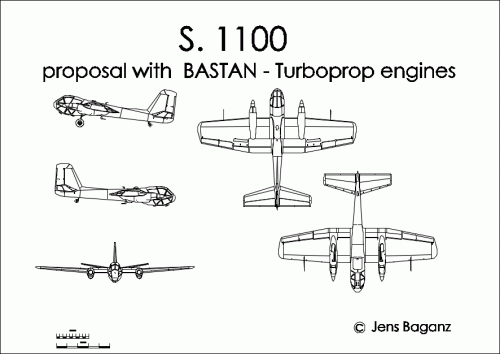

The contending SIPA 1100 flew with piston engines, but there was a project
to fit Bastan turboprops, too.

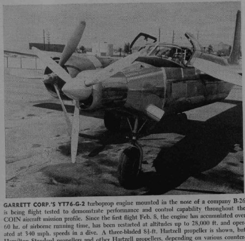

Douglas B-26 Invader/OnMark Marksman C testbed (N26GT, nose-mounted TPE 331)

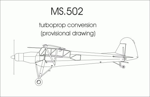

Morane-Saulnier MS.502 Criquet (Salmson 9 radial) [Conv] to MS.506 [Turbomeca Astazou]

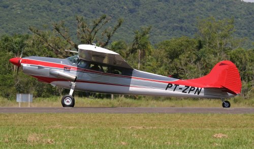

Cessna 195 [Conv] to TPE 331* (Brazilian 'Cessna 195-T' conversion, PT-ZPN)
-- * NB: shalonmelo (reply #224) claims a 600 bhp P&WC PT6A engine

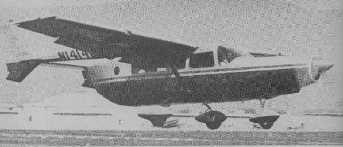

Cessna 336* (2 x IO-360) 1968 [Conv] to single-engined Conroy Stolifter
- Conroy Stolifter: 1 x 575 shp Garrett TPE331-25A tractor turboprop**
-- 1 x built (N1414G), aka STOLifter, aka 'Stol-Lifter' (sic)
-- * Some sources list as 'Cessna 337' (but note fixed u/c)
-- ** Rear engine removed, fuselage extended with cargo bay

SIPA S.1100 (P&W R-1340) [Evol] planned turboprop version (Turboméca Bastan).

Sud Aviation SE.116 Voltigeur (R-1300-C7BA1 Cyclone-7) 1st prototype [Evol] into 2nd prototype (Turboméca Bastan)

And another testbed, I think not still yet mentioned here :
A Martin B-26 Marauder with a Garrett turbo-prop:
(from Aviation Week1964)
TSRJoe: Thanks! Mamba-Vihuri has been added to the list.
Jens: I think that is Invader N26GT rather than a Marauder (nice to see the photo though). There were a few turbojet Marauder testbeds but I haven't heard of any turboprops.
Oops, Apophenia you're absolutely right, its an Invader, as the upward opening
cockpit shows, sorry :-[
But what a stupid idea, to use the same designation for two different aircraft in
such a short timeframe ! ;)

A long time ago I saw a C-337 convert that was a single turboprop in the rear, and had had around 30 inches, up front, added to it.
Can anyone tell me the name?
On page 7 of this thread, Apophenia mentioned the Robertson
O-2ST as a pusher turbopor conversion of the O-2A. Couldn't
find nay photo of it, only of the Conroy Stolifter, were the FORWARD
engine was replaced by AiR TPE331, to give a spaciaous rear fuselage.
(from AviationWeek 12/1968)

As Thomas just again pointed to this thread, I've recently got a Morane-Saulnier
projetcs list, with a type that actually thrilled me, a MS.502 conversion to turboprop,
or, just to use a readily understandable name, a "Turbo-Storch" ! ;)
(Attention, this is just a provisional drawing only !)
Very cool. Thanks Jens.
Was this turbo Criquet conversion actually built? I'm guessing the turbine is an Artouste??
"I'm guessing the turbine is an Artouste??"
An Astazo was intended and, no, it wasn't built. But the designation given in this
list is "MS.506", so I think, the examples flying around with continental engines and
designated MS.506, too, got their designations just by the owners or the company,
who did these modifications, not by S, or SOCATA, as its successor.
P.S.: Will do a better drawing later, based on engine size and shape ...
Thanks Jens. Added as unbuilt MS.506 conversion from MS.502.
I discovered a crime!
A Cessna 195 with a turboprop with Brazilian registration PT-ZPN.
Does anyone know the correct engine type?
The standard engine would be a 520 to 550 cubic inch Lycoming or Continental, I don't know off the top of my head, it's easy to look up. As for the turboprop conversion itself, well, it's his plane, a lot of people go for the Soloy turboprop conversion on the similarly-sized 206 so people obviously feel it to be useful.
EDIT: Thought it was a 185 at first, anyway the original engine was a radial Jacobs, not quite sure on exact displacement off the top of my head. Once again it's not hard to look up.
Most probable enigine is a TPE331, though it could be an Allsion 250 which would be a lighter engine. After all, someone replaced the Lycoming IO360 in a Great Lakes sport biplane with an Allison 250 and got, IIRC, twice the horespower at no significant change in weight. From everything I read, it put on stunnign displays.
