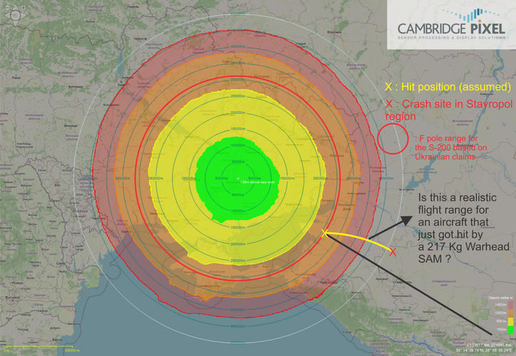

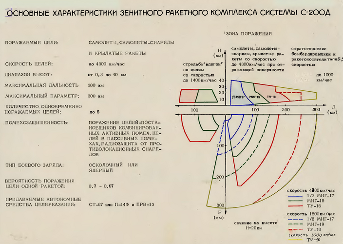

Even in the most ideal conditions the S200 still doesn't have the reach; and even if we bite, how are they suppose to guide the missile anyway? I get that they need to present more victories to their audience as as the situation gets more and more dire but this sort of crap just delegitimizes some of the Ukranian war effort and propaganda. The same applies to targeting civilian targets inside Russia, no matter how evil the enemy is.Probably an engine fire, IMO. The ZSU claims responsibility but given the speed of the aircraft and the position of the damage it is hard to imagine this was an S200 hit.
I'm not sure really. An S-200 hit is certainly a stretch given the question of how they guide it and also how they hide it, since it's 35ft long. There's the possibility that these Tu-22M3Ms had got too used to flying the exact same path and that was noted, as was the case with the F-117 in Serbia. That would somewhat mitigate some of the need for guidance. However still a stretch.Probably an engine fire, IMO. The ZSU claims responsibility but given the speed of the aircraft and the position of the damage it is hard to imagine this was an S200 hit.

? That's about 1.2km/sec. If your INS is so bad it's drifting that much over a 4min20sec flight, you need to take your INS designers out and shoot them.and who will provide correction to the INS drift ? It's still a long flight even with 4300 km speed of the 5V28 missile.
