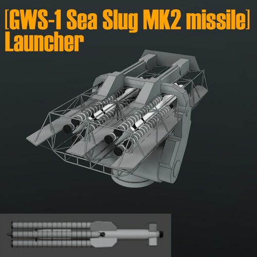

I have remembered correctly that the reactivation of Kent and modifying her to fire Seaslug Mk 2 missiles was seriously considered. https://www.littlewars.org.uk/Seaslug/kent.html

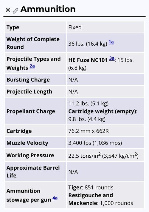

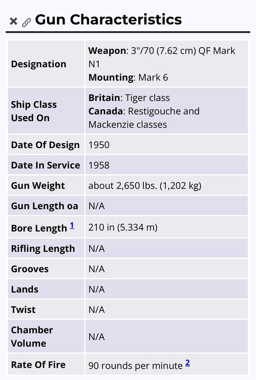

Yep, Wikipedia mentions that factoid.
According to: https://www.navalanalyses.com/2016/08/warships-of-past-tiger-class-cruisers.html

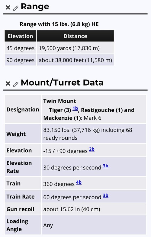

It also says . . .
The original plan retained the full three twin 3 inch mounts however, during the conversion of Blake the plan was changed to allow the cruisers to operate, four (4) of the more capable Westland Sea King carriers, although only three (3) Sea Kings could actually, ever be accommodated and serviced in the longer hangar which extended further into the main structure of the ship, and greater cost and forcing the replacement of the side 3-inch gun mounts (which fire arcs were now too restricted) with much less effective Seacat GWS22.

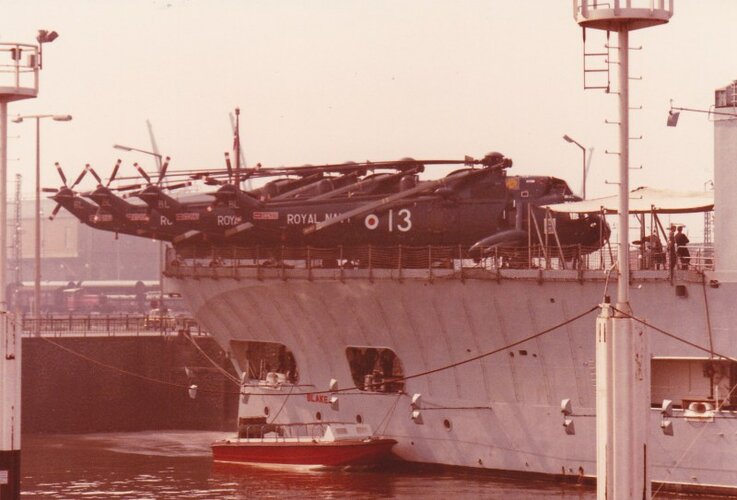

Unusual photo of Blake with all 4 Sea Kings out in the open on the flight deck.

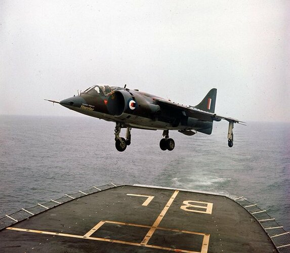

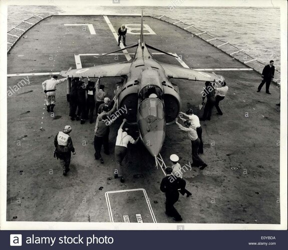

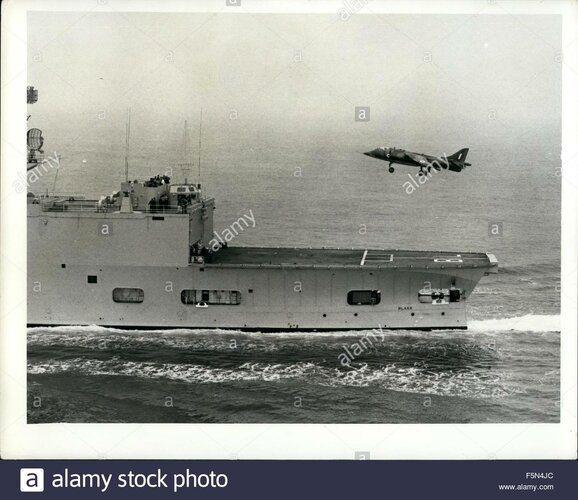

On 2 & 3 August 1969 Harrier GR.1 XV742 piloted by HS test pilot Hugh Merewether undertook a series of trials on Blake off the Isle of Wight. These were deemed successful in that they proved the ability of the Harrier to land and take off from the flight deck of Tiger & Blake.
A weird idea; what if Tiger-class cruiser would be refitted with the erectable ski-jump at the rear end of its flight deck? I.e. during landing operation, the ski-jump is lowered down and did not obstruct the approach. And during takeoff, it would be raised using hydraulic pistons.
Yeah, I understood that launching planes backward from the ship stern is not the best idea. But after all, it's Harrier, and it could handle such operation. And it would make possible for Tiger-class ships to launch Harriers with meaningful load.
See the photos above. Insufficient room for a run up to any ski-jump.
Hm. Purely theoretically - the flight deck of Tiger-class cruiser is about 40 meters. The HMS Invincible initial 6.5-degrees ski-jump was 28 meters long. So it seems that we could squeeze something like that on Tiger's flight deck.
But the Harriers / Sea Harriers were beginning their take off runs about 450ft back from the leading edge of the ski-jump to ensure that they had sufficient forward speed to remain airborne (c 90 knots plus benefit of wind over the deck). Without that run up they would simply have dropped into the sea. So vertical take off was the only option for Tiger & Blake.
Erm...
As far as I knew, the ski-jump was initially used to provide STO with bigger load, without much of takeoff run. The long takeoff run was implemented only after Falkland War, with the refit of Invincibles.
I may be mistaken here, of course.
Erm...
Your video seems to be of the trials on the experimental ramp at RAE Bedford sometime around 1977-1979. The aircraft looks like the HSA owned & funded demonstrator G-VTOL used for sales tours around the world. In particular note that it has no underwing or underfuselage weapons pylons / hardpoints. It only adopted an RAF serial ZA250 when carrying out weapons trials.
This was Farnborough in 1978. Same aircraft.
This on the other hand is video footage of early Sea Harrier operations on Invincible with aircraft carrying fuel tanks & weapons loads. It dates before the Falklands as the aircraft are in the original Grey / White camouflage & normal roundels (not the low viz ones adopted during and after the Falklands campaign).
There is even some footage of the Blake trials in 1969 and from the RFA tanker Green Rover.
View: https://www.youtube.com/watch?v=_MaVNkX4g1M
Okay, I stand corrected then.
A question. Do anyone have a good schematics of Seaslug missile launcher? I have some 3D project in mind, and this launcher is pretty complicated. Here is the best I could find:
IIUC a Harrier without a ski jump had on a ballistic trajectory about 3 seconds between leaving the deck and hitting the sea, but a 12 degree ski jump extended this ballistic trajectory to something like 12 seconds. IIUC when a Harrier leaves the deck the pilot bangs the nozzles from fully aft to down ~50% so the plane has 50% wing lift and 50% engine thrust lift, and then transitions to fully wing lift as it picks up speed. I don't know how long this process takes, but if it takes 10 seconds the value of the ski jump becomes obvious.
IIUC when taking off from something like a Tiger the ship travels into the wind at an angle, giving the Harrier a bit of WOD. So its not strictly VTO, its VTO +20kts WOD which isn't much but might be enough to enable weapons carriage or something when it otherwise couldn't happen.
Thanks! By the way, could Harrier use JATO?
Dunno, but IIUC the Harrier does have quite a high conventional takeoff and landing speed, 140+kts.
Given that the purpose of JATO is to get enough speed/wing lift to allow short takeoff runs I doubt that the Harrier needs it as it can use a mixture of wing and engine lift for short takeoff runs.
In the period Blake and Tiger were operating as Command Cruisers only RAF GR Harriers were available.
By the time Sea Harrier enters service Hermes can carry all those available with Bulwark still around to provide an option.
