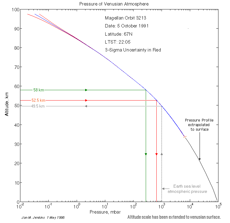

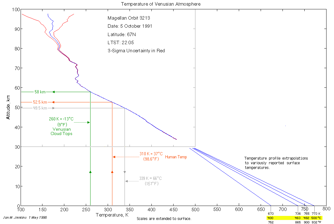

Don't forget that it also has a temperate atmosphere. It's the only place other than Earth where you can come across "room temperature" with "room pressure." You have access to all the carbon and oxygen you could want; hydrogen and sulfur with a bit of effort. Due to the Earthlike atmosphere above, radiation would be low.
Is Venus 'room temperature' at any altitude? And if you're that high up, are you getting any radiation protection, particularly sans magnetic field?
Yes.
If you're at ~53 km, you're about human body temperature, with an air pressure about 70% sea level. If you want more pressure, go lower. One atmosphere pressure is about 150 degrees F, which will require substantial active cooling... but not really that much of a challenge. These would put you in the upper cloud tops; a coating of teflon would be required, but it would make extracting water and sulfuric acid straightforward. Structures could be made from carbon extracted from the atmosphere; launch to orbit possible using rockets made from carbon, fueled with a combo of carbon, oxygen and hydrogen.
