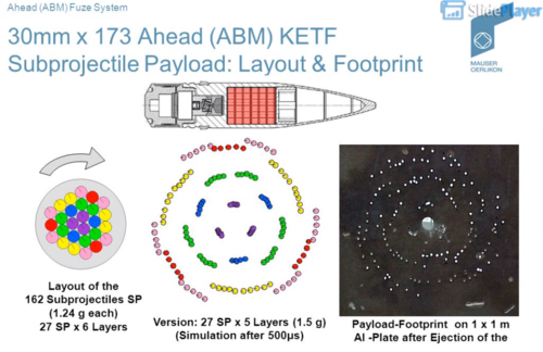

AHEAD is terminal defense truck in front of any imporant bunker in Asia. The bunker never is destoyed until the AHEAD is defeated. This is not to mention PLA portable lasers down missiles right in front of A-G targets. No air-ground missile survives until those systems are defeated.
35mm AHEAD on a C-17 what in world are we talking about. AHEAD is a fusing concept which could be added to long range gun and cued by offboard sensors. Calulating what... for what.

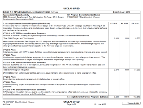

You have no idea where AF funding on any particular project really is. What, the internet, really.
I do, because of we have fiscal year budget request documents

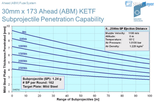

No, first of all, the purpose of SEAD/DEAD isn't to destroy bunker. You focus on long and medium range air defense first.
Second of all, AHEAD do not have 100% kill probably so even if it wasn't destroyed first, it is still possible to destroy the bunker, it is extremely unlikely that AHEAD can be used against hypersonic missiles anyway.
Thirdly, while the shotgun styles of AHEAD round give better coverage and increase hit probability, it also reduces penetration
Against most air target this isn't an issue but bunker buster has very thick steel case (GBU-57 has 7.6 cm thick shell) so your AHEAD round will do no damage to them.
The small BLU-116 has 5.7 cm steel casting and an outer aluminum casting so it AHEAD pellet won't penetrate them either. Given that even APFSDS round with high-density material and perfect L/D ratio still can't penetrate several times their length, AHEAD pellet will not penetrate the thick casting of bunker-buster bombs. So it is perfectly possible to destroy the bunker even when 35mm AHEAD defense is not deal with yet.
