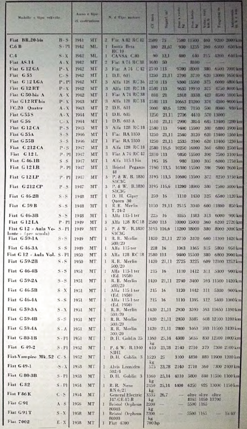

Ale
and here the last one
Ale
  • gabrielli part 4.pdf

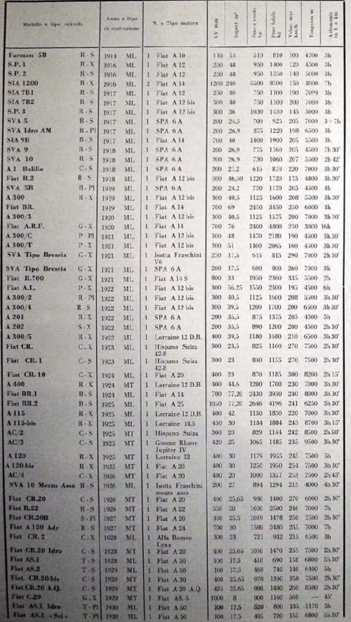

Very coool,thank you Alemilb,
and also can you help us in Breda list,we have many gaps in it.

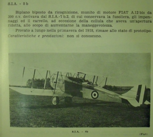

from Aerei Italiani 1914-1918,please add this, SIA-6b,also SIA-8b.
Done. Thanks hesham
BTW: Those two clippings translate something like this:
SIA 6b
An alternative designation for SIA-built SP.3 machines (by Savoia-Pomilio).
SIA 8b
Two-seater reconnaissance biplane, equipped with a 300 hp FIAT A.12bis engine. [SIA 8b was] derived from the SIA 7b.2, retaining the fuselage, empennage, and undercarriage. [The SIA 8b differed from the SIA 7b.2 in having a wing cellule with a reduced gap to improve its handling.
[The SIA 8b was] tested throughout the spring of 1918, but it remained a prototype.

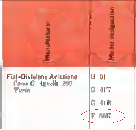

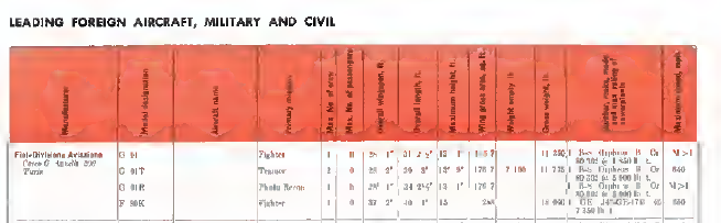

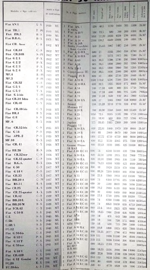

From AW 1960,
what was this,F.90K or G.90 Fighter ?.
As per as request by hesham ...

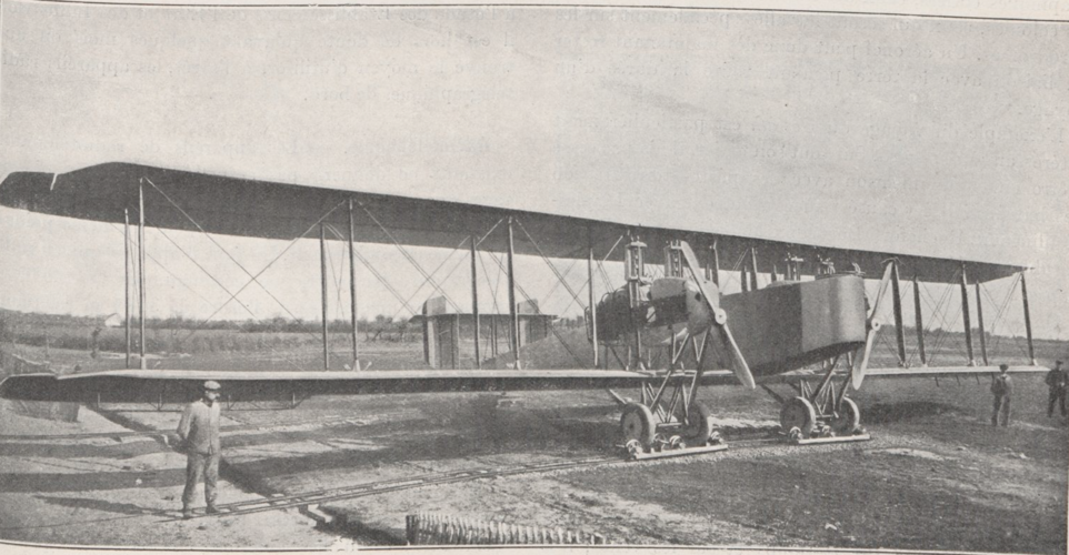

Hello Forum,
I've just discovered a photo of a 2-engined biplane in L'Aeronautique, Dec/ 1919, which is called a "S.I.A." Unfortunatly, I couln't find anything about the aircraft. Maybe somebody knowing the correct type.
Tipi di aerei costruiti dalla Fiat nei primi 50 anni di attivita industriale aeronautica.
Source: Alata, January 1959.
