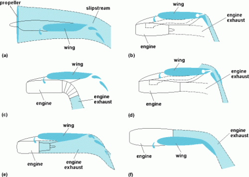

I found this:
http://accessscience.com/content/Short-takeoff-and-landing-(STOL)/621000
Pretty interesting primer on the subject.

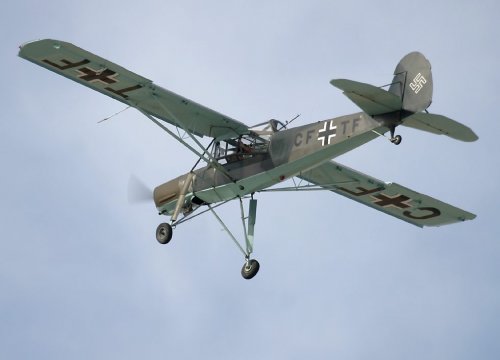

What would a Storch look like today? Turbine powered? Composite wings? It's such a great design already, how could it be improved?
Bronc

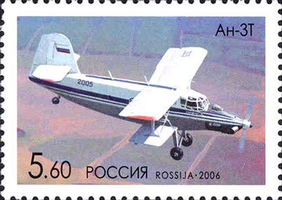

You want low cost so a single engine and a large cargo space to be useful. Probably something like a turbine An-2, the An-3:
You make the wing big, thick and cambered. That will reduce top speed but improve max lift. But you probably wanted a cheaper alternative to helicopters anyway.
Bronc

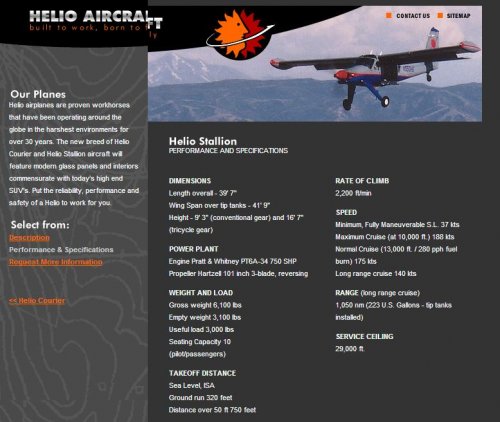

[font=verdana, geneva, arial, sans-serif]It might look like a Helio Stallion. [/font]
[font=verdana, geneva, arial, sans-serif]The Storch had great STOL performance, but it couldn't carry much and was slow. The Stallion can carry 10 people and has a useful load of 3000 lbs. It can clear the 50 ft. obstacle in a little over half the distance of the Turbo Porter and is significantly faster. [/font]
[font=verdana, geneva, arial, sans-serif]Modifying the Storch would be a huge development effort and would have a very hard time coming anywhere near the utility of the Helio Stallion. The original Helio company had larger twin PT-6 aircraft on the drawing board that would have flown like the Stallion with greater payload capability.[/font]

The Helio Stallion has a minimum fully maneuverable speed of 37 kts which compares favorably with most of the other STOL aircraft mentioned here.
Its big advantage over the slow flying competition is cruise speeds. The fastest Just Aircraft airplane has a cruise speed of 110 kts. The Helio Stallion has a max cruise of 188 kts, normal cruise of 175 kts, and long range cruise of 140 kts. When coming up with a "Best Possible STOL Aircraft", controlled slow flight is a given but the ability to cover distance and carry cargo has to be included in the mix. If you fly a 110 kt cruise airplane into a 10 kt headwind, your ground speed made good will be 100 kts or less. A distance that could be covered from sunrise to sunset in the Helio Stallion would take another day in a slower aircraft. Higher cruise speed means more ground covered while the sun shines and it can carry a lot more than most here.
