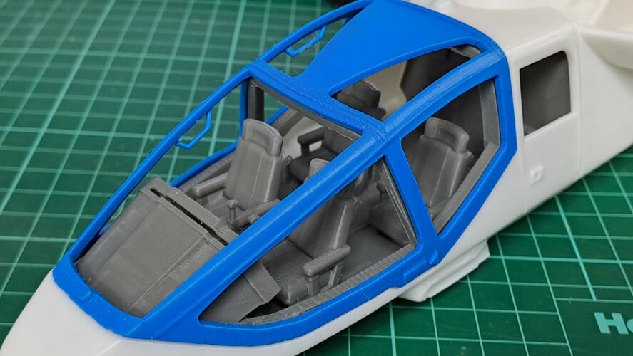

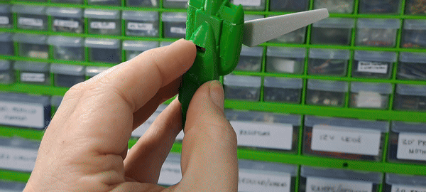

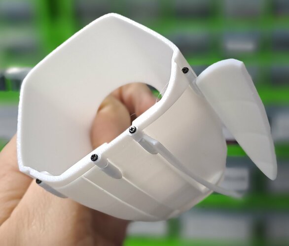

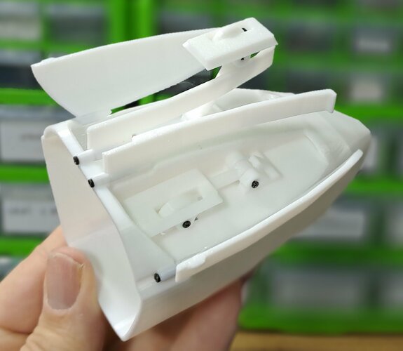

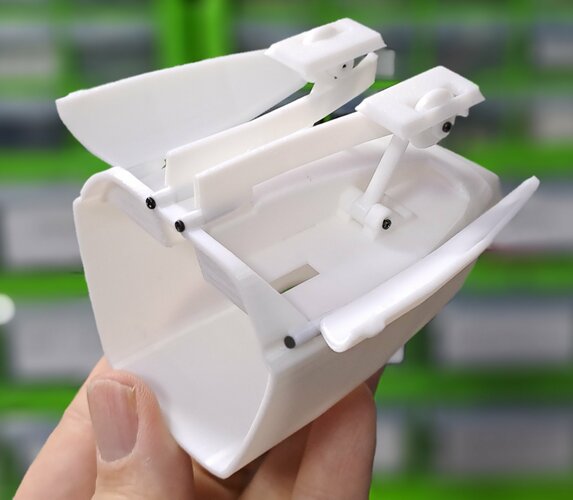

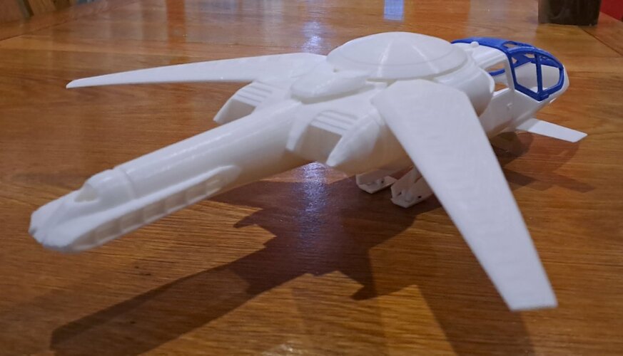

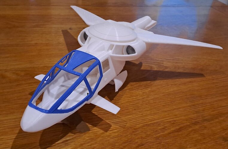

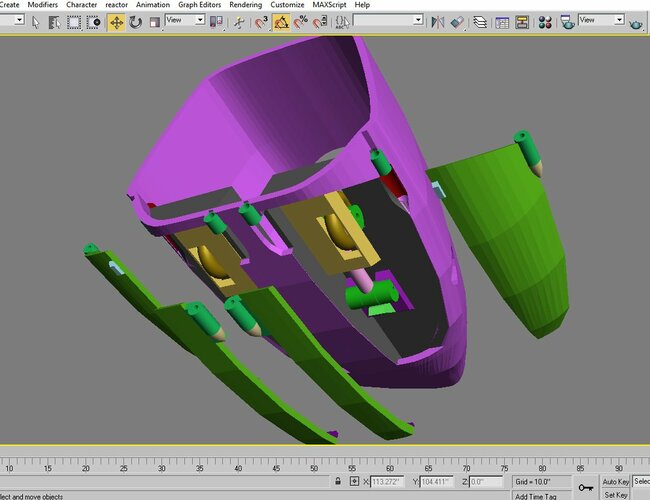

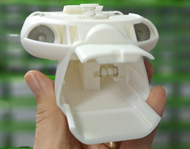

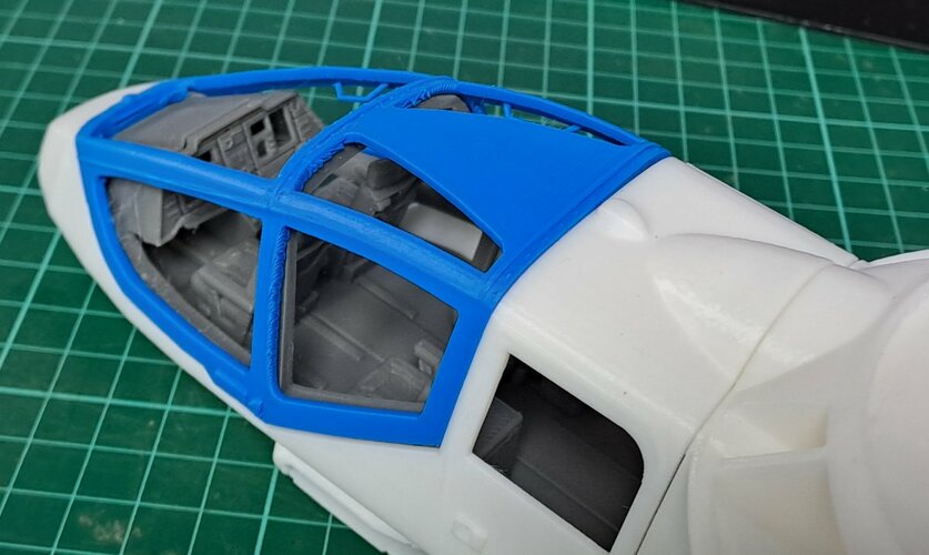

This mid section is now on it's 5th iteration! ... features spring loaded prop shaft ejector, separate turbine rotors (since they're very tricky to paint otherwise) and a mechanism that holds the top dome in place when in 'aeroflight' (as per Ron Cobb's design :D)

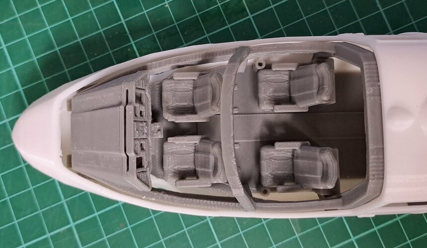

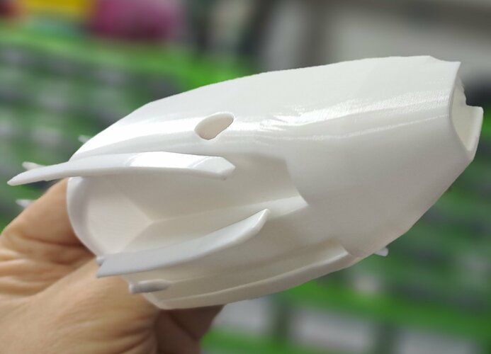

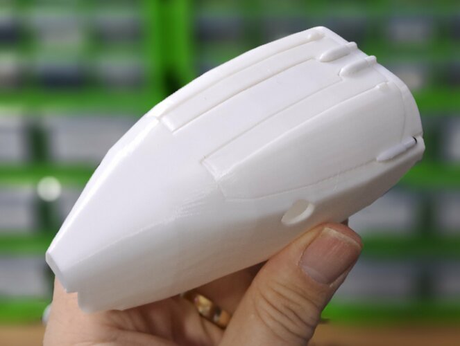

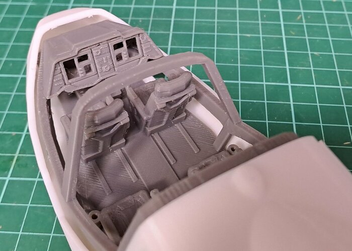

The layering is interesting... artifact or intentional?
There will be some layering due to the way the 3D printer forms the print; however, it can be reduced with a smaller layer depth.
Priming and fine sanding can eliminate the layers altogether.
So artifact then.
I've seen a few models where the artist took advantage of the layering to achieve visual effects.

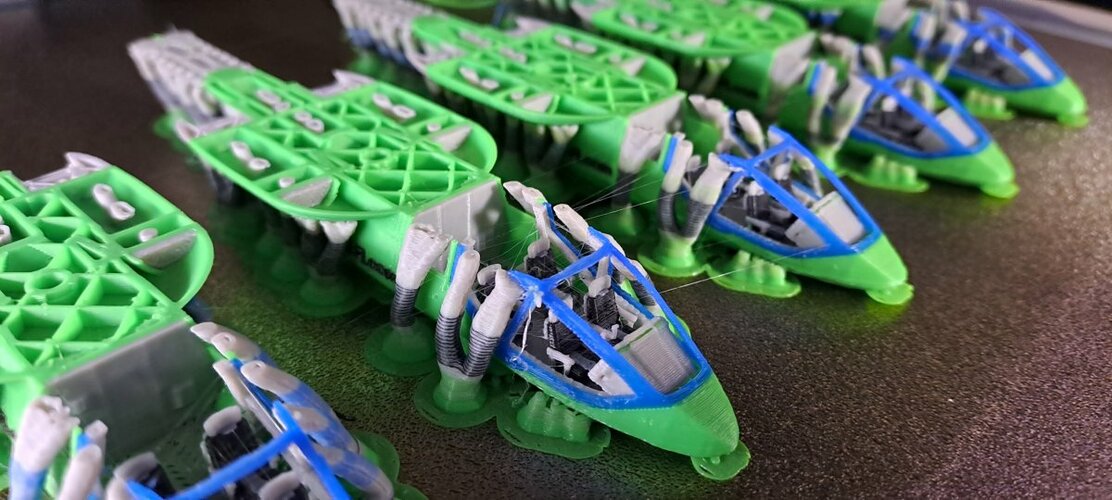

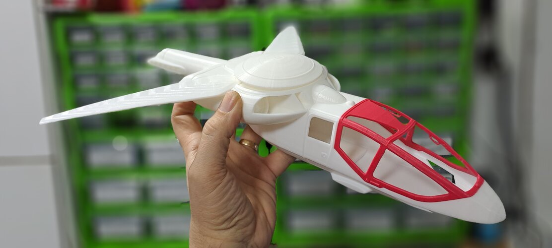

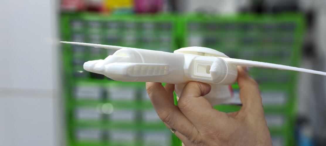

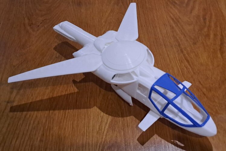

Another quick update:

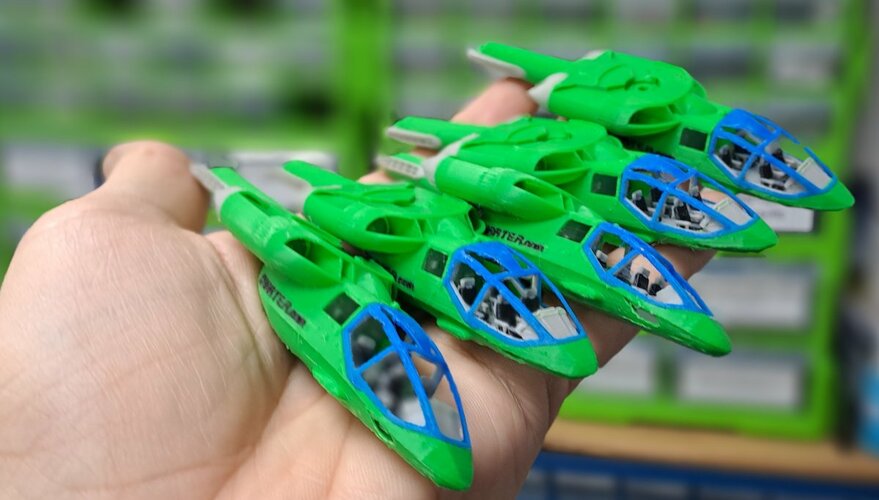

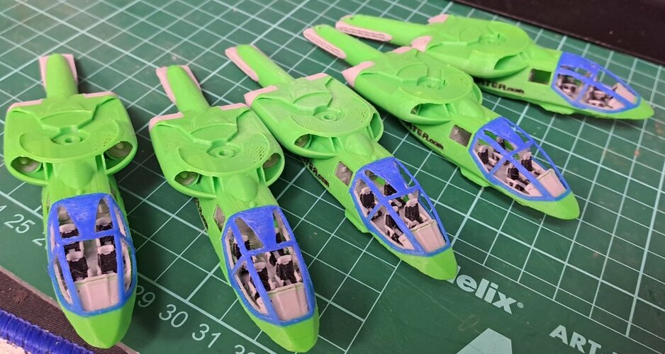

I recently purchased the Bambu AMS unit (4 colours) and had a go at making 5x Whispercraft with 'CHARTER.com' emblazoned on each side. Here are the initial results ...

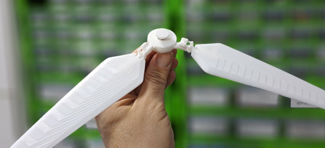

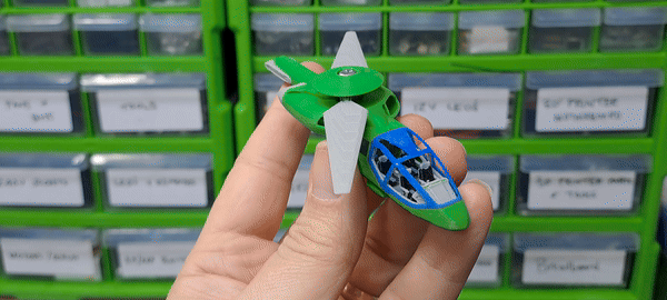

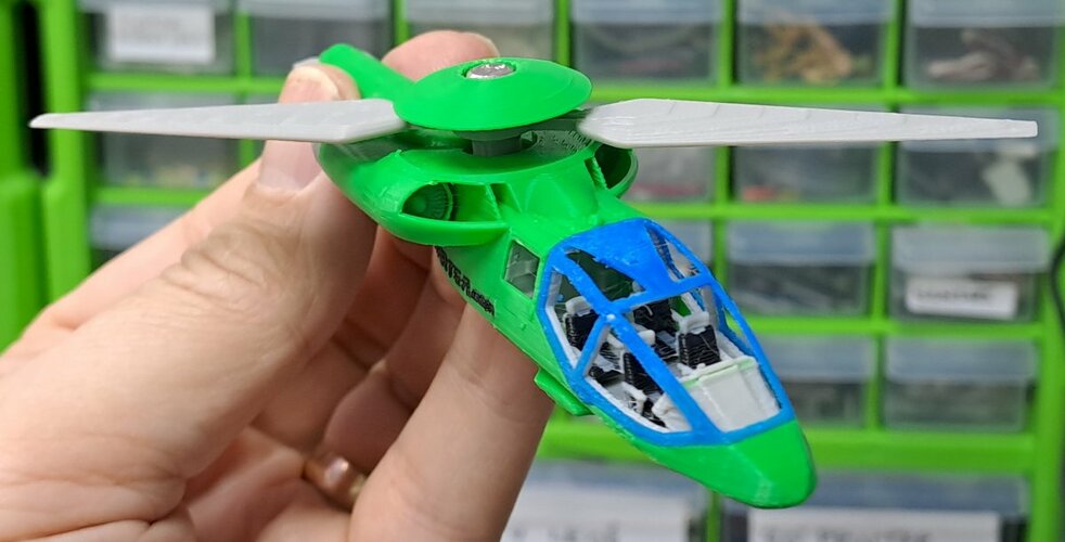

Free spinning rotors ...
What's the scale and commercial availability?
Hi Martin, I can sell at a 'hobby level' the printed design (with permission from the Ron Cobb estate) ... the scale can be made to order (1/100 up to 1/28 approximately). The main bulk of the design is nearly complete although I'm making the final touches to improve fittings, mechanisms, wiring etc..
