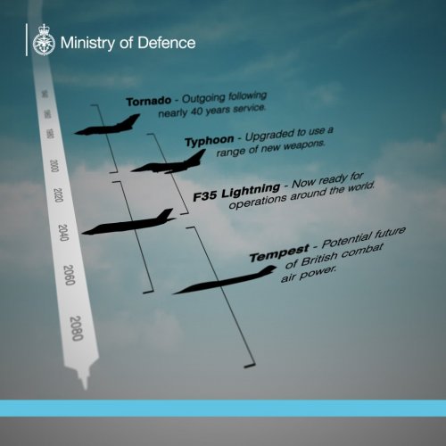

Tempest updates:
In IOC of F-35 press release:
https://www.gov.uk/government/news/defence-secretary-sets-sights-on-next-century-of-british-air-power
IOC stated as being hoped for in 2035, although related graphic shows it may slide right (see attached, although it also seems to indicate Typhoon in service since 1980s!)
Also, statement on full range of FCAS TI projects (and much else too - only 40 Typhoons with E-Scan, Canada pinching shipyard workers for Type 26 etc.):
http://data.parliament.uk/writtenevidence/committeeevidence.svc/evidencedocument/defence-committee/work-of-des/written/93913.html
"A nine-year funded programme of record exists for the FCAS TI, of which the Team Tempest project is a subset. This programme consists of three main elements; PYRAMID (an Open Mission Systems Initiative); National Projects; and International Projects. Team Tempest is a part of the National Projects element and is jointly funded by the MOD and industry. All other FCAS TI activities are currently solely funded by the MOD. The MOD is contributing c.£2 billion to the FCAS TI programme."
Note that it is not the case that £2 billion is being paid by MoD for a plane called Tempest.

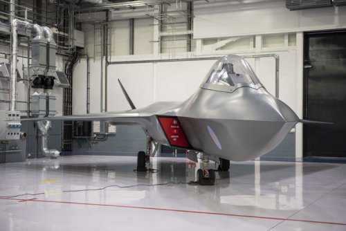

Another picture from today.
Emphasises just how low slung the model is.
For weapons loading presumably 'robots' is the answer! :eek:
Really short robots.... something else for them to inevitably hold against us...

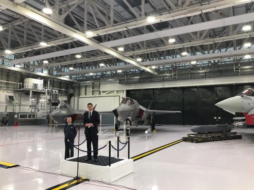

RAF. Marham, January 2019 ... http://www.joint-forces.com/uk-news/20790-new-facility-opened-at-raf-marham
Harrier said:
Tempest updates:
Is it just me or is that Tempest silhouette in fact Replica?
