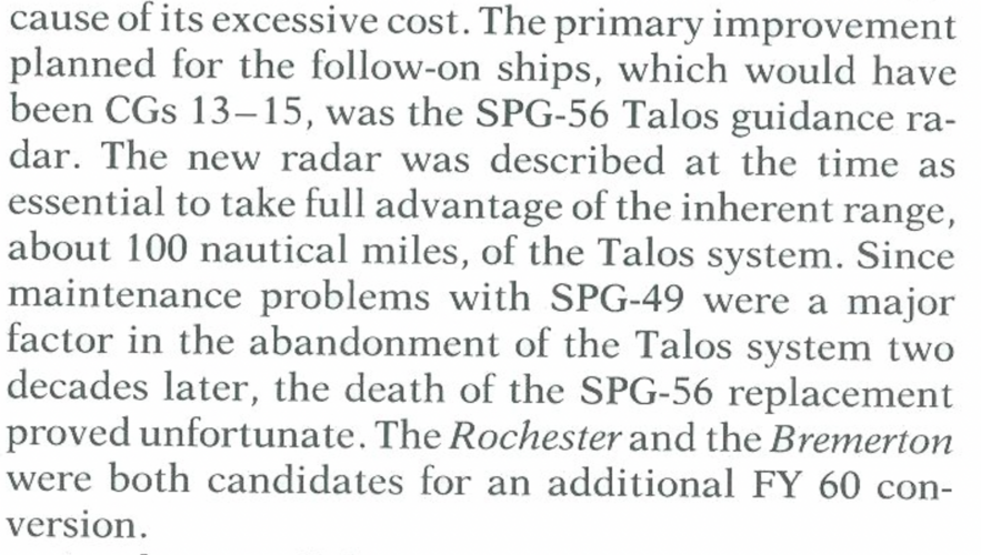

SPG-56 mentioned briefly in Friedman's U.S. Cruisers book: "The SPG-56 was described as essential to take full advantage of the Talos system 100nm range"

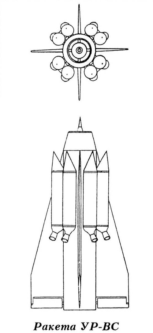

Well:
* Speaking of counter - it was X-22 missile, with 300+ km standoff range and Mach 3+ speed on 25 km altitude.
* Speaking of equivalent... I think that the only one Soviet naval SAM with comparable range was planned to be (development wasn't finished) the "UR-VS" system:
UR-VS means "Universalnaya Raketa - Verticalny Start" (rus. Universal Missile - Vertical Launch). It was supposed to serve as both anti-air and anti-surface missile with up to 200 km (less against aerial targets). Missiles were planned to be ramjet-powered, with vertical launch from individual launch containers. Project was developed in 1963-1966, but eventually cancelled on early stages.

There was also an attempt to develop a version of the AN/SPG-51 (Tartar / Standard 1MR guidance radar) for Talos, as AN/SPG-51T.
