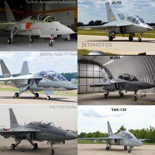

Comparative image of current Trainer/light fighter aircraft. Thx to Boz
x-png.53538

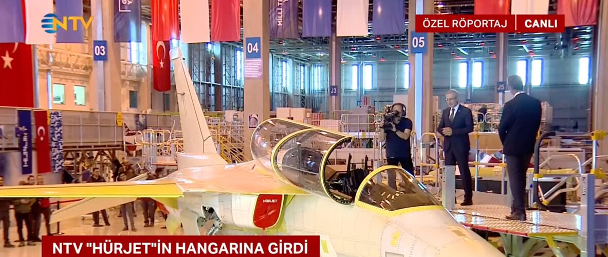

Notice that the best forward visibility for the instructor seems to be with the MesserchmHawk. Albeit debatable with that of the MessHurJet
(a play of words to distinguish those with a right opening canopy. (Bf 109 canopy was hinged that way)).

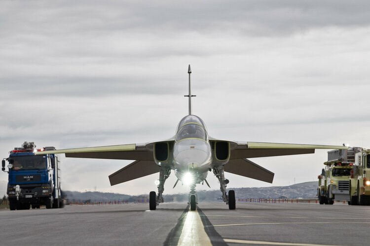

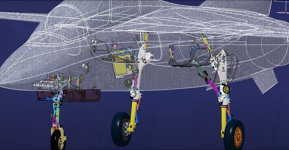

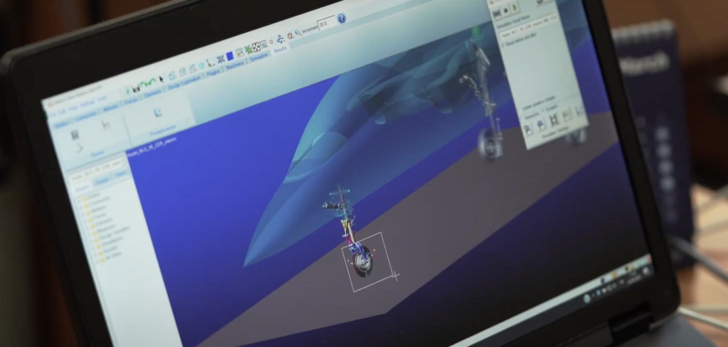

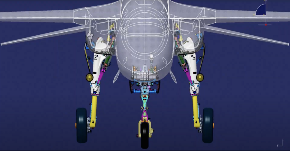

at first glance the Hurjet looks similar to the T-7
but one thing quite different are the landing gear configuration
the Hurjet goes straight down while the other two have an angle
Also, another noticeable thing is that the T-7 has canted twin vertical tails while the Hurjet has a single vertical tail. And my impression is that the lower lip of the T-7's engine air intake has a downward angle. Are both features designed with high AOA performance in mind?
If T-7 has all the aerodynamic attributes of a mini SHornet, USAF requirements didn't includes high AoA manoeuvring. As such, T-7 publicized max AoA is 26 degree (something significantly higher than the competition), what also ranges b/w a Mirage 2000 and a Su-27.
Testing for high AoA takes time and comes at a cost. Unless a customer is ready to pay for opening the flight domain, it's probable that those characteristics would remain so.

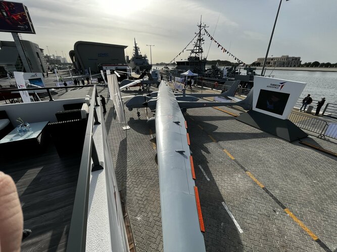

Turkish Aerospace Industries is present at the IDEX 2023 fair. T-129, Anka, Aksungur, Hürkuş and Hürjet platforms are being displayed at the static area. TAI did not bring the mock-up of the TF-X.
