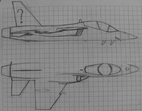

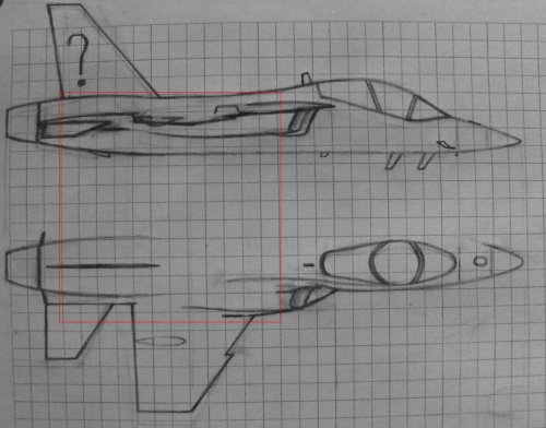

Added a couple of nips and tucks, including LERX fences as spotted by Sundog (h-stab & wing span slightly reduced, wing LE dog tooth).
Any opinions on whether the presence of LERX fences makes a twin tail more likely? Sure, the M-346 has them and is fitted with a single fin, but the original example of this aero band aid is the Hornet classic (to alleviate buffeting loads on the vertical tails from LERX vortex impingement, IIRC).
Definitely single vertical tail.

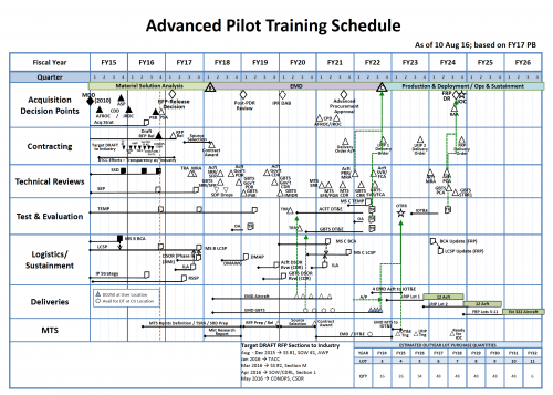

Isn't IOC 2023 or 24 & FOC 2034? That's 4 airframes a month - LRIP rates. Neither helps with the 'ready-now' argument

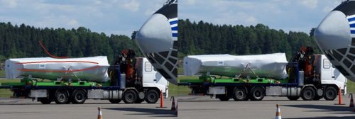

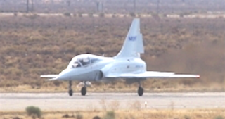

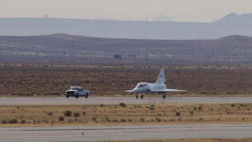

Northrop T-X Makes First Flight AWIN-Guy Noris
LOS ANGELES—Northrop Grumman’s contender for the U.S. Air Force’s T-X next-generation trainer competition made its first flight at Mojave, California, on Aug 24.
The aircraft, which was first seen publicly on Aug. 19 making high-speed taxi runs, is believed to have taken off at around 12:48 p.m. Pacific time and remained airborne for at least two hours. The aircraft, which was designed by Northrop’s Scaled Composites special projects company, underwent basic handling and systems tests during the flight, which was conducted in a series of racetrack patterns over the northern Mojave Desert.....
N400nt seems to be about t38 in size. a bit shorter, a bit larger tail, possibly a bit larger wings, but we don't know that yet.
t38 weighs just 3300 kg.
Where can n400nt save some weight?
It has shorter landing gear. It may use lighter materials and more weight efficient internal construction. It uses digital subystems, usually lighter than analogue ones.
But it also has powerplant section weighing some 450 kg more. Which needs more air and larger intakes. Which means more fuselage volume. And a stronger rear part construction, supporting that heavier engine and tail.
F-5b weighs 3800 kg, adding 500 kg of fairly basic equipment like rangefinger radar, some additional systems in cockpit and weapons carriage capacity, as well a sturdier construction to carry those weapons.
N400nt, like t38, doesn't need strengthened construction for weapons. But NG may have added some leeway there for future requirements.
All in all, i'd expect N400nt to weigh around 4 tons empty. Perhaps up to 4,5 tons if weapons carriage was planned into design but certainly not over.

Final minor revisions, pending any new clues. I had the intakes wrong in plan view.
EDIT: Marked what would be the Saab-built section that we saw wrapped in a tarpaulin for shipping a couple of weeks ago.

Update: Earlier this month the USAF updated/revised the RFP and made some changes to the Total Estimated Price adjustments for the various capabilities where objective performance (or better) will get a defined, downwards revision of the TEP for those that demonstrate it.
For the GBTS Connectivity the new VATEP is $67 Million, compared to an earlier (July,2016) specified $13 Million, and for Aerial Refueling Subsystem Full Integration it is now $13 Million, compared to the earlier $20 Million.
Additionally, they have provided an updated timeline and production schedule. Peak Production is now expected to be 48 aircraft per year.
GBTS specs have also been released:
https://www.scribd.com/document/322373908/Ground-Based-Training-System
