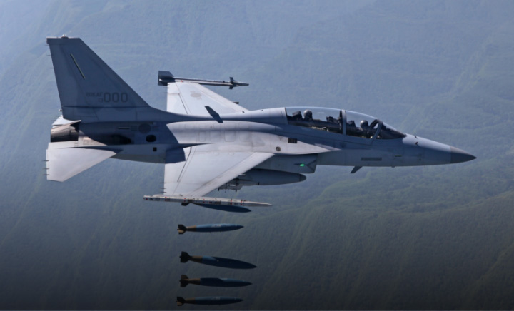

KAI is ramping up production of the FA-50, and the company told investors that it sees a chance that the USAF would buy its trainers, at least as a stopgap, due to the T-7 delays.

Meanwhile, the FA-50 is right on track, it's a pity the USA didn't choose this aircraft for the Air force next generation trainer.
If the chairforce had chosen the FA-50 they'd have stuffed the exact same ejection seat into it, and experienced exactly the same problems they're having right now.....
Except that
1. The T-7A’s issues are not just limited to the ejection system
2. The issues with the T-7A’s ejection system are not just related to the ACES 5 ejection seat but are connected to Boeing’s choice of a Canopy Destruct design over the Canopy Jettison design of the T-50A
If one reads the above articles on the GAO report it seems clear that the USAF selecting ACES 5 is minor aspect of Boeing’s failures for the T-X program.
LM/KAI had their chance and lost to Boeing. No point playing "the grass is greener" style what if scenarios.
There is nothing wrong with the T-7A it is the ejection seat, if LM/KAI had won instead of Boeing they would have had the exactly the same issue that Boeing are now having.
